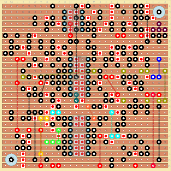

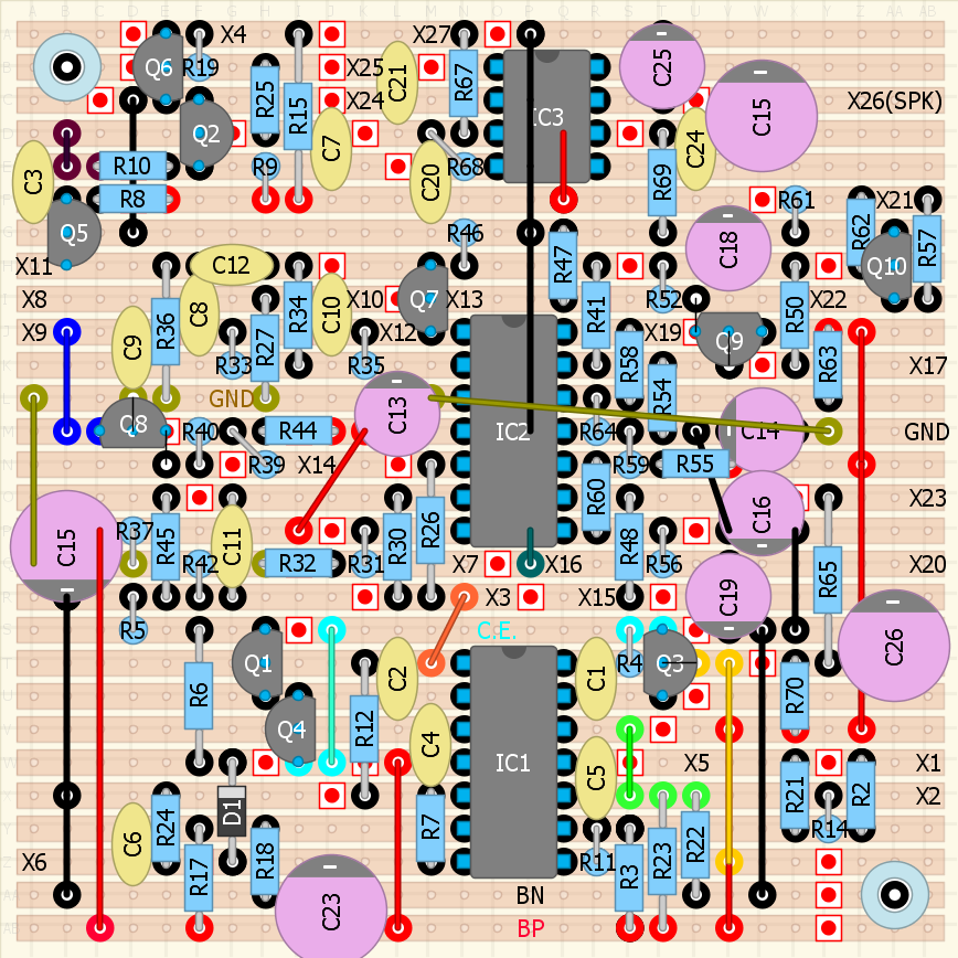

PostPosted: Fri Mar 22, 2013 4:17 am    Post subject: noise toaster stripboard Reply with quote  Mark this post and the followings unread

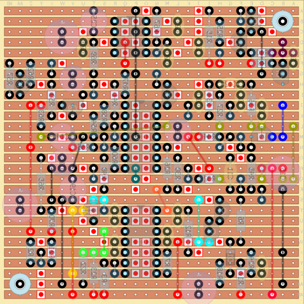

WARNING! All layouts in this thread contain errors and mistakes and neither of them is final. Once I build the unit I will be able to make a correct layout, but until then if you wish to build this keep an eye open for mistakes and check everything. Thanks:)
Ok, so this is what I came up with. I know that it's insanely crowded and it'll be a pain to build it, but I need to fit it in a box I have. It's area (2,9 x 2,9 inch ~ 7,3 x 7,3 cm) is like the half of Ray's PCB, so I'm a bit worried about crosstalk but I hope it's gonna be all right.
I'm also sorry about the crazy jumpering, but I couldn't find a better way to connect C13 and C14 (virtual ground) and also I think sockets (or plain IC-s) have the space under them for wires (for BN bus and X16 connection). Also if you can't connect two jumper wires into the same hole you may have to find a solution yourself, sorry about that.
Also note the legs of Q3, Q8 and Q9 - they are bent a bit.
I checked it a few times but of course there might be mistakes (it's very likely).
I created it using diy layout creator (http://diylc.org/) and I'm attaching the layout file too, so you can redesign, change or correct it if it's necessary.
I'm still waiting for components, so I can't verify that it's working (probably till the middle of April), but if you have the courage, try and build it:)
And of course if anyone spots any mistake, or has any comments, please say it. It's my first stripboard desing, so I know it could be done better (like less crowded Smile)
cheers!
ben
edit, ps: In Ray's PCB the big electrolytic caps have 0,2" lead spacing, but mine are all 0,1", so I designed for them. Also note that legs of C14, C19 and C25 are not in adjacent lugs.

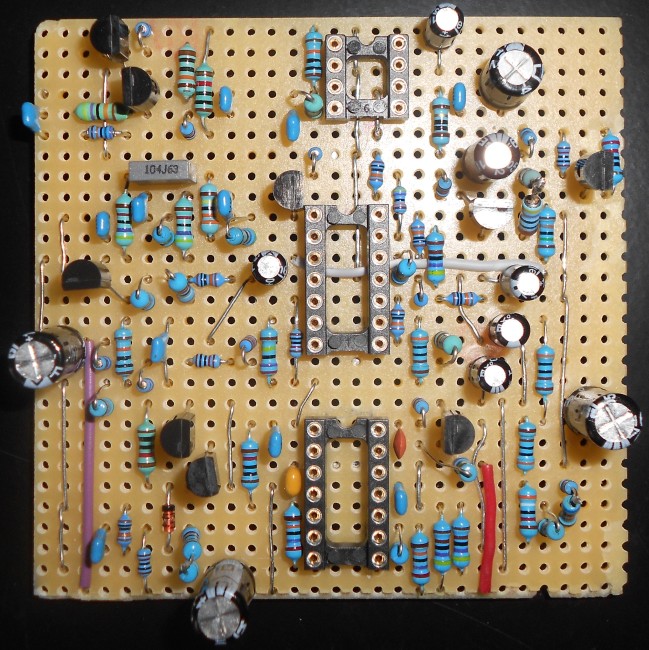

PostPosted: Mon Apr 15, 2013 4:50 am    Post subject: Reply with quote  Mark this post and the followings unread
I've finished soldering in the jumpers, resistors and IC sockets and I spotted a few errors. Firstly, I forgot to put R16 on the stripboard layout (its between Q3 collector and BP). Luckily there's space for it (there's a hole between Q3-C and C1, and just under that stripe there's BP), but it has to stand. The other mistake is that C21 is a non-polarized electrolytic cap but I drew it as a ceramic.
Anyway the resistors fit in nicely, though a few has to stand. But you can use 1/8W resistors (except maybe for the ones <1k) and then it's less crowded.

PostPosted: Tue Apr 16, 2013 7:02 pm    Post subject: Re: noise toaster stripboard Reply with quote  Mark this post and the followings unread
;Mr. Bence... in your stripboard post you said
bence wrote:
edit, ps: In Ray's PCB the big electrolytic caps have 0,2" lead spacing, but mine are all 0,1", so I designed for them. Also note that legs of C14, C19 and C29 are not in adjacent lugs.
I have looked at your SB layout multiple times and for the life of me can't see C29. Am I C29 blind or did you mean something else? Hoping for the latter.......
<marv>

PostPosted: Wed Apr 17, 2013 6:45 am    Post subject: Re: noise toaster stripboard Reply with quote  Mark this post and the followings unread
<marv>
Looking at the MFOS schematics and BOM, the capacitors only go up to 26, so I think C29 should say C26. Even if you add Ray's 2 additional external inputs, that only adds one 0.1uF capacitor. I can't find C17 on the stripboard layout, but that's possibly because it can be wired directly across S7.
Gary
EDIT
Just looked at the panel wiring diagram and C17 is indeed wired across S7!

PostPosted: Wed Apr 17, 2013 2:17 pm    Post subject: Reply with quote  Mark this post and the followings unread
Sorry guys, I meant C25 instead of C29. C26's legs are in adjacent lugs.

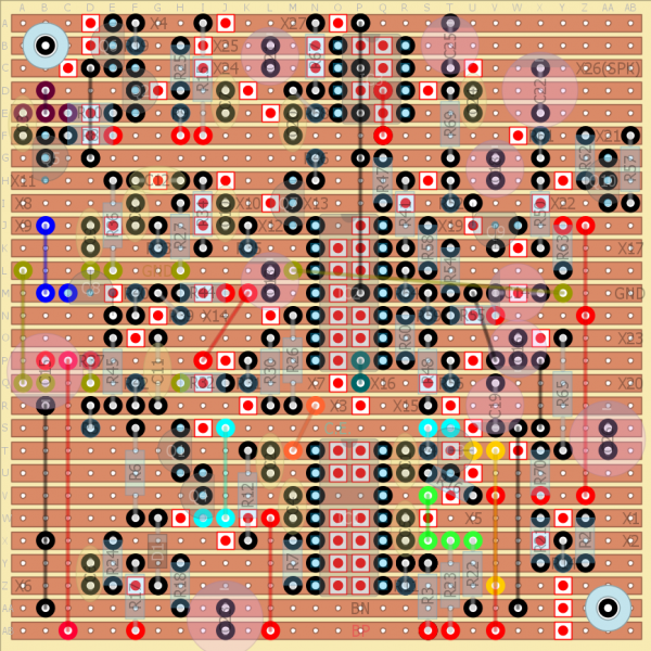

PostPosted: Thu Apr 18, 2013 8:27 am    Post subject: Reply with quote  Mark this post and the followings unread
Yeah Marv, you are totally right, I should've made a picture that way, too. Anyway, here it is.
And no problem at all, I mainly do this for myself, just thought I could share it.
Though consider the fact that's it not finished nor tested yet, so I can't tell if this layout works or not. Or even if it does and everything is connected to the right place, there might be crosstalk and other unwanted effects. So for the best results get Ray's PCB:)

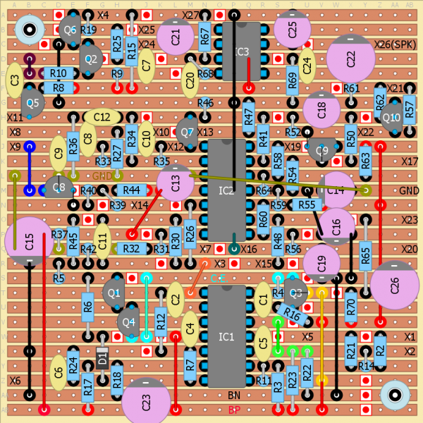

PostPosted: Tue Apr 23, 2013 7:59 pm    Post subject: Reply with quote  Mark this post and the followings unread
I'm new to this, so this may be a stupid observation. But, I've been trying to troubleshoot a breadboard layout of just the expo converter and the VCO, when I came across this post. I've been looking at your layout and noticed a few things
Pin 3 of IC1 doesn't seem to connect to the virtual ground.
Pin 11 of IC 1 doesn't seem to be connected to BN.
These observations may be a result of my own ignorance, so if I'm confused, please let me know.
bence
Joined: Jan 12, 2013
Posts: 17
Location: Budapest, Hungary
PostPosted: Wed Apr 24, 2013 12:37 am    Post subject: Reply with quote  Mark this post and the followings unread
Hello and thanks for the feedback:)
IC1 pin3 is connected to pin12, and therefore virtual ground, because the strip there under the IC is not broken (check it on the last pic).
However you are right about pin11, I did mess that up (and there's no space for correcting it nicely) Sad
I reorganized that part of the layout a few times and I must have forgot to place that link again..
Thanks for noticing it, I wonder how many other serious mistakes are still there. And sorry for the low quality :/

I totally ignored the pic showing the broken links under the chips. Glad I at least provided some useful input! I still can't get my breadboarded expo converter and VCO to work...

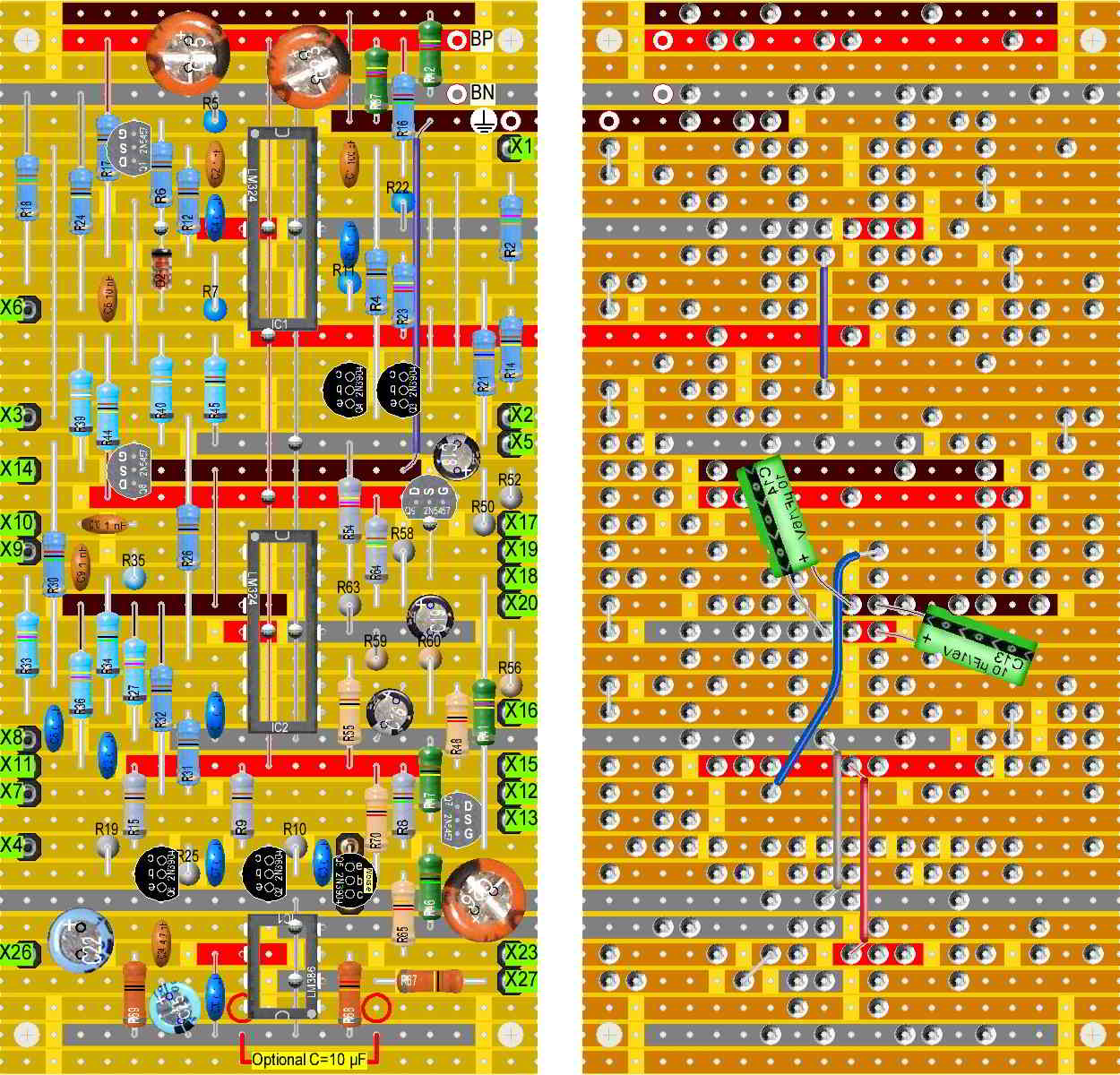

Nardu
Joined: Feb 28, 2011
Posts: 62
Location: Braila, Romania
PostPosted: Thu Apr 25, 2013 12:41 pm    Post subject: MFOS Noise Toaster stripboard in Lochmaster Reply with quote  Mark this post and the followings unread
- Here is the stripboard layout in Lochmaster using a H25SR050 stripboard (2x4 inch) - http://www.tme.eu/html/EN/h25sr-boards/ramka_2359_EN_pelny.html
- Still working. Mising: Q10,R57,R61,R62,X21,X22. If I fail, I will use a H25SR075 stripboard.

PostPosted: Mon May 20, 2013 2:22 pm    Post subject: Reply with quote  Mark this post and the followings unread
Hi all!
Nardu that's a nice and tidy layout, not like mine:D
I finally managed to finish this. There's one serious mistake in my layout: I haven't connected the top (6th row) and bottom BP bus.. I found this out after assembly, so I solved it with a wire on the soldering side, which is not nice. Otherwise it's working and making beautiful sounds, with a low crosstalk from the lfo, but that could be because of the panel wiring or the power distribution, too. I noticed that even when powering it from a regulated supply the controls interact with each other in a bad way (like turning up the volume or hitting a harmonics with the filter drops BP voltage hence vco freq and stuff like this:)). But I remember Ray mentioned the lo-fi-ness of this unit, so this was no big surprise and I love the thing anyway:)
I added a dc input and an attenuated earphone out (drived by the 386).
I also added an external CV input and a pot for the VCO, an input for the VCF and a gate input (I plan to build a simple 8step seq).
I don't know if I will make a proper layout later, maybe if I have time..
but the price difference is probably not worth the trouble, so buying Ray's PCB is a good idea...and then you still have to populate, wire and make a case, so plenty of DIY left:D
anyway...pics of my toaster:
http://imgur.com/a/xfdnZ
(still missing 4 screws for the speaker /now hold by superglue:D/ and labels for the controls)
it's a bit crowded in the inside (the speaker magnet is pushing the stripboard:/), if I could do this again I would drill a few holes a bit differently:)
another thing I noticed is the asymmetrical behaviour of the ARG-VCA: a long attack and a short release is much more powerful than a short attack and a long release, the latter is barely a not-so-loud pop. it could be the design, or a mistake in my build? a scope would be handy now:)
also, the VCA seems to offset the dc: when I connected it to a stereo the speakers moved in and out (a lot...looked cool but also a bit scary) according to the VCA's volume...it's like the decoupling cap does not work (or the change is not slow enough for the cap to block? sorry for the rambling)

bence wrote:
Varoudis wrote:
btw! Anyone tested the stripboard versions in this page?!?!
Hi!
Yes I built my toaster based on this layout. However as I said in the opening post there are mistakes in my layout which I discovered while building and testing the unit. But if you read this topic, you will know of all the mistakes and so you can correct them. (the worst mistake I made is a missing link in the BP bus that I already mentioned)
Hi, thanks for the reply.
By skimming through the topic I left with the impression that your were 'working on the board but not yet completed' so I ask in order to get an upodated/complete view. (Sorry, maybe it was because Im not a native in Eng)
I have ordered the PCB but Ill try to play with the stripborad untill I get it in the mail.
Thanks
bence
Posts: 17
PostPosted: Mon Mar 10, 2014 7:37 am    Post subject: Reply with quote  Mark this post and the followings unread
Well I finished a toaster based on that layout, but since the layout has a few errors I had to fix them when troubleshooting the finished unit. Anyway I wrote all the fixes here, so you should be able to build this based on the info in this topic.
When I was building this I was thinking about making a proper, bug-free, less crowded layout, but I never did:)
Instead I made a 8-step sequencer for the toaster.
Check out how it sounds (it sounds ugly:D)

PostPosted: Sat Oct 13, 2018 6:53 am    Post subject: Re: MFOS Noise Toaster stripboard in Lochmaster Reply with quote  Mark this post and the followings unread
Hi Nardu
After this time I am not sure if you can recall but your design looks good and I'm wondering whether you implemented with those missing items, or alternatively what your solution was?
Thanks in advance!
