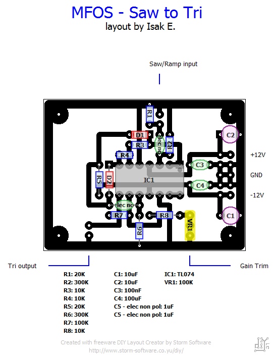

Hi guys.
this one is not verified, but needs to work.
please let me/us know thats its working ok.
NOTES:
should work from +12/-12 to +15/-15
D1 and D2 are 1N914 or 1N4148
enjoy,
Isak.
 Filesize:  20.46 KB
 Viewed:  412 Time(s)
