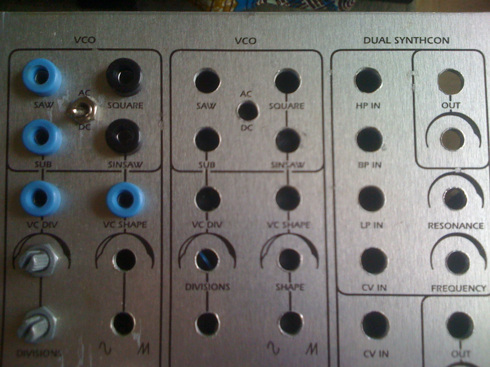

Hi all.
finally the chance to build first modular - ken stone to boot Cool
we have just got hold of a set of modular boards, components, top panels and enclosures for a cgs/serge modular Very Happy
95% assembled but untested boards (£470+):
CGS19 - Chime Simulator x1
CGS29 - Wave Multiplier x2
CGS35 - Steiner Filter x2
CGS48 - VCO x2
CGS01 - Suboctave x1
CGS67 - Active RM x2
CGS65 - Tube VCA x2
CGS03 - Psycho LFO x1
CGS27 - Tube Experimenter
CGS38 - SAW pitch shifter
CGS74 power board x2
CGS75 vcs x2
CGS64 VCA x2
Elby PSU
Unassembled boards + components (£145+)
3x Thomas White LPG (£45)
1 Tellun Neursal Agonizer PCB (£100)
Hardware (£300+):
2x 4u 3" deep aluminuium BUD enclosures (50£)
International Power Linear +12V/+15V PSU (80£)
100+ Banajack sockets (30£)
100+ Alpha pots £50
Range of toggle switches (£50)
6mm 4u Aluminium faceplates
A selection of vactrols (£40)
Old oscilloscope
And lots of other bits and pieces, solder etc.
for 290gbp!! Shocked

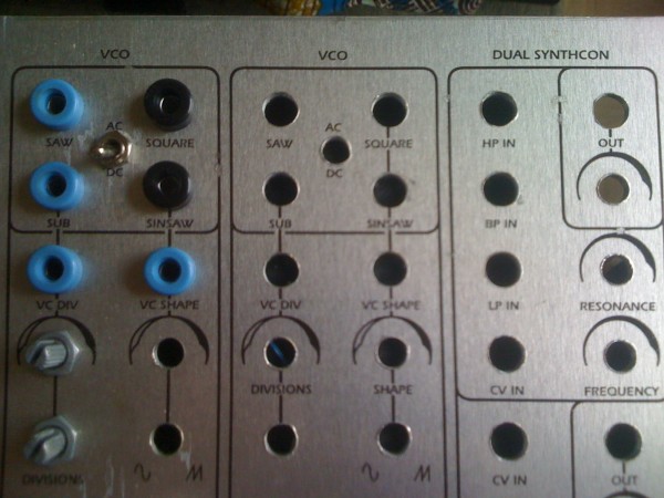

one panel has already been lazer transferred (see pic) - does anyone know if there are templates available for the modules or for the shapes and font used in this type of panel design, or do i resort to front panel express?
any help much appreciated - very exciting!!!!

Nice work!
I'm not aware of any, but if you find some please let us know....

ditto here too. I've been wanting to collect the graphics and fonts for Serge style modulars. It's one of my favorites.

The font looks like it may be ITC Eras, perhaps in a demi bold. It has that 3 degree tilt to the right and the R and W certainly indicate it is Eras.

lots of Serge panel art here -
http://www.serge.synth.net/modules/index.html
