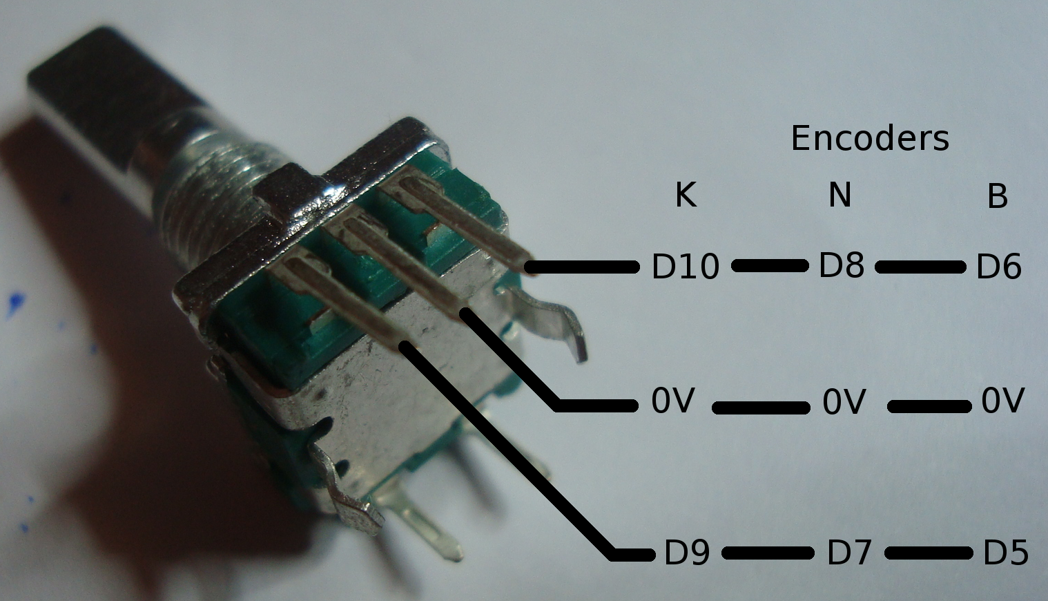

I'm not sure about the pin out of the encoder to wiring them ?
I Bought the stuff on the e-bay link shown at the top of this topic, it's low cost, but no explainations, no paper, no datasheet ...
And on the encoder the ABC are not show. ....
I search but there is different pinout possible ...
Is anyone know the good way ? Smile

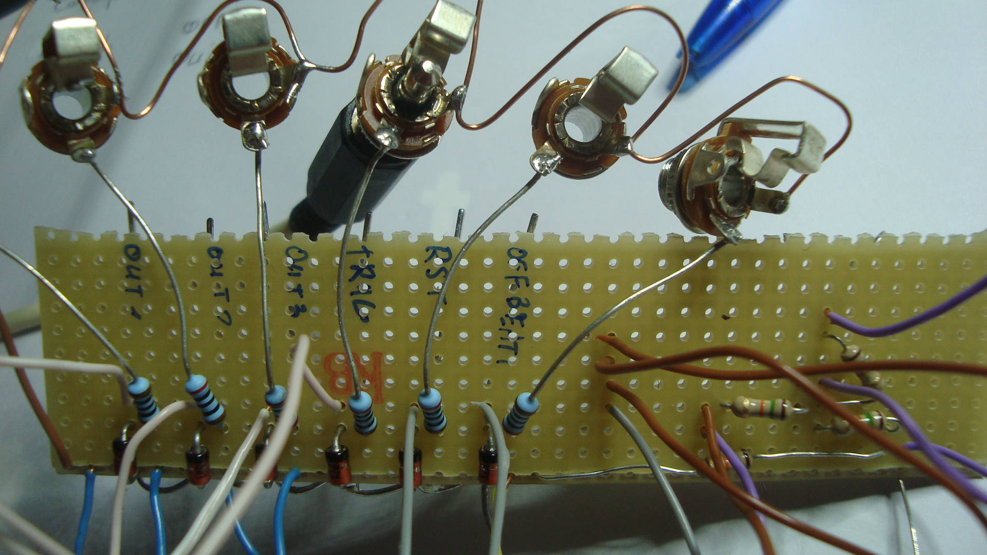

PostPosted: Sat May 02, 2015 7:33 am    Post subject: Reply with quote  Mark this post and the followings unread
Please post a picture of your board and encoders.
The side with 2 pins is the switch.
On the side with the 3 pins, the middle pin is usually the common (C).
The other 2 are A and B. If it doesn't work one way, then reverse those 2 wires.
Sneak-Thief - raw electrofunk

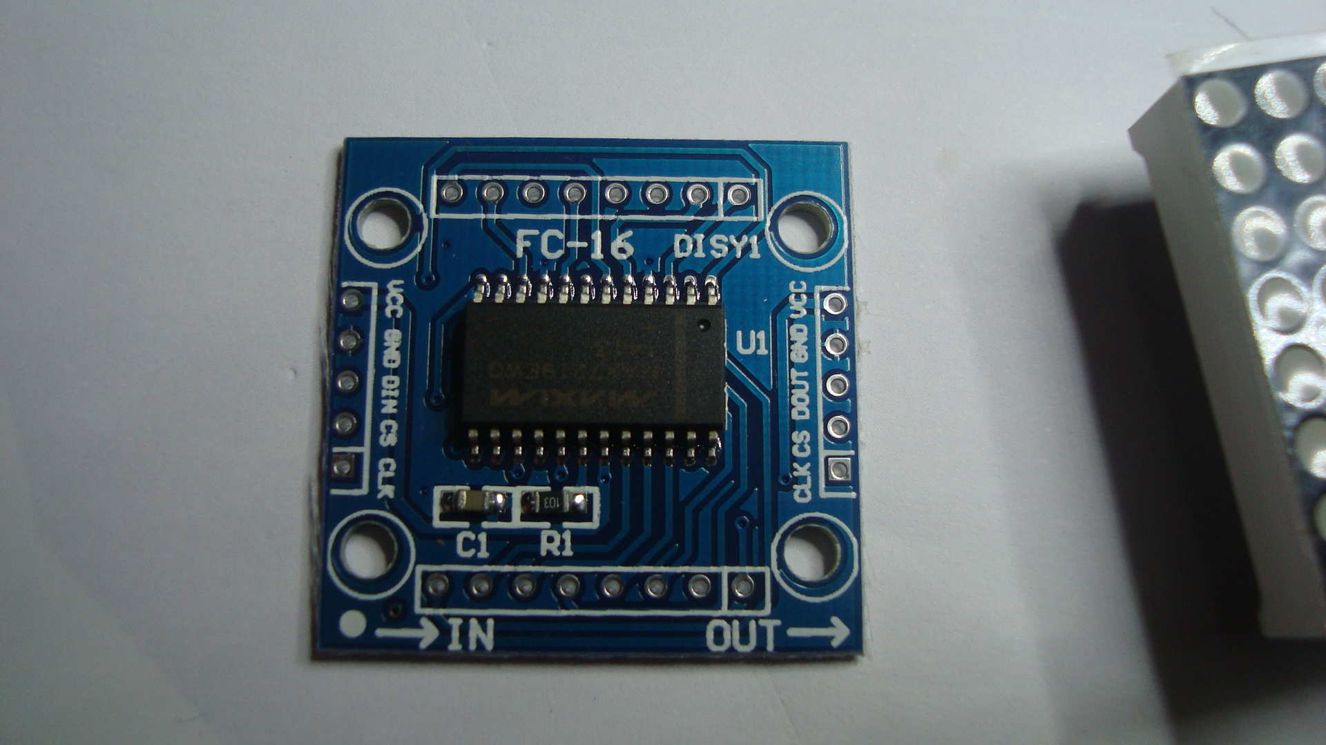

But There is another problem, because the matrix still showthe same "picture" and don't move ...
Here is my picture.

Your display is showing a problem! Somehow I think it's connected wrong.

PostPosted: Sat May 02, 2015 1:21 pm    Post subject: Reply with quote  Mark this post and the followings unread
I see you have an Uno.
The original program is for an Arduino Nano, so maybe there are some pins that are different.
All I know is that when the display shows that pattern, it means that the data it's receiving is scrambled,

dub halley: Can you try to CAREFULLY unplug the LED matrix from the PCB and rotate it 180 degrees?
Does the display show anything different?

PostPosted: Mon May 04, 2015 12:51 pm    Post subject: Reply with quote  Mark this post and the followings unread
ok,I did that and ... "black screen" so it was on the good way.

Encoders
The picture encoder.png show how I have solder the wires.
Because if you buy the ebay stuff, there is no sign on it to know which is the ABC.
And the for the two others you can't do mistake.

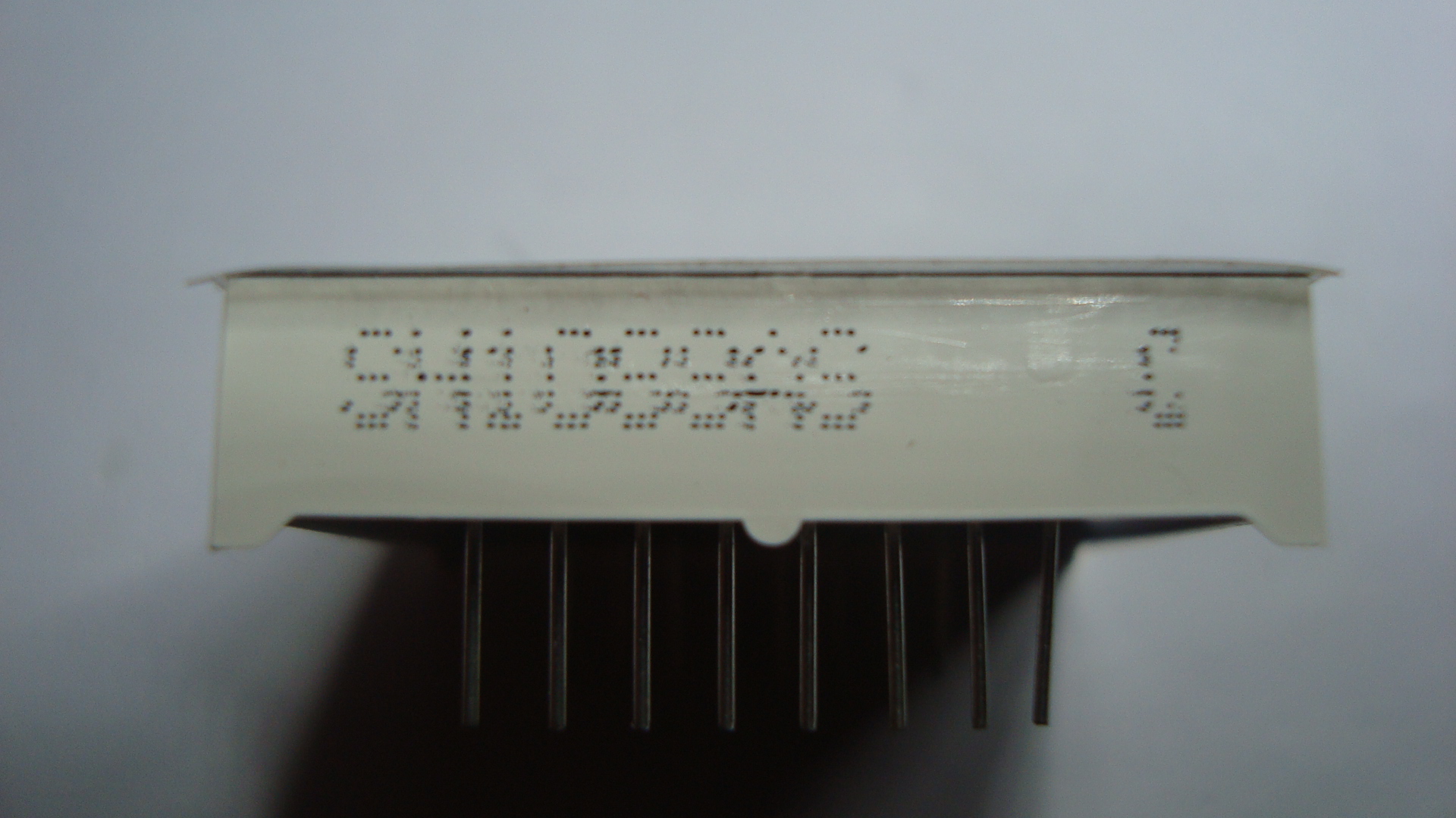

Matrix
As well there is no "good" mark to know the good way to plug it.
I put this reference next to FC-16 DISY1. At the opposite of IN / OUT

I don't think a pcb is indispensable.
It was just to test, I'll correctly wire this stuff to put on a module. Very Happy
