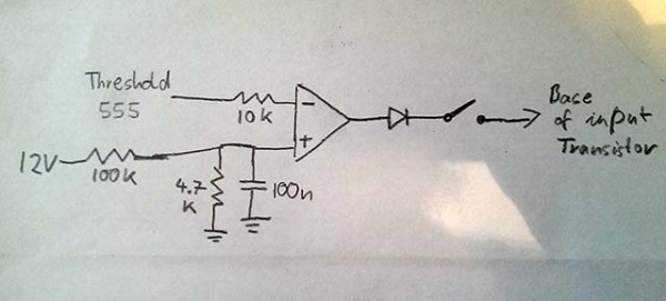

PostPosted: Mon May 04, 2015 2:03 pm    Post subject: Reply with quote  Mark this post and the followings unread
I just put together a dual unit with a 556 and a tl72.
Works nicely.
Is there any easy way to make this loopable?
That would be awesome.
PostPosted: Mon May 04, 2015 2:27 pm    Post subject: Reply with quote  Mark this post and the followings unread
I would expect that to be doable with a comparator on the timing capacitor set to fire when it hits zero.

PostPosted: Mon May 04, 2015 2:58 pm    Post subject: Reply with quote  Mark this post and the followings unread
thanks, yes, pretty sure that this would work, and one 555 plus a dual opamp would still be pretty small. scratch
but I'm not sure what voltage to set the threshold to...
Ground would work of course, but due to the exponential response it would take a really long time until the envelope restarts...So I guess something like 0.2 volts or so would be more usefull....
Is there an easy way to set the threshold of a comparator to 'half a diode-drop over ground' or something like that? ...that way it would be independent from the rail voltages (unlike a voltage divider)...
PostPosted: Mon May 04, 2015 3:14 pm    Post subject: Reply with quote  Mark this post and the followings unread
Interesting question. A full diode drop would be easy, Vcc > current limiting resistor > diode > ground, but then half that? Maybe just use a diode with a small forward voltage like a schottky?

PostPosted: Mon May 04, 2015 3:47 pm    Post subject: Reply with quote  Mark this post and the followings unread
hm..yeah...If the 0.25 - 0.30mV from a schottky turn out to be a good value that may be a good option.
I guess combining the "Vcc > current limiting resistor > diode > ground" thing with a voltage divider would work too.
...but on the other hand, maybe I should just keep it simple and make sure the rail voltages are stable enough...

PostPosted: Wed May 13, 2015 10:41 am    Post subject: Reply with quote  Mark this post and the followings unread
in case anybody's interested this is the looping mod I came up with:
It probably works for other envelope generators too.
I ended up using a regular voltage divider for the threshold voltage (ca 0.54v) of the comparator, but added a additional cap for stability.
you might want to play with those resistor values and maybe raise the threshold voltage a bit...
I think I'll make a euro compatible board for a dual version with my mod (556 + TL074 ) ...and if it's ok with thomas henry share it here of course.
EDIT:
I think I put the diode in there to protect the transistor from a negative base-emiter voltage...but since there is a diode between the base and ground anyway, I think it can be omitted.
