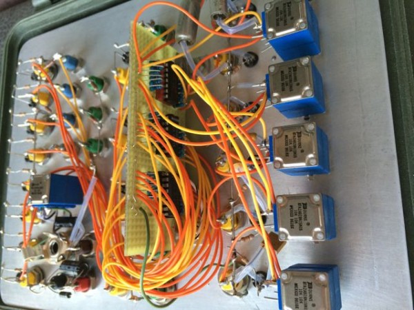

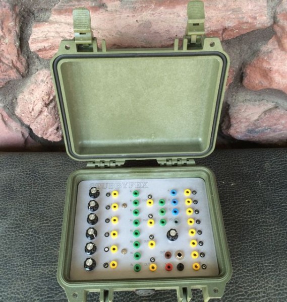

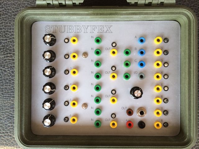

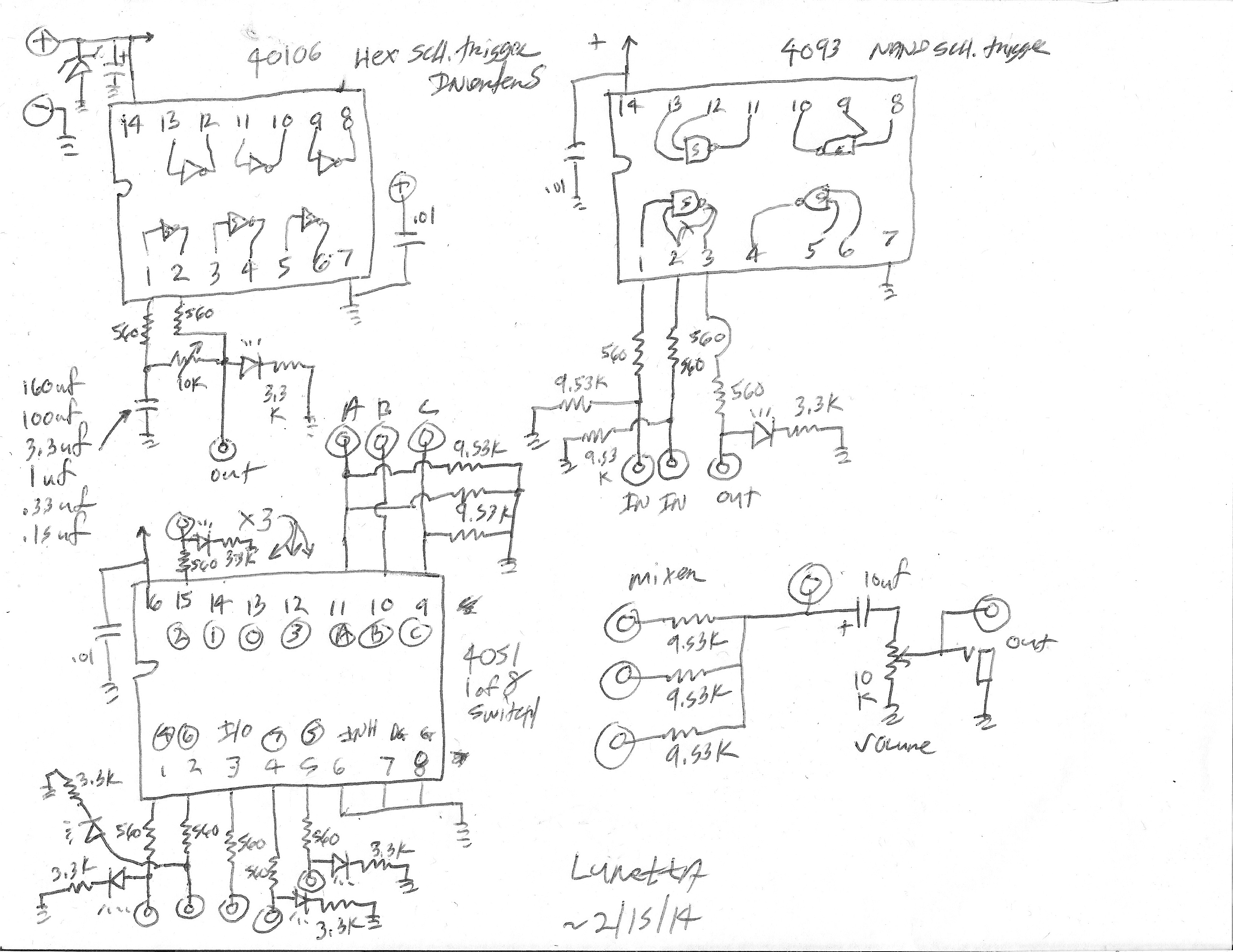

Just finished my first Lunetta. It uses three chips: a 40106, a 4093 and a 4051.
I used a Pelican 1200 box. The faceplate is 1/8" aluminum with a clear label that I printed on an ink-jet printer. I then sprayed the label with clear to keep the printing from washing off. Great sounds! The diode on the power socket is a P6KE15A that clamps the input voltage at 15v. I usually power it from my home-built modular synth's Power One switching supply. It also works great with a 9V Voodoo Lab Pedal Power Iso 5 too. All inputs and outputs of the chips have 560 ohm resistors on them. The inputs all have pull-down resistors, and the outputs have super bright red LED's. [/img]

Looks really good to me Very Happy . I was looking at the schematics and I was a bit surprised by the 9K53 resistors in it. Did you have a good reason to use these or did you just have a plentiful supply of them?

Yes, I had a box of them and thought they were close enough to 10k. Same with the 560 ohm. I'll get some sounds up soon too.

Nice build! Can you close the case with the patched cables in it?

All inputs and outputs of the chips have 560 ohm resistors on them. [/img]
I understand the need of pulldown/-up resistors, but why a serial resistor?
