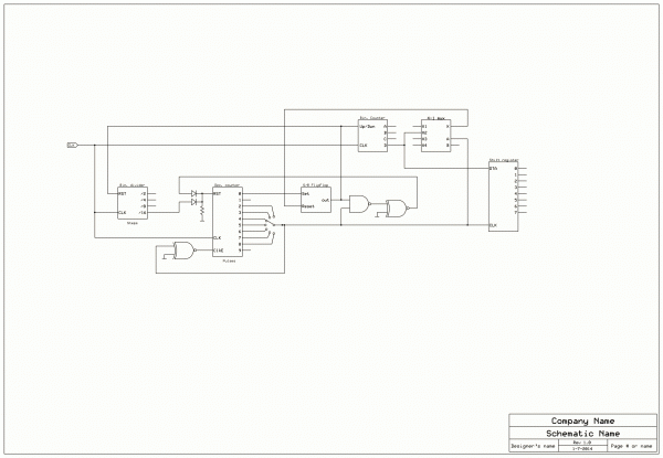

I noticed some talk about euclidean generators on the forum (here's a nice module, and here's some chuck code),
and I wondered how hard it would be to make one with some cmos chips. Cool
I read the pdf that was posted which gave me an idea of using several counters but I was not really sure how yet.
It was this piece of code that Blue Hell posted that gave me the idea for the circuit.
Code:
    function EuclideanRhythm3( aPulses, aSteps: Integer): string;
    var
      Error : Integer;
      i     : Integer;
    begin
      Result := '';
      if aSteps > 0
      then begin
        Error := 0;
        for i := 0 to aSteps - 1
        do begin
          Error := Error + aPulses;
          if Error > 0
          then begin
            Result := Result + '1';
            Error  := Error - aSteps;
          end
          else Result := Result + '0';
        end;
      end;
    end;
focussing on this section
Code:
          if Error > 0
          then begin
          end
It starts with adding a value (the number of pulses), then compares it (in this case with 0) and based on the outcome it either puts out a 1 and
subtracts a value (the number of steps), or it puts out a 0. And then it loops back. Adding and subtracting is nothing more then counting up or
down, so it switches between counting up or down a preset amount (steps, pulses).
In the original code the error value also goes negative which would add some unnecessary complexity to the circuit so I had to shift it to use
positive values only. For 8 steps it needs to be shifted 7 places so the Error value stays between 0 and 15. So I basically changed
[if Error > 0] to [if Error > 7]
For counting up/down a CD4029 seemed like a logical choice (but a CD4510 should work as well). It can count from 0 to 15 and to check if it
has counted above 7 you only have to look if output D is high Very Happy
Then 2 more counters, one for the number of steps and one for the number of pulses and some sort of comparator/switch.
So I tried patching something up on my modular lunetta to see how far I could get and I actually managed to get it working somewhat. However
the result wasn't synced to anything yet and the shiftregister was loaded at an uneven pace. And because I only have 1 decimal counter in there I
used a binary counter and could only do 2/4/8 steps. Since the results of 2 and 4 steps can also be achieved with 8 steps I didn't test those.
Here's what that first patch looked like:
Code:
Error := Error + aPulses;    (up/dwn = 1, count 'aPulses' steps using digital counter)
if Error > 7                 (output D of binary counter = 1)
then begin
  Result := Result + '1';    (shiftregister data 1, CLK 1 step)
  Error  := Error - aSteps;  (up/down = 0, count 'aSteps' steps using binary divider)
end
else Result := Result + '0'; (shiftregister data = 0, CLK 1 step)

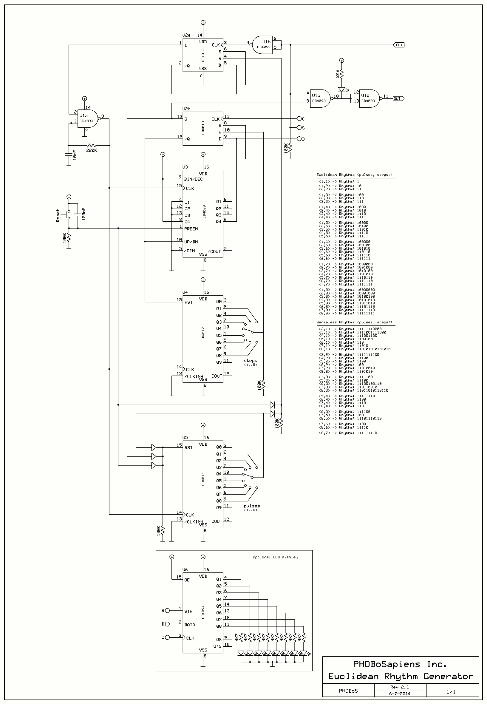

When I tried to simplify the circuit (like replacing the NAND followed by an XNOR used as an inverter with a single AND) it didn't work anymore.
And although I got that part fixed after some small changes, it still looked a bit to chaotic compared to the code. It was after I changed the FlipFlop
from a Set/Reset to a D-type (with reset) that the circuit got it's current form. And by using a second FlipFlop I got it synced to an external CLK.
I also managed to get rid of the shiftregister for a lower chipcount, but it can still be added as an option. Might be fun with some resistors as a CV
generator Razz
The circuit has an internal oscillator which basically 'runs' the circuit between CLK pulses. So it calculates and waits until the CLK goes high
before the result appears on the output. (and then it waits for the CLK to go low and calculates the next and so on). Because of this oscillator there
is a maximum CLK frequency for which the circuit works. I initially wanted to set the internal CLK frequency at 100KHz but at high speeds the circuit
doesn't work anymore Confused. So I had to experiment a bit and with the current values it seems to work fine. However it's too slow to use it for
audio frequencies (not sure if that would be very useful and not what I designed it for anyway). If my calculations are correct it runs at ±200Hz
so with the counter having to count a maximum of 16 steps ( 8,8 ) the CLK could be 12.5Hz max.
The reset was the last addition to the circuit and although it seems to work there is a lag of 1 or 2 CLK pulses depending on when you press/release
the button, so I might do some more tests with that.
note: the connection between pin 2 and 5 of U2a is done for easy PCB design. The D input needs to be high when the CLK goes high and it
doesn't matter when the CLK is low, which happens to correspond with the /Q output. But you could tie pin 5 directly to (+) as well
!updated schematic 4 posts down!

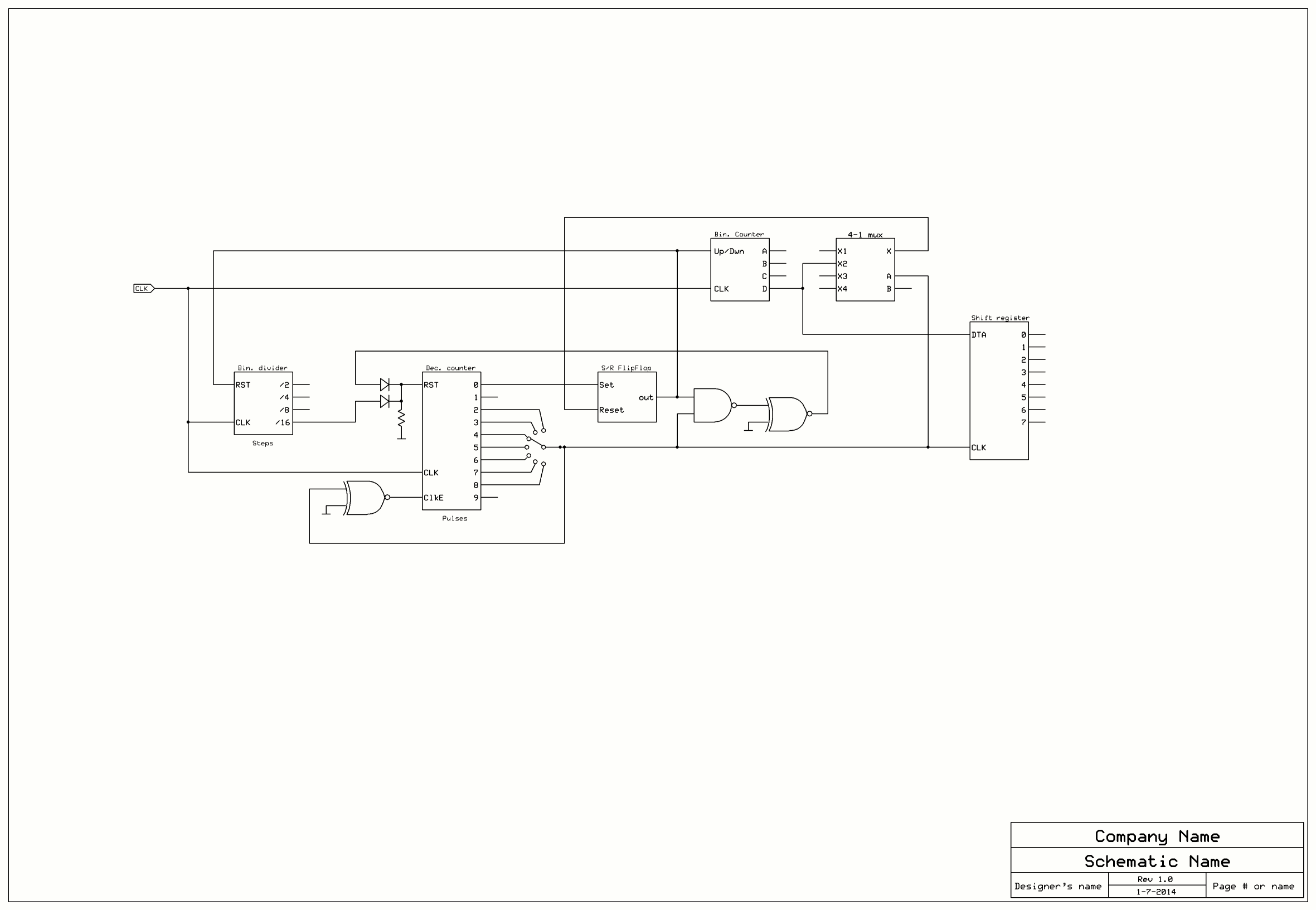

Euclidean lunetta patch

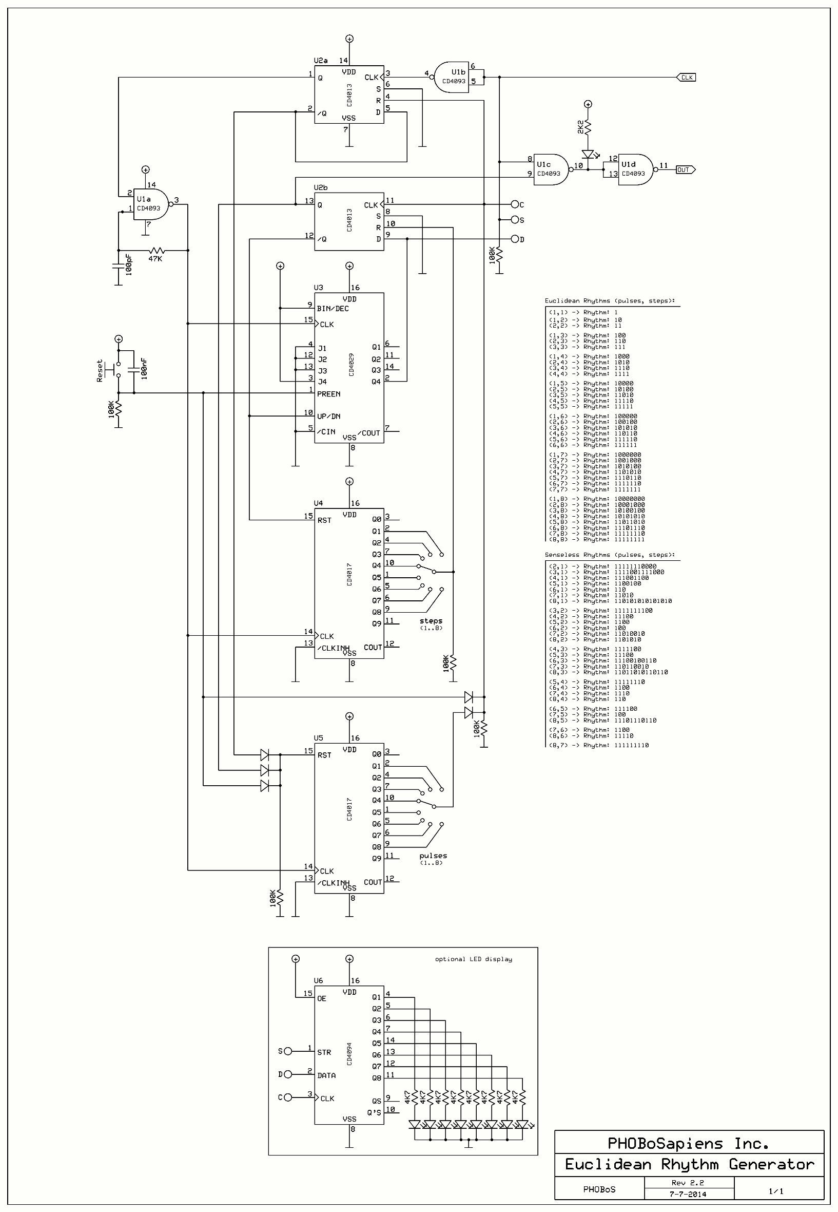

PostPosted: Mon Jul 07, 2014 5:28 am    Post subject: Euclidean Rhythm Generator
Subject description: updated schematic
Laughing
I made a small change to the circuit, which seemed to have solved the internal CLK speed problem. It also looks like it was only the shiftregister
that wasn't functioning correctly the output LED gave the correct rhythm. But I hadn't noticed that because I did the tests with the shiftregister since it's
easier to see the pattern that way. Anyway I now have it running at a much higher speed and so far it seems to be functioning correctly. I will solder it
onto a piece of perf and do some more tests to be sure.
Euclidean Rhythm Generator v2.2
(higher internal CLK speed)
 Filesize:  145.97 KB
 Viewed:  1356 Time(s)

Posts: 5881
PostPosted: Mon Jul 07, 2014 1:42 pm    Post subject: Reply with quote  Mark this post and the followings unread
Seems to work on perfboard as well banana
piedwagtail wrote:
Exemplary.
and the 4051s Twisted Evil ....
I thought about that, assuming you mean using muxes instead of the switches, and I think that should work Very Happy .
But I was also thinking about making a PIC version which could have 2 generators with 4bit inputs, and one 4bit input for the number of steps.
With 4051's you would need 7 chips for one 8 step generator, versus 1 chip (PIC) with two 16 step generators, hmm Rolling Eyes
but I bet it's a lot of fun Twisted Evil

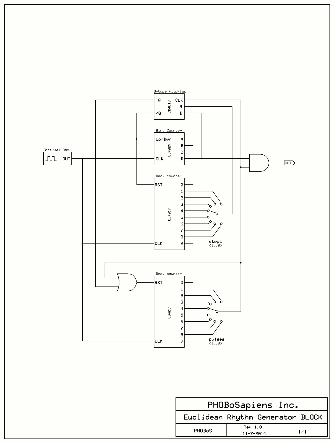

PostPosted: Fri Jul 11, 2014 8:07 am    Post subject: Reply with quote  Mark this post and the followings unread
piedwagtail wrote:
Struggling to understand quite what you did here.
Here's a slightly different simplified version without external CLK and reset, see if you can understand how that one works,.
and then you should be able to figure out the final version. Cool
Basically it counts up the number of steps that is set with the pulses switch, then it checks if the binary counter (4029) has counted >7 using
simplified version BLOCK schematic.
 Filesize:  24.94 KB
 Viewed:  810 Time(s)
Posts: 5881

PostPosted: Fri Jul 11, 2014 8:33 am    Post subject: Reply with quote  Mark this post and the followings unread
the flipflop. If so it will count down the number of steps that is set with the steps switch and then count up again, if not it will count up again straight
away.

PostPosted: Mon Dec 24, 2018 5:25 am    Post subject: Re: Euclidean Rhythm Generator
Hi everyone !
I want to give a try to this euclidean sequencer.
I am wondering if it will work as it is with 16 steps and 16 pulses, or maybe 10 steps and 10 pulses so l don't need extra cd4017?
Other question where should be connected the C D S dots?
Posts: 5881
PostPosted: Mon Dec 24, 2018 6:42 am    Post subject: Re: Euclidean Rhythm Generator
I think (but I am not 100% sure) you should be able to add a 9th step as that output is still free on both 4017's but that's the max.
If you want more steps you could try replacing the 4017's with a binarycounter+bin2dec decoder (CD4514) but I can't guarantee
that will work. It's been a while since I designed it and when I look at it now I wonder how I figured it out in the first place Embarassed
The CDS connections are for the optional LED display and they just connect together (C-C, D-D, S-S)
jeanpat
Joined: Jan 15, 2018
Posts: 7
Location: france
PostPosted: Mon Dec 24, 2018 7:57 am    Post subject: Re: Euclidean Rhythm Generator
Thank you phobos for your reply.
Nice design!
I am still reading about all those cmos chips, to understand how they work together.
I just notice that the cd4017 start couting on Q1 ans not Q0 does it make a difference ? If not it could make 10 steps.
I will try to breadboard this to see how it work.
Posts: 5881
PostPosted: Mon Dec 24, 2018 8:39 am    Post subject: Reply with quote  Mark this post and the followings unread
If I recall correclty Q0 is used as a rest position when the reset input is high because the 4017 has no option to disable
the outputs. It might be possible with a different design to use the CLK enable pin to hold the counter on the last step
but that would still give you 9 steps max.
