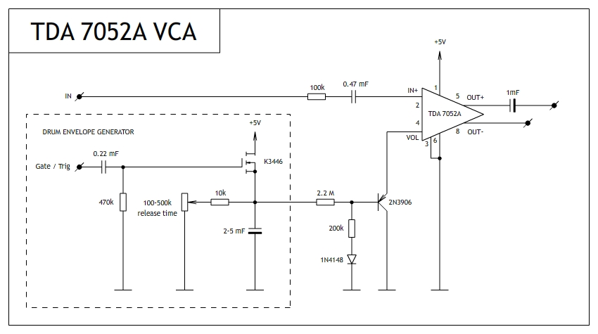

I'm back with my version of TDA7052A VCA!
Volume pin have something like pullup resistors. If volume pin is not connected, there will be max volume level. If you will connect cap. between volume pin and ground, cap. will be chargered.
Transistor draws this pin to ground. But 0.4V is minimum voltage, when amp output level is already zero. That's why I added diode to minor shoulder of voltage divider.
Left part of this circuit have trigger for drum envelope. MOSFET is for fast cap. charging. This circuit is triggering even when you touch input cap. by finger.
TDA7052A VCA

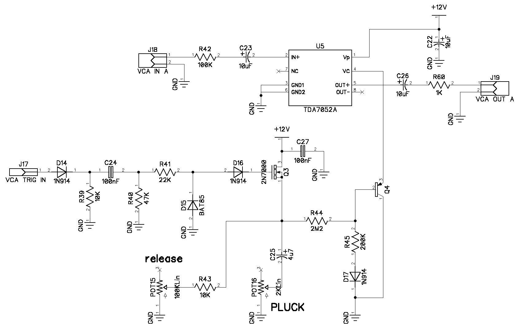

Hello
I've tried your circuit and it's working like a charm.
However I wanted to create some "snap" effect on the attack.
It reduces the overall amplitude but allows to have "plucked" very percussive attacks; I use it with 40106 and ICL8038 oscillators mainly.
You can try 1K lin/2K lin for the "Pluck" control.
You'll need a bit of Release if the Pluck is not at min.
Here's a simple mod :

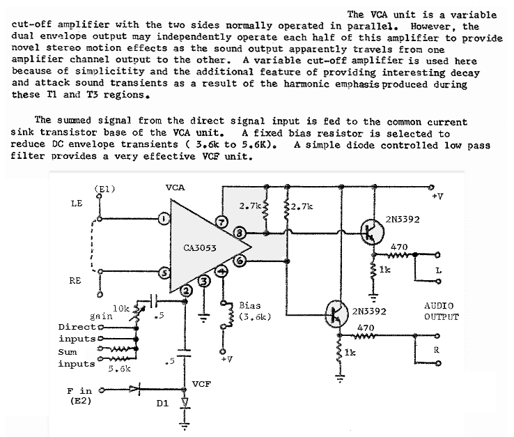

Here's one I thought I hadn't tried.
I had trouble understanding the Korg KR55 drum machine VCAs until I flipped the schematic vertically, changed the pnp transistors to npn and reversed the diode. Then I recognized it as similar to a VCA I had tried, and used successfully years ago: The VCA from]Ralph Burhans'Digivox, posted elsewhere in this very forum.
http://electro-music.com/forum/viewtopic.php?highlight=digivox&t=44343
Here's the relevant excerpt: http://www.sdiy.org/richardc64/rtlsynth/vcatxt_071209a.gif
In both Korg's and Burhans' circuits the bottom transistor gets the input signal and the top transistor is the control element.
The CA3053 Burhans used is obsolete, but its internals are easily replicated with two 2N3904 or similar, or three if one wants the dual outputs of the original design. I have labeled the resistors (in blue) with the closest 5% values. The "Bias" trimpot would be adjusted for minimal thump caused by CV feedthru.
Rs may need tinkering for voltages other than 3.6V RTL levels. Because the circuit is linear it will work on any waveshape as Input.
 Filesize:  23.13 KB
 Viewed:  494 Time(s)

I'm sure this leaves "simple vca" land, but the right side of what you posted looks awfully similar to this: https://www.aleph.co.jp/~takeda/radio/img/farmVCA-scheme.gif
Obviously, they only look similar... tying both of the outputs on yours to that opamp would minimize CV bleed through and make it mono. I was actually thinking about trying to get Takeda's VCA to work single supply, although I'm not sure I can get it there.
Yep, only in appearance, the operation of the two designs is quite different. In Burhans' VCA the "top" transistors are the control elements; in Takeda's they form a differential amplifier handling the audio. Note that the base of Q2 is grounded. Someone more knowledgeable could explain the operation of Takeda's design (which I only vaguely understand) better than I possibly could.
That would be a stretch.
