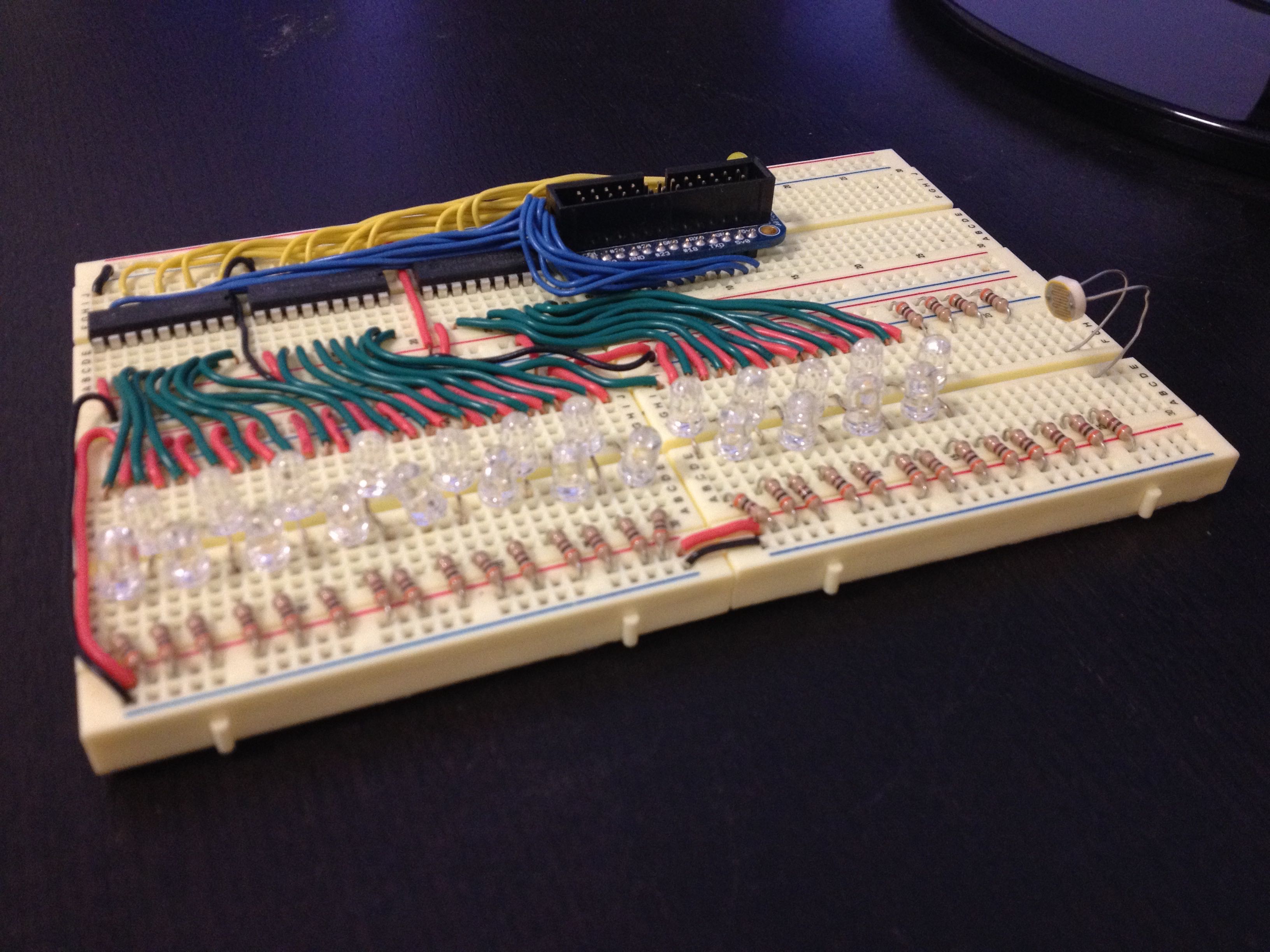

Here's a simple relay board I put together a couple of years ago for a percussion installation, but it also makes a great interface for lunettas and the like; each LED corresponds to a MIDI note and when the LDR on the right is hooked up to the oscillator, pitch control and other modulations are available from a MIDI keyboard/ sequencer. Preferably in a dark room.

Awesome!
And nice understatement!
Seriously, that's pretty cool. You were controlling pitch? I can't imagine that this thing would be tuned. (Not that I'm asking for it to be tuned.)
But really neat idea to use combos of LEDs in a row like that, so the close ones affect the LDR more than the far ones. Was 20 overkill? How much light did the last LED add?
I've only ever done multi-LEDs where I put them all just about the same distance clustered around the LDR. Like petals on a flower, basically. It was good for polyrhythms, but there wasn't any real attempt at finesse.
And man, I'm sad. I just read up that CdS photocells like these are no longer being produced (or legally put into products?) in Europe. Will we have to figure out an alternative?
And has anyone played around with photodiodes or phototransistors in this type of application?

There are 24 LEDs simply because the MIDI/ PIC board that drove it was 2 octaves. It does give pitch tracking in that the furthest light will give the lowest note...the main benefit is the fairly accurate repeatability of patterns. Makes a pretty good LFO too when programmed with 2-octave arpeggiations.

Also there's an area in front of the LDR for checking out various "preprogrammed" LEDs eg the famous phobos fireplace Cool

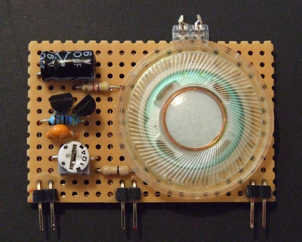

Here is a suggestion for a simple circuit with a 4015. It is basically a scaled-down version of the Opus4015 circuit from another post in this forum. You can also find the RandomChiptune circuit there using a 4051.
The amplifier in the schematic is for a small module that I built for a friend. It might be useful for others experimenting with Lunetta circuits as well. The circuit is a simple transistor amplifier as you can find it on the Talking Electronics web site. The module is designed to plug vertically into a breadboard and includes a small 0.3W speaker. The left and right connectors go to the upper and lower power lines on the breadboard, the middle connector is for the input. There is even a small trimmer to adjust the volume. The quality is pretty good, definitely good enough for Lunettas.
