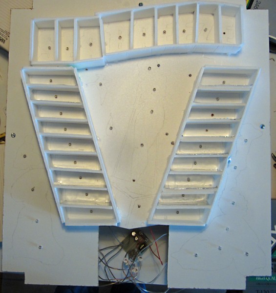

I finally finished the "Sea Breeze" Lightbox, made using a circa 1949 pinball backglass. The electronic circuit controls general illumination, as well as two chaser circuits, one of which changes speed periodically. It's just to look pretty on a wall... it makes no sound, nor is it part of a pinball machine.

* Runs on 12V regulated supply. Contains 45 warm white "straw hat" LEDs.
* The S-E-A-B-R-E-E-Z-E chaser is 9 LEDs, and was adapted from Bill Marsden's "comet trails" chaser circuit using a CD4017 and transistor drivers (see fig. 12.3 D on allaboutcircuits: http://forum.allaboutcircuits.com/blog/leds-555s-pwm-flashers-and-light-chasers-index.378/ ).
* The "scores" chaser is 18 LEDs, and uses Bill Bowden's "18 Stage LED Sequencer" circuit with 2 CD4017's, but with 3 ULN2003 transistor arrays to drive the LEDs ( see http://www.bowdenshobbycircuits.info/page5.htm#4017-7.gif).
* There is a mode timer which will enable/disable the chasers such that only one is running at any one time. Diode steering is used so that when the "scores" chaser is running, the S-E-A-B-R-E-E-Z-E letters are all lit.
* There is also a speed control timer circuit for the "scores" chaser, same thing I used in my first pinball lightbox (see my post http://electro-music.com/forum/topic-61960.html ). This consists of a CD4046 VCO which serves as the clock for the chaser counters. The timer switches between the VCO being fed by a large capacitor, or nothing. When it's nothing, the VCO runs at its base speed, which is set at about 1s. When it switches to the capacitor, the voltage goes from the 12V and discharges in about 30-40s, hence the clock speeds up to its maximum, back down to the base speed.
* The actual mode and speed switching is handled by a CD4053. The timers and clocks (except for the 4046) are good ol' CMOS 555's.
* For general illumination, i.e. the LEDs which are always on (the girls, the bird and the sailboat), there are 6 strings of 3, 2, or 1 LEDs in series.

Front and back of the box.

Light panel with isolators.
 Filesize:  264.41 KB
 Viewed:  568 Time(s)
