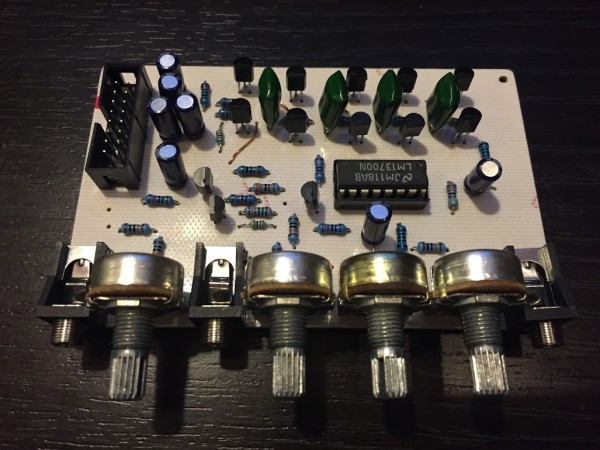

This layout is verified. The cutoff pot should be connected to -12v instead of ground to completely close the filter.
Files: https://github.com/jbeuckm/EFM_VCF_4622
(image updated with the fix now)

I built one to test the general layout, but the one on Github is modified a lot since then. It worked, but the early layout needed a kludge to get -12v to the freq pot. I need to verify the newer version soon.

Latest version v0.2 works. I fixed the -12V frequency pot thing, moved things around some and moved the CV+Q+F pots slightly further apart so they aren't jammed in.
