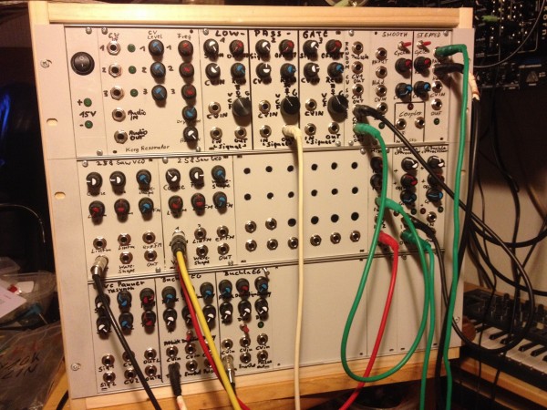

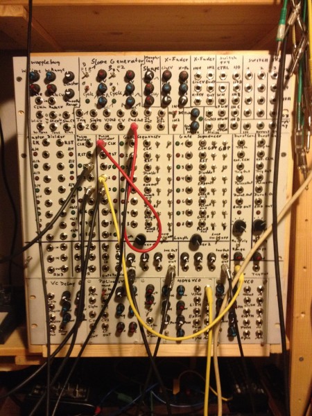

PostPosted: Mon Oct 03, 2016 12:23 pm    Post subject: Reply with quote  Mark this post and the followings unread
Suffering the last few days from an acute solderitits i couldn't withstand to fill up my cabinets with a few more modules.
Finally i finished the "brain" and filled the last gap with a second CGS pulse divider... Guess now 2 pulse divider, 2 gate sequencer, a master divider, 2 burst generators and some logic together with various dividers, logic and gate to trigger converters in my other cases should give me enough triggering options... Smile
The other modules in this cabinet are:
1xWogglebug, 2xTH4046 VCO, 2xCGS Mixer, 1x Polivoks VCF, 1x Scott Bernardi VC Delay, 1x TH X-Fader/VCA, 1x Morph Lag, 1x TH AD/AR, 2x Serge VC Slopes (or just one DUSG), 1x MFOS Noise Cornocupia, 3x Serge 2 Way Switches, 1x Serge 4/1way switch plus a few gate to trigger converters
The second cabinet so far has is Korg Ps3100 Resonator Clone, 3x LowPassGate, 2x 258VCO (saw/sine), 1x Buchla Random Voltages, 2x buchlaesque CV processor, 1x mini mixer, 1x Yusynth VC Panner, 2x Buchla Easel EG (of which the second one has a bug as the EG becomes slower and slower within time independently of the trigger, have to take a look again at this) and finally 1x Serge Smooth&Stepped Generator... left space to be filled with 2x 258 VCO square/sine 2x Ian Fritz analog XOR and either a Buchla Pulser or the Buchla 291 BPF

PostPosted: Tue Oct 04, 2016 6:55 am    Post subject: Reply with quote  Mark this post and the followings unread
that looks great! Razz
Thank you Phobos! But don't come closer and take a look again, especially in the inside of my cabinets... would change that great to what a mess... okay, on the frontboards everything looks fine and usually only the power cords from my stripboards are flying loose around... Smile

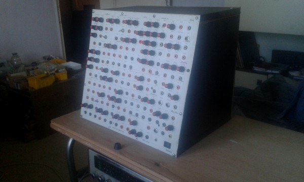

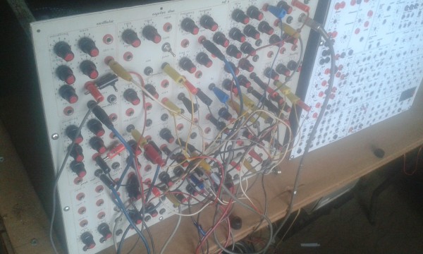

PostPosted: Fri Oct 14, 2016 2:11 am    Post subject: Reply with quote  Mark this post and the followings unread
it took me a while to complete this ,so maybe is not 2016 build ,here are the modules :
Buchla 258 x 2
Serge Positive slew x 1
Serge Negative Slew x 1
Serge VCFQ x 1
PT VC Echo x 1
Paparail VC Aux x 1
NLC VCA x 1
VC Slew Befako x 1
Yusynth Pulse Delay x 1
Serge Comparator x 1
Osamu H. Sample and Hold x 1
Serge SSG x 1
Serge Middle Wavemultiplier Section x 1
NLC Neuron x 1
Electronotes Wave Animator x 1
Serge Resonant EQ x 1
Bissel Morphlag x 1
Buchla 208 Random x 1
Yusynth Noise x 1
Serge Peak and Through x 1
connected with NLC Differenc Rectifier
NLC Sloth Chaos x 1
E4M Xmix x 1
now all i need is more cables Smile))

wackelpeter
Joined: May 05, 2013
Posts: 461
Location: germany
Audio files: 10
PostPosted: Fri Oct 14, 2016 3:04 am    Post subject: Reply with quote  Mark this post and the followings unread
That looks very nice Vladosh.
Seems as we both built a lot of the same modules lately... Smile
All this is powered from one PSU??? Well i'm asking because in my latest cabinet the heat sinks for my regulators seem to get really hot and it's only about 630mA on the positive rail... maybe i have to build in bigger ones... at the moment they are about half the size of a cigarette box each..
And also... did you made the gain cells for the Serge VCQF yourself or did you used some PCB's from Ken?
vladosh
Joined: Aug 02, 2010
Posts: 678
Location: macedonia
Audio files: 51
PostPosted: Fri Oct 14, 2016 3:30 am    Post subject: Reply with quote  Mark this post and the followings unread
thanks ,this is also on same PSU wackelpeter ,i reuse heatsinks from computer PSU's worked fine so far .. i have a big transformer in this box so as i have seen somewhere here on forum i plan to feed a second box with the same transformer's AC ,not on picture but on the back of the box there is the 220V and a 4 pin jack to connect both ,and for the vcfq i made the gain cells myself while the filter itself is not so special really ,the '73 vcf sounds better as i recall ,and also i tried to make a cv filtering option on this filter but it introduced lot of noise
