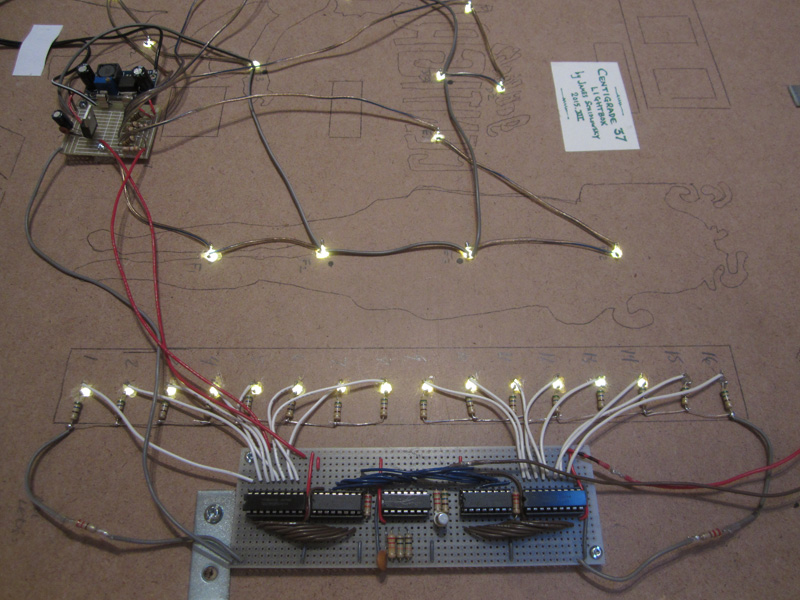

This is an electronically animated lightbox I made from the backglass of a Centigrade 37 pinball machine made by Gottlieb in 1977. The original machine had an electro-mechanical animation for the thermometer, which consisted of a red ribbon that would crawl up by increments each time one hit certain targets. Instead, I used a gradient of dark red to light yellow printed on acetate and compartmentalised LEDs. When it reaches the top, the tower flashes faster and faster, then the thermometer decrements back down.
I made this for my friends who opened the North Star pinball bar in Montreal, Canada in January 2016, which is reflected in the score digits (printed on paper, not using actual score reels), as well as their star logo in the credit window. This and the other lightboxes I made are all on permanent display there.
* 33 warm white "straw hat" LEDs running on 12V regulated "wall wart" power supply. 16 of them are always on, for general illumination, 16 are for animating the thermometer, and one to flash the tower.
* A PICAXE-14M2 microcontroller is used in conjunction with 74HC595 shift registers and TD62783 transistor array drivers to control the animation.
* A pre-made LM2596 buck converter board is used to drop the voltage down to 7.5V which is then fed to an LM7805 voltage regulator to supply the PICAXE and 74HC595's.
* Some of the logic involves randomness: the length of time between thermometer gradations lighting up and the pause before the animation sequence starts over.
The circuit boards... in the foreground, the microcontroller, shift registers and transistor arrays, and in the background, the power section.
