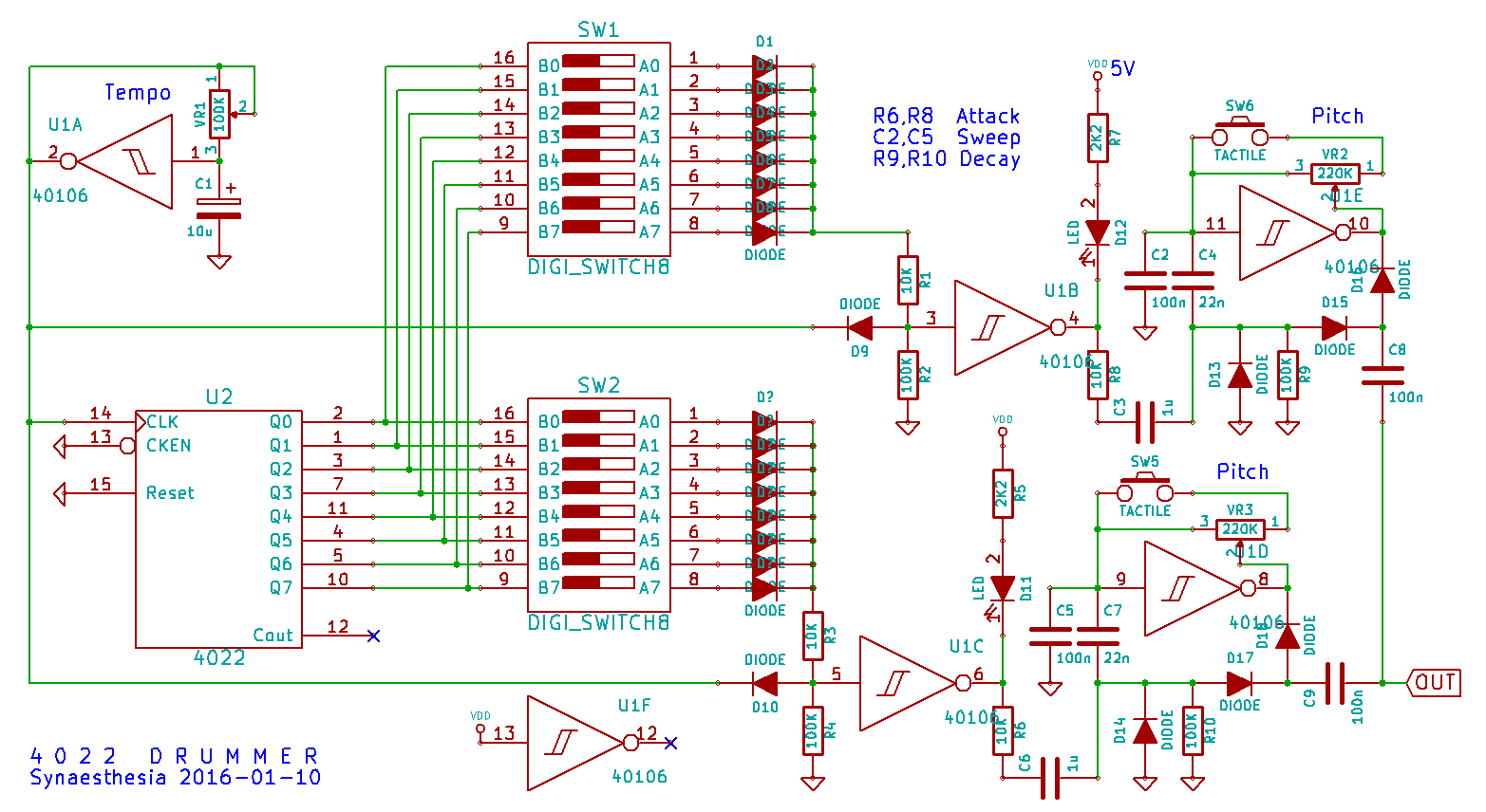

Subject description: A simple percussion sequencer with two instruments using only two chips
How simple can a percussion sequencer be built in Lunetta style? It should have 8 steps and at least two percussive voices. This is what I came up with - the 4022 sequencer. No CVs here, just a beat or not on every clock.
I am using a 4022, but a 4017 wired for counting to 8 could be used as well. The nice thing is that they already have the counter plus decoder integrated. This gives me eight revolving trigger signals. The DIGI switches then select which one will result in a tone. The diode networks are necessary to avoid the trigger signal running backwards into the other switches. That's the only drawback here - you need lots of diodes.
The positive trigger signals are fed into an inverter, that creates a pulse through a capacitor and temporarily enables the output from a percussion oscillator. The diodes D15 and D16 at the oscillator output are used attenuate the oscillator tone. Capacitors C2 and C5 modify the frequency of the oscillator during the attack, which results in a nicer percussive sound. Diode D13 ensures that the capacitor quickly changes polarity again when the trigger signal goes down again. Finally resistors R9 and R10 controls the decay of the oscillator tone and can be left out if you want really long decays.
The eight trigger signals from the 4022 alone would work yet because after each positive trigger you need to go back to 0 Volts again. D9 and D10 take care of that by pulling the inverter inputs down in between steps, using the lower half of the clock signal. That is the reason for the two resistors at each 40106 inverter input. They make sure that the default is at logic low level and that even a high level signal from the switches can still be pulled down by the clock.
The oscillators can be tuned from a low tone (100K-220K Ohm) to a high tone (10K-47K Ohm). My best results were with 100K and 180K for the two oscillators. However, in the circuit I used a trimmer to tune them. The odd wiring of the trimmer has a reason. When the momentary switch SW5 or SW6 is closed, the total resistance in that inverter feedback path is lowered (at least by a factor of two), resulting in a higher tone. This allows to play the instrument a bit and results in nice variations.
One 40106 inverter for the clock, that leaves two pairs for the oscillators. It is a pity that the CARRY signal from the 4022 is off by half a clock cycle, otherwise it could have served as a third hardwired bar beat trigger. Nevertheless, quite a lot to get out of only two chips.

The DIGI switches are DIP switches, right? I was going to use these for a perfboard sequencer (my lunetta in semi-progress is very much inspired by your Lunetta Lab, though it hasn't much hope of being so neatly crafted) but thought instead I'd use jumpers on a row of pin headers.

Another idea that crossed my mind is to lower the series resistor to 2K2 and use red LEDs to patch the pattern. Need to try that on a breadboard first, but I believe that there still could be valid logic levels for the trigger input.

just a thought
Any way you can use the last inverter for accent?
Another set of switches of course; maybe an impact circuit to add a thump.

Yes!! You could add it followed by a diode (cathode to output) in parallel to the trigger inverter and connect it to A0. That would give an extra emphasis to the first beat. Great idea. I hate unused gates Wink

To avoid the diodes could you use a 4051 analog mux? You send a trigger into the common pin, then take the 8 channels through switches to a bus which is the trigger source for the drum voice. No diodes required, since the non-activated channels are high-impedance. You could also use a 4512 but because the signal has to go the other way ( bus -> switches -> 8 inputs -> 1 output ) you wouldn't be able to split into multiple voices as you have done.
Possibly interesting side effect: you could send whatever you want through the common input; multiple triggers per step could be fun!
Downside: you need another chip to do the binary count. I'd patch this out, which let's you mess with the count order too.
I only bring this up because I'm currently working through the 16-step version; sure hope it works!

You are absolutely right. I considered a 4051, but 16 diodes appeared simpler and are cheaper than two 4051 ICs.

And works better, because the 4051 option would have side effects:
Can't draw it right now but consider this:
Switch step 1 voice 1 and 2 on, and switch step 3 voice 1 on. Without diodes on step 3 both voices would sound, via step 1 switches, even if you use a 4051.

You are right. I found this out the hard way and now have a lot of diodes to buy! The idea of using LEDs to patch the patterns would avoid this though.

Yes, but Leds have a significant voltage drop.
Perhaps you could use normal diodes the same way, and solder them on a double row of whatitsnames (connectors that fit in an ic socket) and voila, you can built presets Smile

That's a good start, but too many diodes, I think.
Keep the original diodes and the switches. Put a double row of female headers in parallel with the switches. Then put a double row of right-angle male headers on a pad-per-hole perf board (not strip board) and solder between pins of rows where you want a trigger. The switches can add triggers to a preset pattern but can't take away triggers, but more importantly, the switches would still be available for developing patterns before committing to soldering a preset board.
Make the perf board big enough to include a label saying what the pattern is.

I want to make two separate ouput, so I can send each one in differents fx stompbox. I'm wondering If the signal after C8 and C9 will feat for guitar pedal effect or if I have to add an op-amp on each output?

You can certainly split the output into two signals. Keep the capacitors if you do that. The output should be more than high enough to be fed into an fx box. Depending on your box, it could even be too high and require some attenuation from additional resistors.
