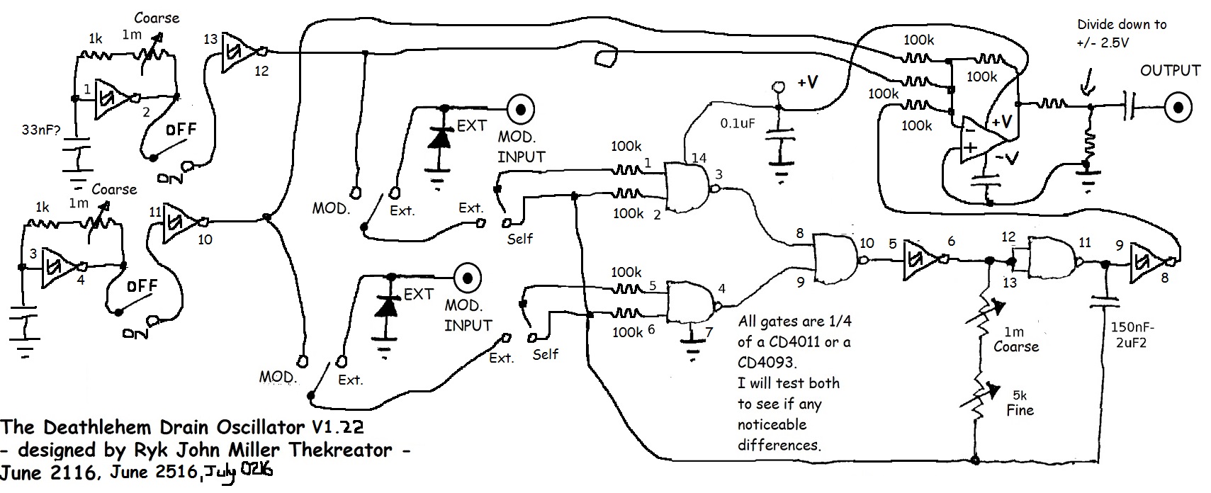

Subject description: An update to the CD4023 Pulse Width Oscillator of mine
For any out there that may have built my CD4023 / CD40106 'Pulse Width Oscillator' years ago (sometime in 2009), I've updated it a little bit, around the CD4093 quad NAND Gate chip and the CD40106 hex schmidt inverter chip.
Version 1.22 of the Deathlehem Drain Oscillator. As simple as the circuit is, the amount of sonic variety that it should be able to produce for 'noise fans', should be huge. Surprised
The main CD4093 'oscillator' can be modulated on or off by 3 different sources:
1) Itself and / or
2) Modulator #1 and / or
3) Modulator #2
Modulator #'s 1 and 2 may be either, a CD40106 square wave oscillator, or an external (protected from negative voltage) input.
The outputs of Modulator #'s 1 and 2 CD40106 oscillators are also sent to a final mixer, that the CD4093 Oscillator is being fed to. Modulator #'s 1 and 2 may also individually be switched on or off.
All together, a single 'voice' of the Deathlehem Drain Oscillator will be able to have a heavily modulated oscillator voice; a modulated oscillator voice along with a second voice, or three non-modulated voices.
I've already begun work, translating the final schematic, to my auto-routing PCB software. If, all will work well, I may have the 1st PCBs etched today, if not tomorrow. Here's to hoping. Smile
Based on sounds produced by my old CD4023 triple input NAND Gate / CD40106 modulators - 'Pulse Width Oscillator', this little guy should be able to produce noise and metallic sounds of 'unknown liquids' flowing down and through the 'unknown Drain'. Very Happy
My original plan for this 'module' was to have 4 'voices'. Now that I'm optionally including the 2 modulators for each 'voice' into the output, I may be able to have a very sonically <sic> powerful 'drone machine' with only 2 'voices' - producing up to 6 individual voices. I can't wait to hear and play with this thing! Very Happy

That actually re-encourages me to start building again. Surprised All of my playing in Diptrace was using autorouting from the schematics that I had created inside of it as well.
I did all of my direct layout in ExpressPCB for years. Was easy as heck.
I'll have to see if I can find the files for the Deathlehem Drain Oscillator on this computer to give a go again. (I can't remember whether I actually DID make the PCB, or if it were perfboard. I'll have to dig the module out and look at it.)

An update for this for anyone that has followed it:
Late last week, I found my flawed perfboard build of the above module and got 1 of it's 2 x CD4093 oscillator pairs, running without troubles.
The sound possibilities from it, are nowhere nearly as interesting as my old CD4023 Pulse Width Oscillator module, had been. There isn't as great a variance in sounds possible from the Drain, as there are from the PWO.
Modulating the chip's power input from an external CV, doesn't create as wide of a variation in sounds as I had hoped, either.
Using the ON/OFF modulation aspect of it as well, doesn't sound very much different from the original way that I had done it using a pair of CD4011 oscillators.
Overall? It isn't worth breadboarding, or, building. Confused
