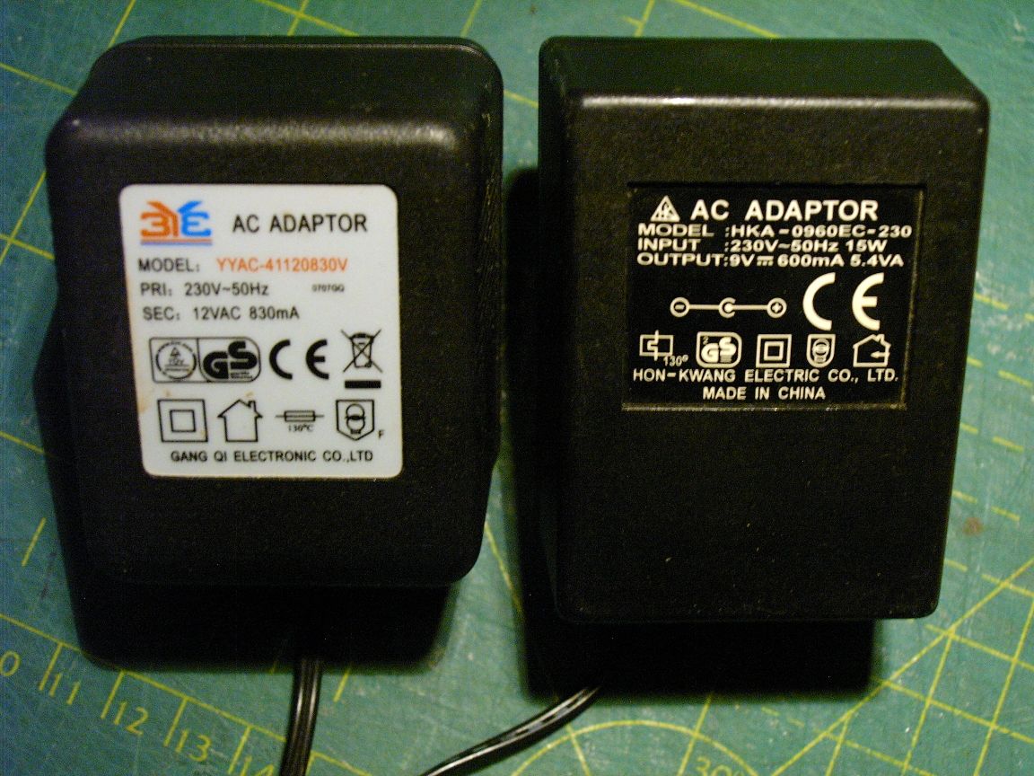

Posts: 5881
PostPosted: Wed Nov 16, 2016 5:15 pm    Post subject: Reply with quote  Mark this post and the followings unread
Here's a photo that might help you out a bit. As you can see they are both labeled as AC adaptor. But the left one actually has an AC output
(which is what you need) while the right one is DC. You will also notice that the left one doesn't have an image of the connector on.
AC and DC
 Filesize:  177.52 KB
 Viewed:  336 Time(s)
karczilla
Joined: Dec 10, 2014
Posts: 34
Location: nyc
PostPosted: Wed Nov 16, 2016 5:40 pm    Post subject: Reply with quote  Mark this post and the followings unread
I understand that I need to use an AC-AC adapter, I was just worried about the plug being connected backwards
But now thinking about it and your explanation, i guess it wouldn't matter with AC.
Thanks for the help Smile[/img]
