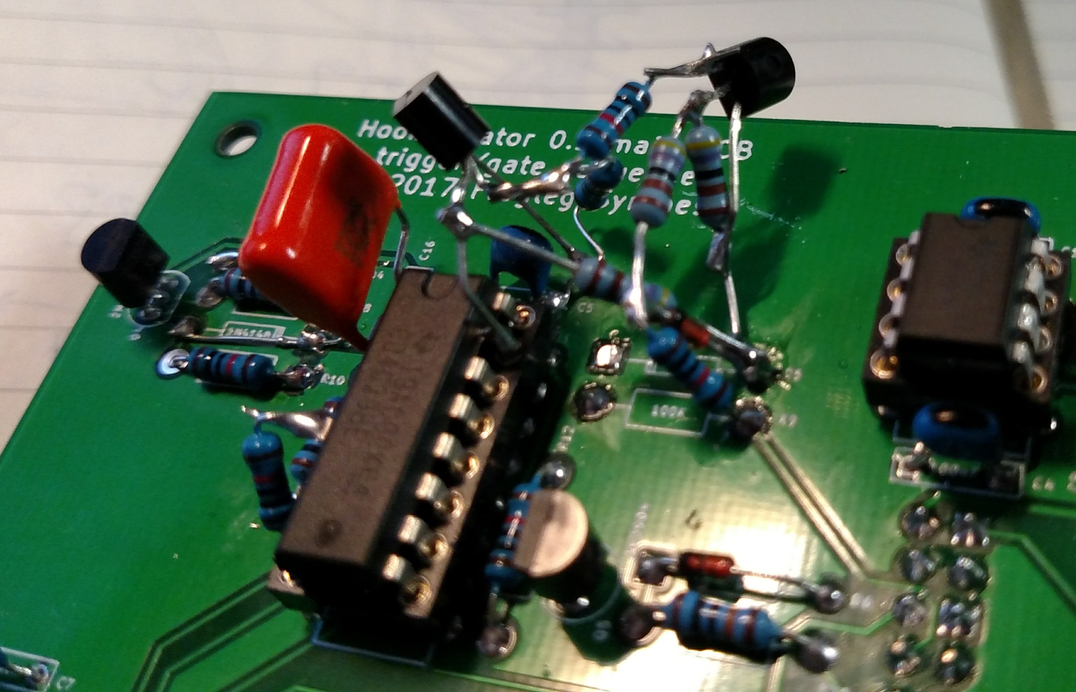

Well, it's frankenstein, but it works Very Happy

I did not, btw, do the following:
also put the same circuit in front of the reset input, which in fact is now not working for reasons I haven't gotten to yet. Still working out other stupid mistakes Smile Like putting a 10K resistor in the "input" side of those 4051's, which made the other side turn into voltage dividers, oops.
use actual zeners -- I had the diode in the circuit already, and I'm not really going to be putting any stress on this iteration of the circuit. It will take a new PCB spin before I'm ready to actually exercise it seriously.
Also, I have no 40106 in the circuit currently, and after I realized I had to do run/stop (I keep forgetting....) I suddenly needed 7 inverters instead of 6, so I took it back out entirely. We'll see how layout looks, whether I think I can/should put one back in for some of the inverters.....

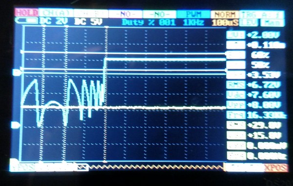

So I've been fighting with the latest prototypes on this for a bit now.
I got past "skipping 0" every time, but now depending on the combination of rate and clock width, as well as the switch settings, I sometimes get a bounce at the start of a clock cycle. Blue line is pin 15 of the 4029. Yellow is in between the 1.2K and 10K resistors in the processing section. When I measure at the input to the processing section, I get a much slower slope, with a tiny little wiggle at the point of the glitch.
It occurs when one gate is off, and the next gate is on, at which point it skips the on step and goes on to the next one. If I go off -> off, I don't skip and if I go on -> on I don't skip. Faster clock speeds and wider gate lengths are less susceptible. Using an external clock from an MI Module Tester doesn't exhibit the problem. But I've looked at the clock I'm generating and it doesn't look like there's an issue, I don't see any glitches in that waveform (other than it being slow-ish.... hm...........)
All my chips are appropriately bypassed. There's not path that I can see between the switches and the counter -- all the switches are on the other side of 4051's. I've tried a few attempts to use flying wires to re-route traces incase there was trace interference, but nothing definitive (at one point I thought I had solved it, but then found changing the speed/width settings a little bit brought the problem right back).
My current operating hypothesis is that I need some kind of hysteresis in the processing section -- If I were using a 40106 or similar inverter, that would probably solve it. There's probably room on the PCB to put it, but it seems a waste for just a couple of gates.
Of course as I type this now I'm thinking about that slow clock (slow as in a few ms rise time....). The last buffer for the clock section is an LM358 I wonder if I'm just using a lousy amp for such purposes and ought to use something else for my pulse width modulator. Time to go read up on the slew rate of the LM358.
Curious if anyone else has any ideas.....

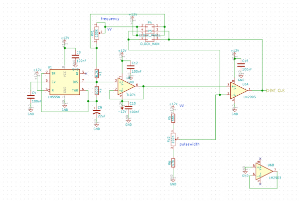

PostPosted: Thu May 03, 2018 2:06 pm    Post subject: Reply with quote  Mark this post and the followings unread
Yeah. Datasheet says unity gain config is able to slew at .3V/us so the 10/12 V here should be able to do the rise in 3.6us. Instead, even unloaded (pulled up the output pin) in the comparator configuration it's taking 600us to rise, and if I change the settings to stop skipping, the angle is noticeably sharper.
So I have to find out how to overcome the slow rise time.
Either another single sided op amp, or some change in the way it's loaded.

Interesting development. I figured "ok, maybe I should use a real comparator".
In fact, this does actually work better. I had some LM2903's lying around and they match the pinout, so yay. I put a pullup on it as you do with these kinds of comparators and voila.
Except....
I tried a 1K pull up as I have on a different circuit with an LM3900, and I got oscillation on the "high" side of the the operation.
I then moved to a 5.6K pull up (the datasheet shows 3K for a 5V supply, I have 12V, so almost double), now the "low" side is oscillating.
AND IT'S TZ FM Y'ALL.
Weirdest thing ever.
I had thought it was possibly due to how I had terminated the other unit on the chip; for the op amp I grounded + and tied - to output. So I disconnected - and output and tied - to + which is grounded instead. No change in the oscillation.

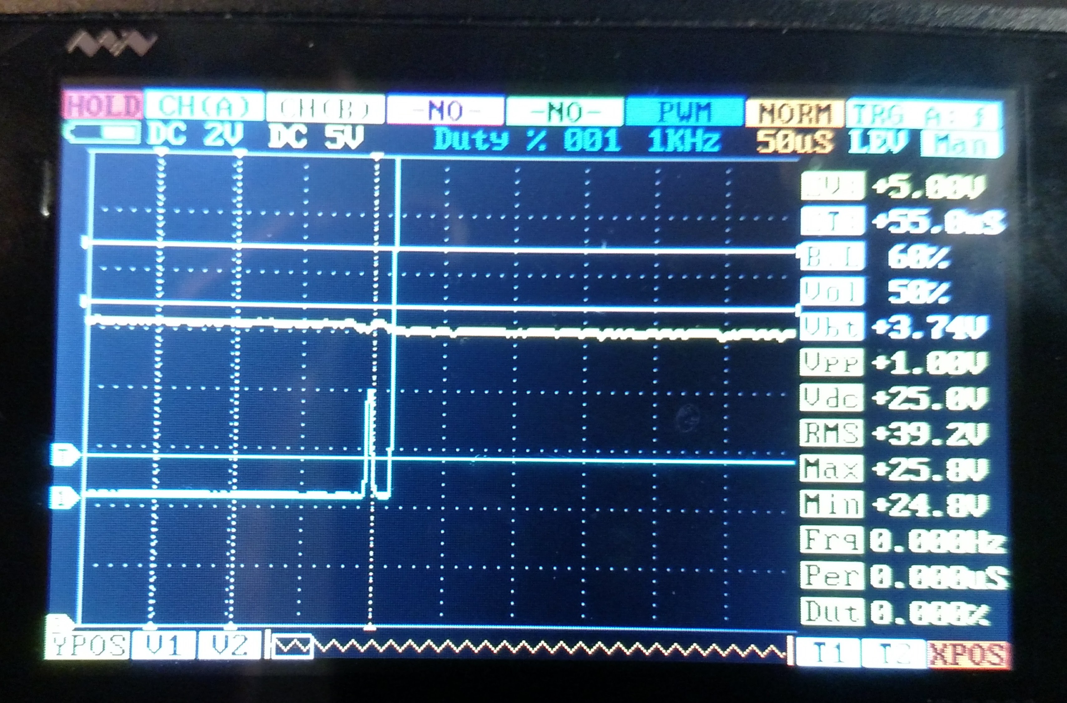

PostPosted: Thu May 03, 2018 5:56 pm    Post subject: Reply with quote  Mark this post and the followings unread
Ok, I put a 10K resistor between the buffer and the comparator and that has tamed the oscillation.
Oops Smile
