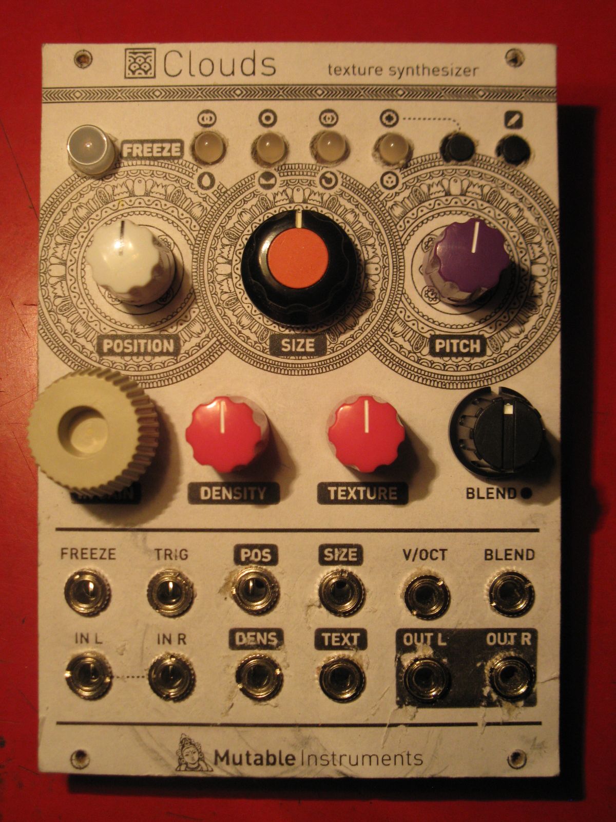

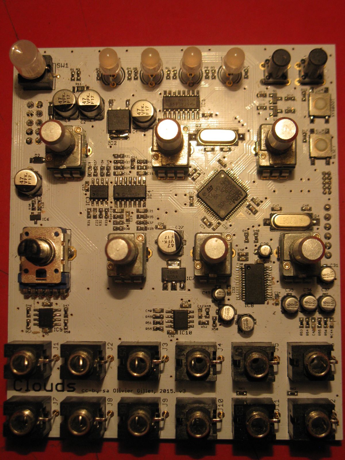

I finished soldering Clouds friday night and after flashing everything seemed to function, at least I could step through different
modes indicated by the LEDs which is also how I knew the blend pot was working. However when I tried to use it there was
no sound coming out nor was it responding to an input signal. I spend most of yesterday trying to get it working. I reflowed some
solder joints that I wasn't 100% sure about and read some threads on muffwiggler. It was there that I found a post describing
the same problem as I had and apparently it was due to old incompatable firmware, the same I had used. I couldn't find the correct
files and didn't get far trying to compile them myself so I send a pm to the guy who posted about it and he was kind enough to send
me the right files last night. After using those Clouds came alive and now works as it should Razz
I made a temporary cardboard panel for it as it will be a while before I get a proper one.

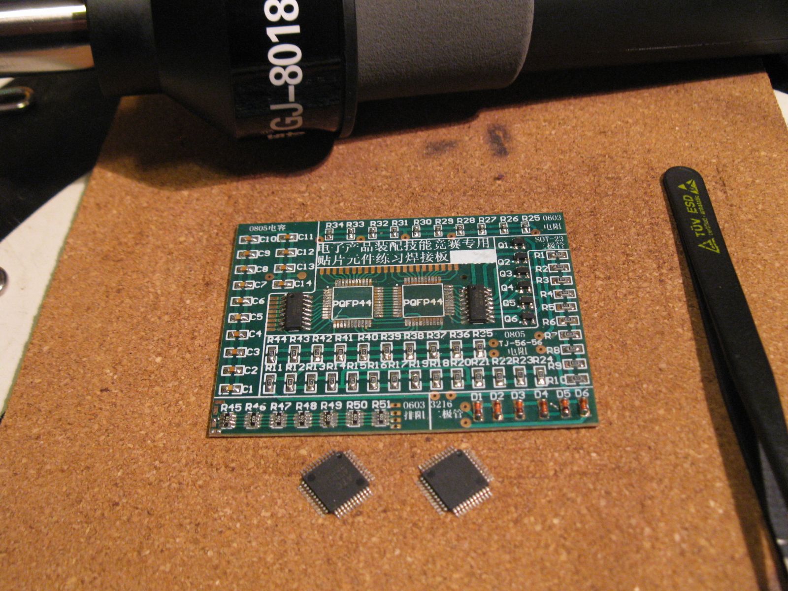

I've ordered myself a cheap hotair gun after the fiasco from last time in case I have any more screw ups in the future.
I might use it for soldering chips too. I've seen some videos where solder paste was used and it does seem to work great.

I received the hot air gun and tested it on one of the practise boards. Desoldering takes longer than I expected but it does work which is good to know Razz

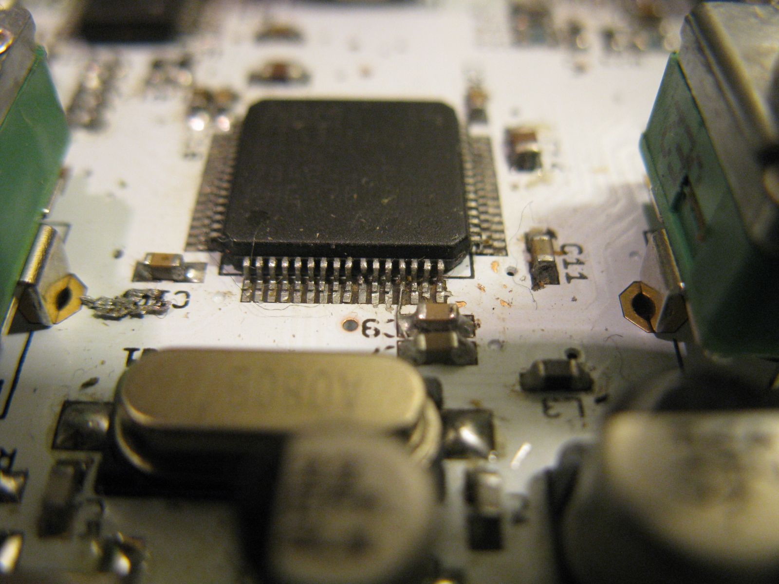

PostPosted: Mon Sep 10, 2018 3:29 pm    Post subject: Reply with quote  Mark this post and the followings unread

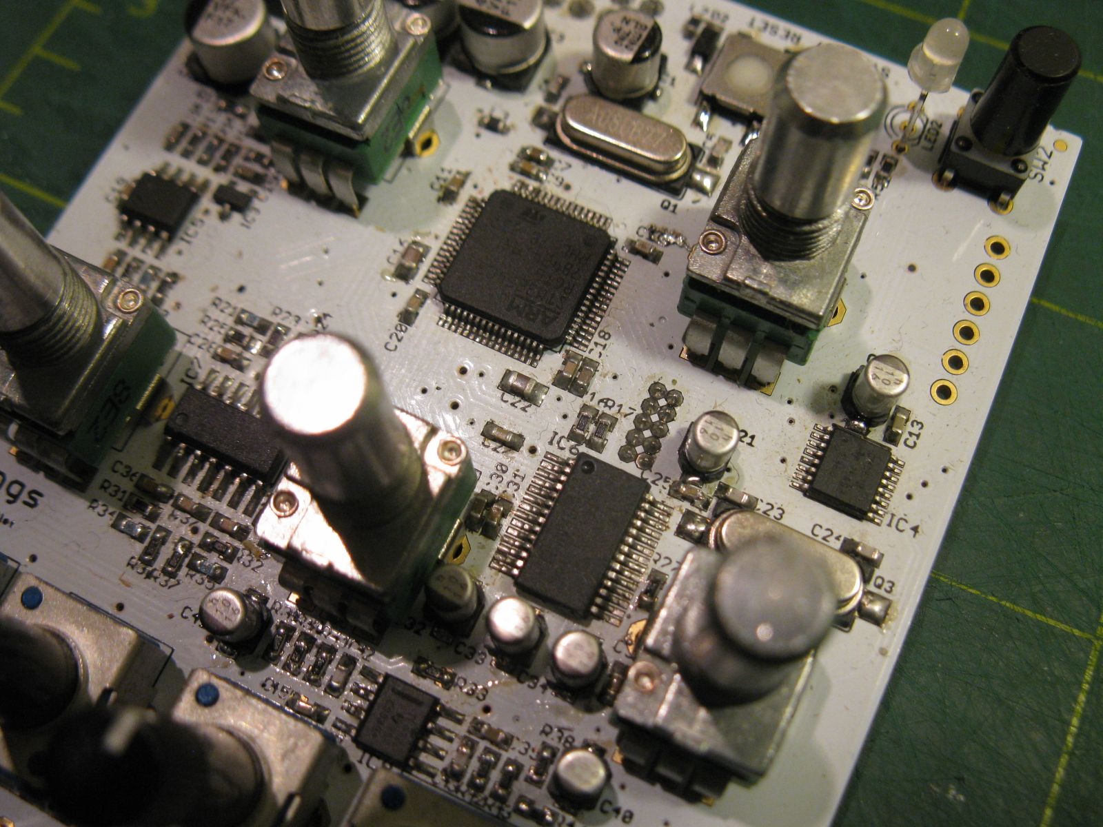

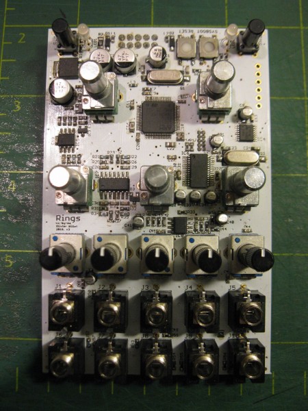

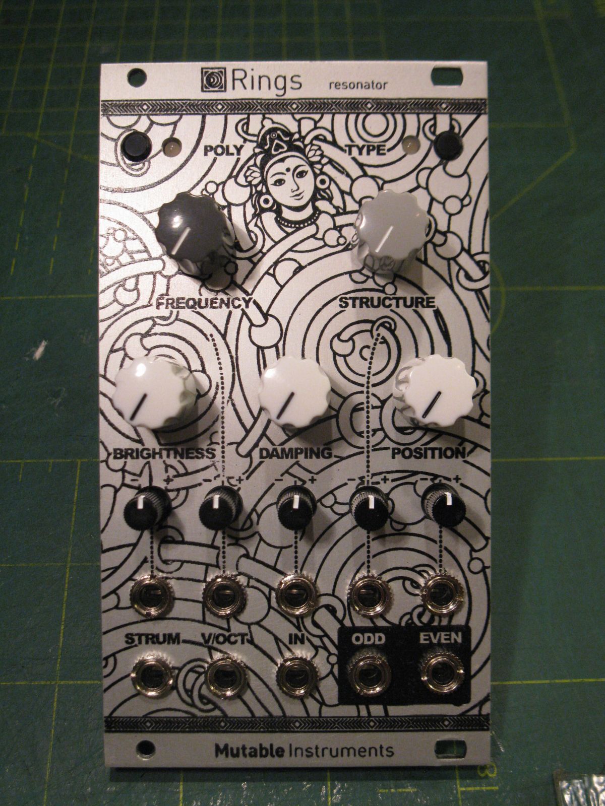

I finished another member of the Mutable Instruments family: Rings.
I did mess up soldering the ARM processor as some pins got bend sidweways. I think this happened with
the desoldering braid. Of course it went wrong on the last side I soldered so it wasn't easy to take it off.
Instead I spend about 2 hours trying to fix it which involved soldering a wire to one of the pins. That's when
you find out how small these pins really are. I had no idea if it would work so I only soldered on the parts
that were necessary for flashing the processor first. Since that went without any problems I had a bit of hope
and I soldered on the other parts. There was no smoke on powerup, as a matter of fact it actually worked! Very Happy
Today I finished the frontpanel which came out pretty nice so here it is.

Posts: 24480
PostPosted: Mon Sep 10, 2018 4:14 pm    Post subject: Reply with quote  Mark this post and the followings unread
That's when you find out how small these pins really are.
Heh.. looking at that last picture I thought .. wow .. those pots are huge ... but still miniature ones Cool
And I see you lost some beard hairs on it Wink
