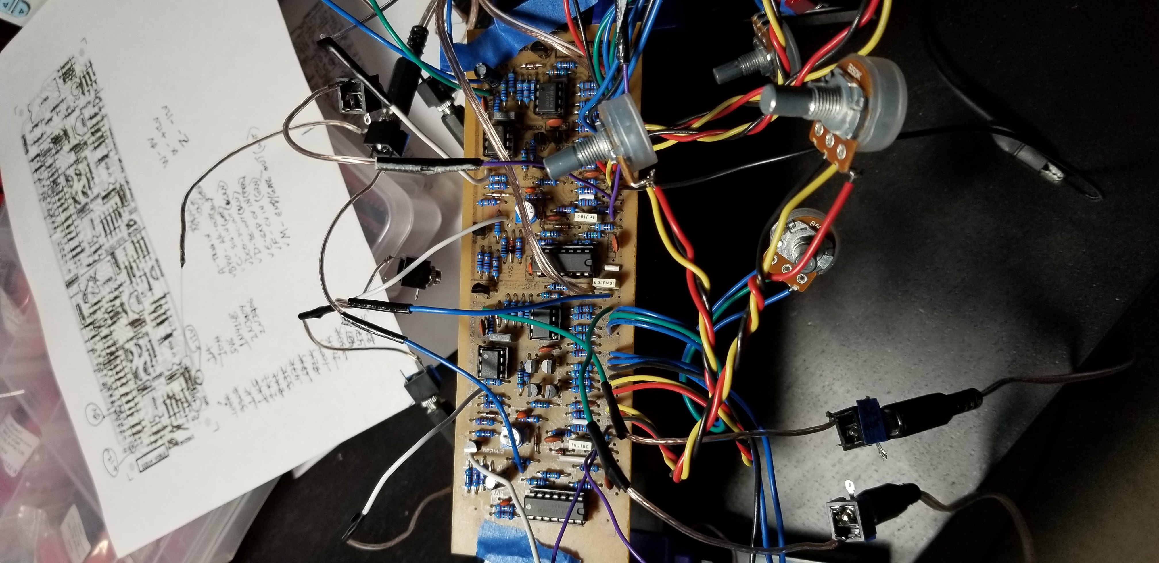

PostPosted: Wed Jun 05, 2019 1:22 pm    Post subject: Reply with quote  Mark this post and the followings unread
DUSG Working for me! Although might switch out the trimpots to diff ones, if i trim it too much i get no sound...not sure if thats a normal operation or not.

PostPosted: Sun Jun 09, 2019 1:57 am    Post subject: Reply with quote  Mark this post and the followings unread
Yes, that is normal, the trimmer kills the output if set too far either way (IIRC, at least one way for sure!) Check output on scope and trim for 0-5V as per docs... Looks good!

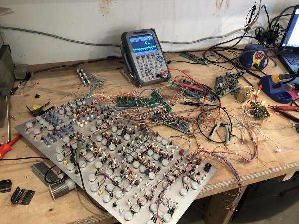

PostPosted: Wed Jan 20, 2021 12:03 am    Post subject: Reply with quote  Mark this post and the followings unread
So it has been a while. This project got shelved as my interests turned more towards arcade machines for the past couple of years, but I've finally gotten off my ass and picked this project back up. Gotta finish what I started, especially when I was so far along. Since last time I've done a ton of front panel wiring, built a mohogany enclosure (still have to sand and clear-coat it), I also replaced all those cheap banana jacks with the emerson ones that were recommended. Much better! I'm going to have to do something creative to fit all the pcbs in there since I've still got boards for 3 mixers, two envelope generators, and a headphone amp that need to go in. I'm sure I can squeeze it all in there...

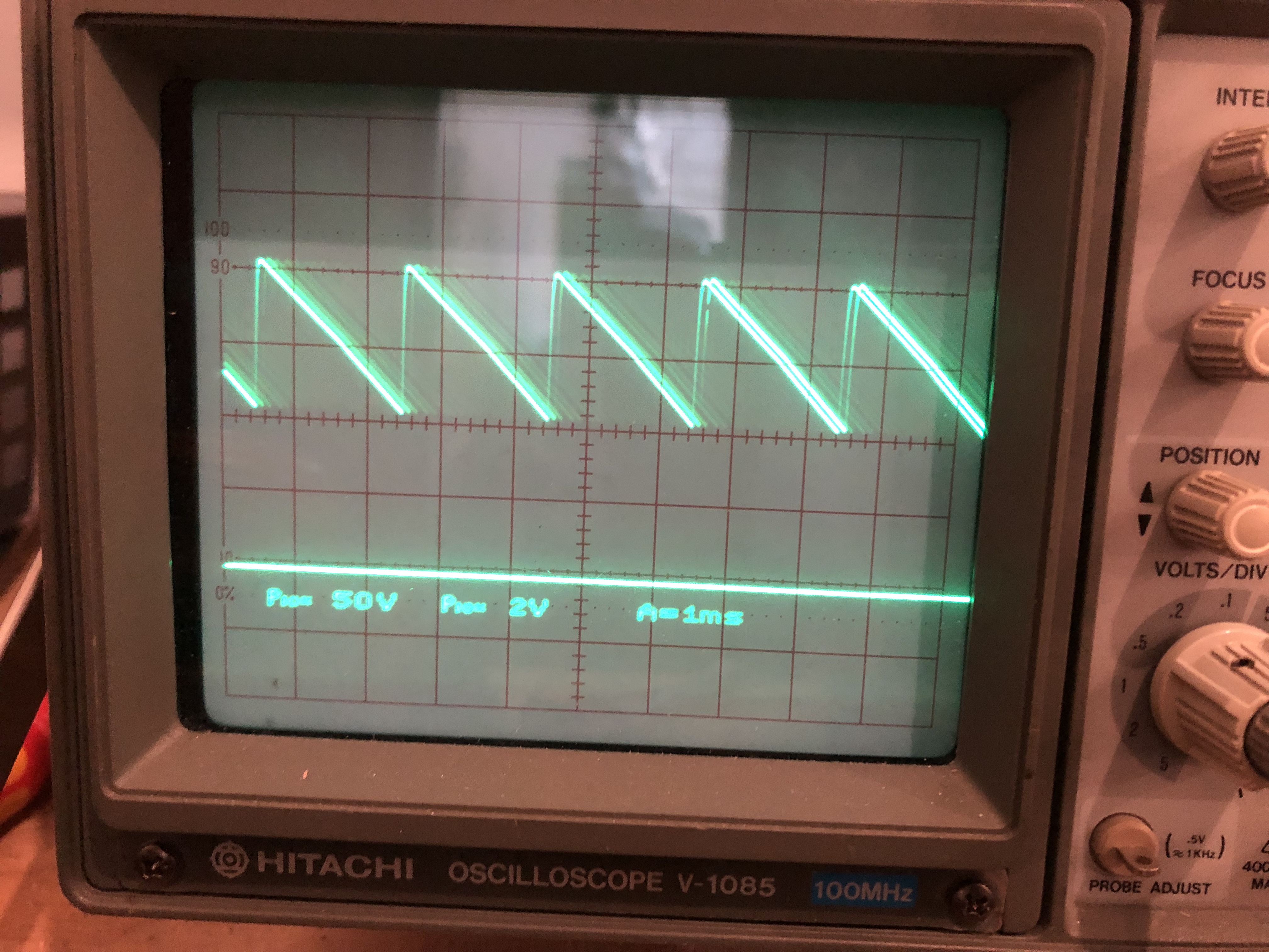

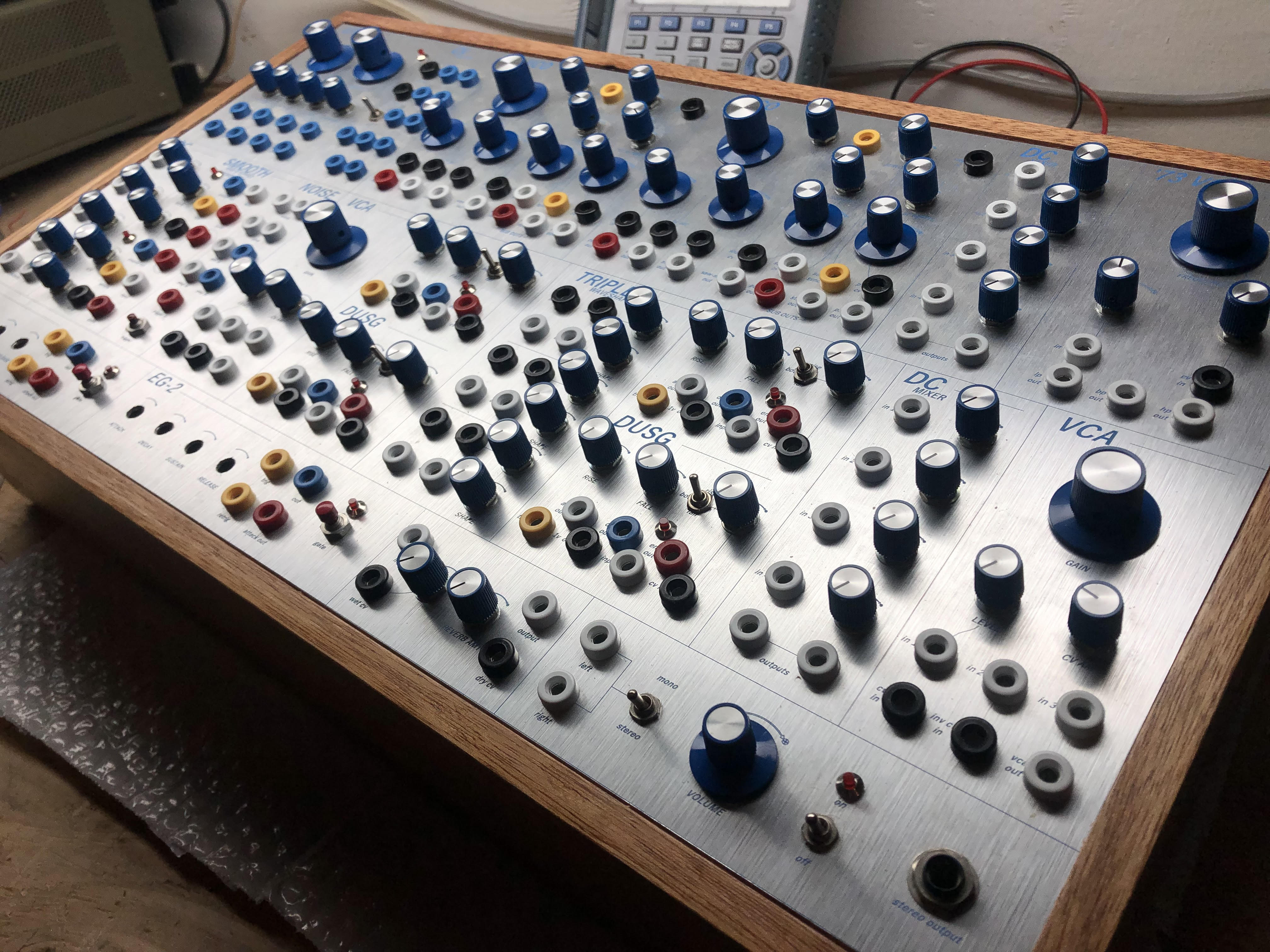

PostPosted: Sat Jan 23, 2021 8:11 pm    Post subject: Reply with quote  Mark this post and the followings unread
And it breathes its first breath. A nice crisp saw wave. Didn’t have time to do any calibration or testing before heading off to work, but so far it’s looking good. I realized I have an extra jack on my panel since I was under the impression that the oscillator had a dedicated square output that wasn’t affected by pwm. This isn’t the case so I may just throw together an additional saw to square converter just for that fixed square output.

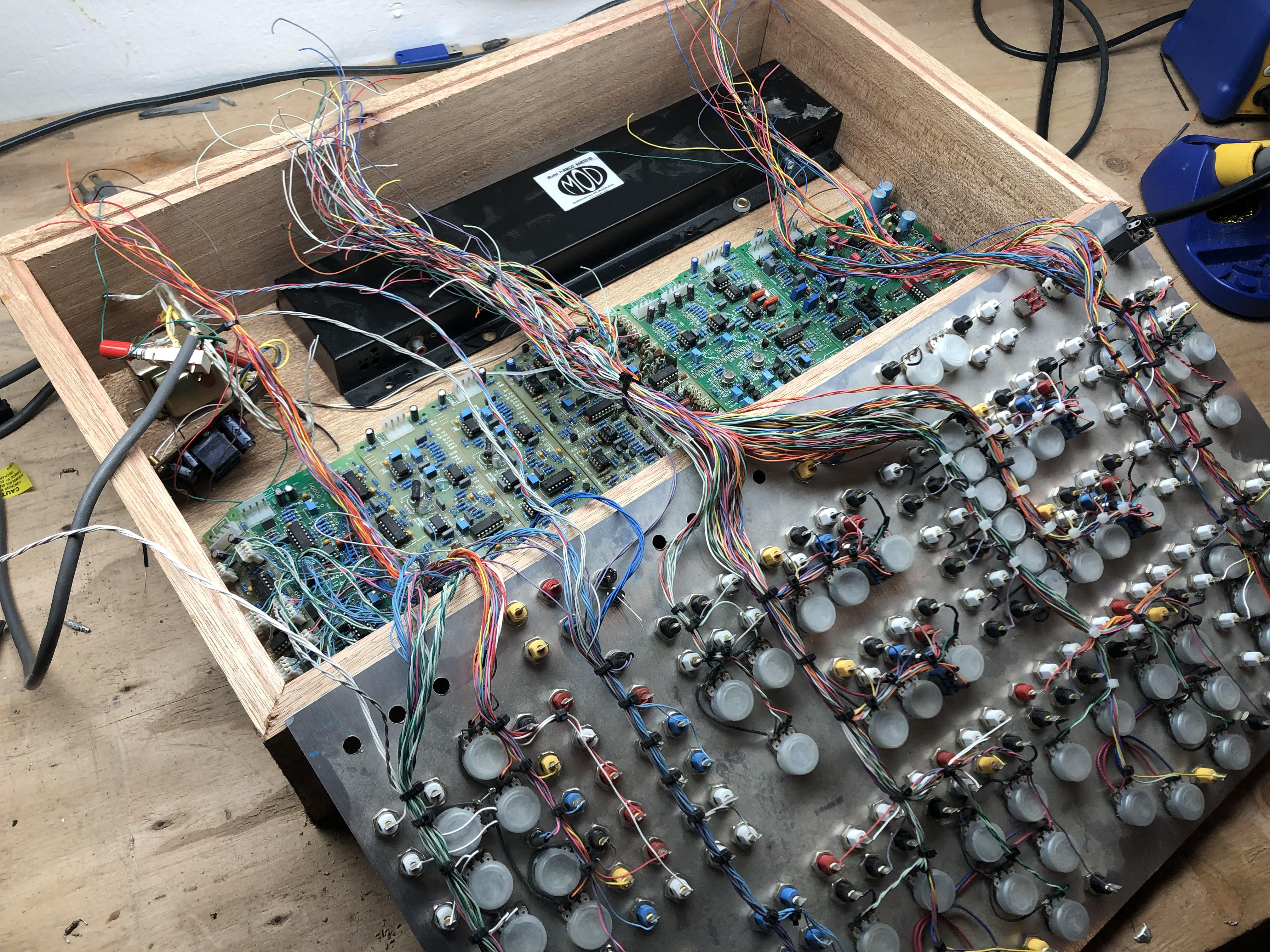

PostPosted: Sat Feb 06, 2021 2:07 pm    Post subject: Reply with quote  Mark this post and the followings unread
Knobs came in! Still waiting on those 2M ohm pots for the envelopes to come in alongside the connectors to start hooking up the modules to the power supply. The first DUSG I put together isn't working so I'm gonna have to do some troubleshooting later on and figure out what the issue is with that.

PostPosted: Fri Mar 19, 2021 9:23 pm    Post subject: Reply with quote  Mark this post and the followings unread
Thank you! It's been very slow progress as aside from other hobbies I have many projects within the synth and musical domain I'm going through all at the same time... but I have gotten a few more of the modules wired and tested. It appears I have some crosstalk so I'm going to need to get a better grounding and power distribution system in place, maybe alongside a better power supply too.
