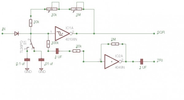

Hello, I'm looking into building a lunetta in a sort of standard modular synth kinda way, and I hope this question hasn't been asked a million times.
I'm wanting to build a 40106 based 6 oscillator module with a modulation input, coarse tuning and a square and triangle output, essentially the second module described here: http://dlbelectronics.com/lunetta
I'm not quite a genius at reading the schematic and then implementing it with the chip..... would anyone be willing to help me make sure I understand this schematic? Just understanding it a bit more, I understand where the mod in and the wave out are, where the pots are and the preamp for the triangle out but i guess I'm having trouble understanding where I would connect the pins of the 40106, I see where it is in the schematic but I don't know which pin I would connect or if I need to do anything else on the chip.
Sorry if this is a dumb question, this is a bit more than I'm used to.

I could do a whole write up about cmos chips and there are some guides floating around on this forum but I think
this page should get you started.
some basic info:
Never leave any inputs floating (unconnected) this also important if you don't use all the gates in one chip. Unused inputs
are often connected to GND but you could connect them to the positive rail as well, it depends a bit on their function.
Also connect small decoupling capacitors (100nF is pretty standard) close to the power input pin of every chip (often pin 14 or 16)
and GND. To understand how the chips function and how to connect them datasheet are really useful but can be a bit hard
to get into if you're a novice.
I don't know how much experience you have and what you know about electronics in general but I advice you to experiment
using a breadboard to get some understanding of how things function. Lunettas are a great introduction for getting to know
the basics. If you don't understand something, just ask. There are a lot of helpful people here especially in this section of the forum.
have fun on your journey Very Happy

hi Spookyandwhatnot,
You'll see on the diagram two weird shapes labelled IC1A and IC2A. They are the integrated circuit logic components. So IC = Integrated Circuit 1 or 2 is the chip number 1 is the first chip 2 is the second and so on. The last letter is the circuit within the chip so A is the first circuit, B the second and so on. Now you can look up the data sheet for a CD40106 and find the pin numbers for each circuit but you can see on the circuit diagram there are numbers near the left and right sides of the symbol so IC1A uses pins 1&2 and IC2A uses pins 2&3 (on a different chip). You will need to consult the datasheet to find out where the chip's power (VCC) and earth (VSS) are located. Also to locate any unused inputs for other chip circuits and follow Phobos' recommendations.
Enjoy!
Steveg
