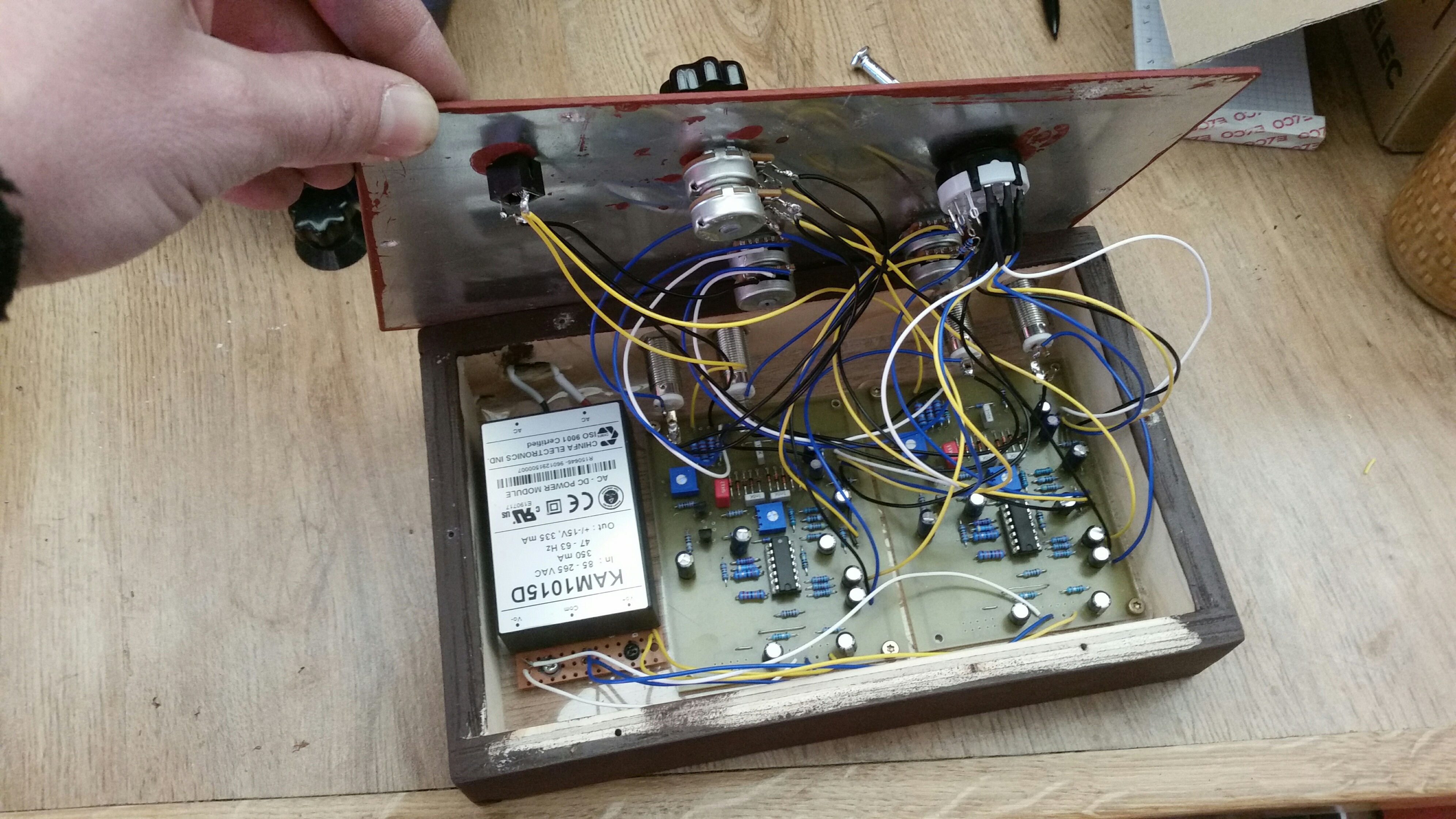

Hey Guys,
I've built a unit featuring two parallel Steiner filters provided by Yves.
Just tested the thing today and it sounds amazing !!
I wanted something like this for years and I so happy I did it, being able to run anything through a nice analog filter in stereo.
I know some products like this exist, but not so much actually.
I'm just having an issue having a hum noise at the usual 50Hz. It's not crazy loud but still too loud. I'm wondering if it comes from the power supply itself not being good enough, I choose something quite decent though.
Would anyone here be kind enough to help me trouble shoot that ?

I'd first try to move the power supply out of the box for a test to see if it is that.

and of course moving the power supply out of the box would be my first test to

Thanks for your answers.
Good call trying to put the power supply out of the box.
Just tried, it does improve the issue by about 10db already.
I was keen having the DC adapter in the box though.
Cheers for the other topic link, will try what they did there and report.

For your own safety take the PSU out of the box. It's absolutely dangerous with your metallic front plate and having it not grounded with mains earth.
What i also see as very critical/crucial for your safety is that there seems to be no strain relief on the mains cable, means if you pull hard enough perhaps the mains wire get loose and come in contact with the metal case.
Also a fusing the primary side should be included.
Really, for your own safety reasons consider to re-arrange that part.

You would also gain to use shielded wire for the audio connections (inputs and outputs and also for the connection to the rotary switch.

Took me ages to go ahead with this issue, but constantly tried to do a few tests every now and then. Thanks again for your previews messages and ideas.
As said moving the PSU out of the box wasn't miraculous.
Today, exploring some more and I was thinking that it could come from the wooden box doing some sort of antenna thing with the circuit compared to a metallic box where everything is more isolated from electro magnetism.
When I was moving the box away from the desk it was changing the level of the hum by a lot.. more than just shaking the cables around.
Finally, before putting all in a metallic box, I just put an aluminium plate under the box and wired it to the ground... bam, 100% of the hum gone !! me happy Smile
So definitely going to do that, put the aluminium plate inside under the circuits and wired to the ground.

Tweaked the trimmers to a balanced position where the side effects would almost disappear and where the filter range would be nice to me.
Then changed the resonance pot to the higher quality one I recently ordered... damn, looks like I'm going to be a happy owner of a stereo version of this filter now !! Keen to close the box and go to the studio to plug it and play around.
And to summarize the issues and solutions, I'd say from my experience:
50Hz hum noise : put an aluminium plate wired to ground under the circuit, especially if you do a powered version of it. I believe this should not happen in a modular setup unless your filter goes too close to the PSU.
Crackling resonance & DC levels on the output : High quality pots needed, tweak the trimmers where it would make this side effect go away. And check the previews posts where it shows a fix for older versions of the circuit. But Yusynth version should be fine already as far as I understood.
