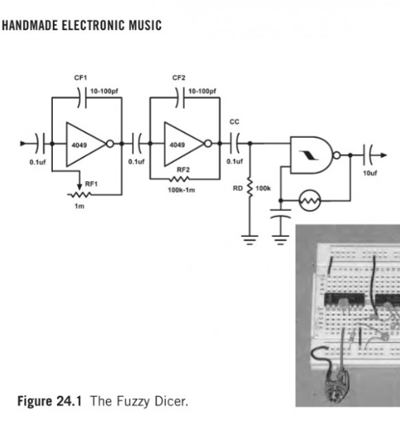

I've just ordered a few CMOS chips and I want some things I can use to affect a sound made with guitars/synths, so I'm wondering if there's anything out there that combines those two things.

Converting the guitar signal to a square wave will allow it to function as an on/off digital signal. Here are a couple examples from nicolas collins book, using a 4049 for tremolo and octave down. Cd4049ube would probably be ideal for guitar use. Tim Escobedo's PWM and Ugly Face would be another good example using a lm386 to square the signal. http://www.jiggawoo.eclipse.co.uk/guitarhq/Circuitsnippets/snippets.html
The MXR Blue Box used a cmos flip flop for the octave down.
As far as conventional guitar effects go tremolo, octave up/down, fuzz/distortion/overdrive and faux ring modulation would all be fairly easy to achieve with cmos ics.
