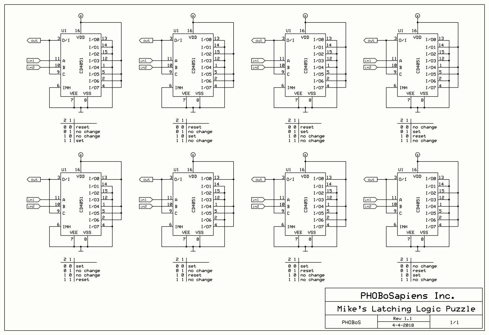

I need a 2 input, 1 output gate that does the following:
Output is low unless both inputs are high (like '&')
but stays high until BOTH inputs go low.
Some sort of flip flop or latch thing I recon but I havent as yet come across one that does the job.

It can probably be done simpler ... but when you'd use an SR flipflop you could SET it with the AND of the two inputs and RESET it with the NOR of those same inputs.

You need an RS flip-flop. Connect an AND gate to the Set input. Connect a NOR gate to the Reset input.

PostPosted: Wed Apr 04, 2018 6:48 am    Post subject: Reply with quote  Mark this post and the followings unread
I haven't tested it but this might work Cool
two bits enter, one bit leaves

PostPosted: Wed Apr 04, 2018 7:17 am    Post subject: Reply with quote  Mark this post and the followings unread
That is an elegant little solution!! Love it!
will it send a second pulse as input c gets triggered?
maybe a cap and resistor on the output could solve this if its an issue.

PostPosted: Wed Apr 04, 2018 12:56 pm    Post subject: Reply with quote  Mark this post and the followings unread
Congratulations Moonbase! It works...

PostPosted: Wed Apr 04, 2018 1:49 pm    Post subject: Reply with quote  Mark this post and the followings unread
Very Happy awesome (took me a minute to figure out I should not be looking at the flashing red and green lights).
btw. nice modules!
Might be useful in the future and I think there are some variations possible where it works with inverted inputs.
so, what do we call this latch ?

PostPosted: Thu Apr 05, 2018 4:03 pm    Post subject: Reply with quote  Mark this post and the followings unread
I drew up the variations as well.
 Filesize:  122.24 KB
 Viewed:  222 Time(s)

ha nice! now you need to do all the permutations for a 4067 based latch Twisted Evil
Posts: 5881
PostPosted: Fri Apr 06, 2018 4:34 pm    Post subject: Reply with quote  Mark this post and the followings unread
Laughing
Does make me wonder, you could combine any 2 of the above variations but also do something else like choose between
latching and non latching states.

Just saw this thread and I would do it just like Blue Hell and SteveG said. It can be done with just one quad NAND IC (4011 or 4093) if you use one NAND to set and the wired-OR to reset the RS-FF from two NANDs.

I got it to 4 x NAND and 4 x Inverters in 2 chips but I thought PHOBoS' solution was easier.
