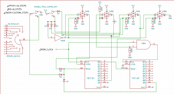

Been pulling my hair out trying to solve this Mad
I've got two 4017's chained to create a 16 step sequencer as per the datasheet. Theres a 16 position rotary switch used to change the sequence length from 1-16 total steps.
Been trying to add a 3 position switch which will allow 3 states:
1. Default to 8 steps
2. Default to 16 steps
3. Sequence length set by rotary switch.
Using a double pole toggle switch (on - off - on).
It's working OK so far except there are two glitches:
1. When in '8 step' mode, if I switch to 'rotary' mode when the sequencer has already passed the step set by the rotary, then the sequencer carries on to 16 before switching to the custom sequence length set by the rotary. (i.e it misses its chance to reset and carries on until the default reset after step 16)
2. When in '16 step' mode, if I switch to '8 step' mode during steps 9-16 then the sequence instantly jumps to step 1 which must be triggered by pin 9 of 4017#1 being held high during steps 9-16. (In 8 step mode 4017#1 resets on pin 9)
What I'd ideally like is for glitch 1 - to reset after 8 steps first
And for glitch 2 - to finish the full 16 steps first
Hope any of this makes sense! Laughing Schematic attached.
Any suggestions whatsover are welcome
 Filesize:  20.5 KB
 Viewed:  572 Time(s)

Does it work correctly when using only the rotary switch to select sequence length? That is, do the 8 and 16 glitches stop in rotary switch mode?
If so, then why not eliminate the 8 and 16 switches and just use the rotary?

I will look into it but at first glance I noticed a couple of things:
- pin 1 of the 4069 should have a pulldown resistor
- pin 15 (reset) of 4017 #1 should have a pulldown resistor.
- pin 5 of the 4066 is always high.
- there are a couple of unnecessary diodes.
There also seems to be something wrong with the way the 2 4066 switches are connected to pin 13 (CLKEN) of 4017 #1

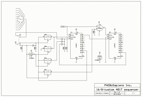

I haven't really looked into how and why it works/doesn't work but I cleaned up the schematic a bit.
I am pretty sure U3b can and rather should be discarded. It can probably also be slightly simplified with a mux.

I think there might be one or more errors in the schematic you posted as I don't see how the 8/16 step modes could work.
