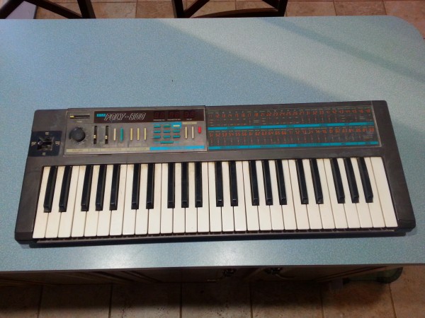

Went to the dump today. While unloading recyclables, I noticed a keyboard in one of the electronics recycling bays. Curious - and thinking it was surely a Yamaha PSR or a Casio someone tossed - I walked over.
Nope.
It was a Korg Poly 800.
You're not supposed to take things out of the dump, but nobody was around, so screw it, I took it.
No idea if it works yet. I need to find a power adapter, or put in some batteries. There's a bit of rust around the battery cover, so I'll have to inspect that more closely.
I assume it was tossed because it doesn't work, but you never know. If it doesn't, maybe someone here would like to take it and fix it - and keep it.
More to come as I find out!
Korg Poly 800, rescued from dump

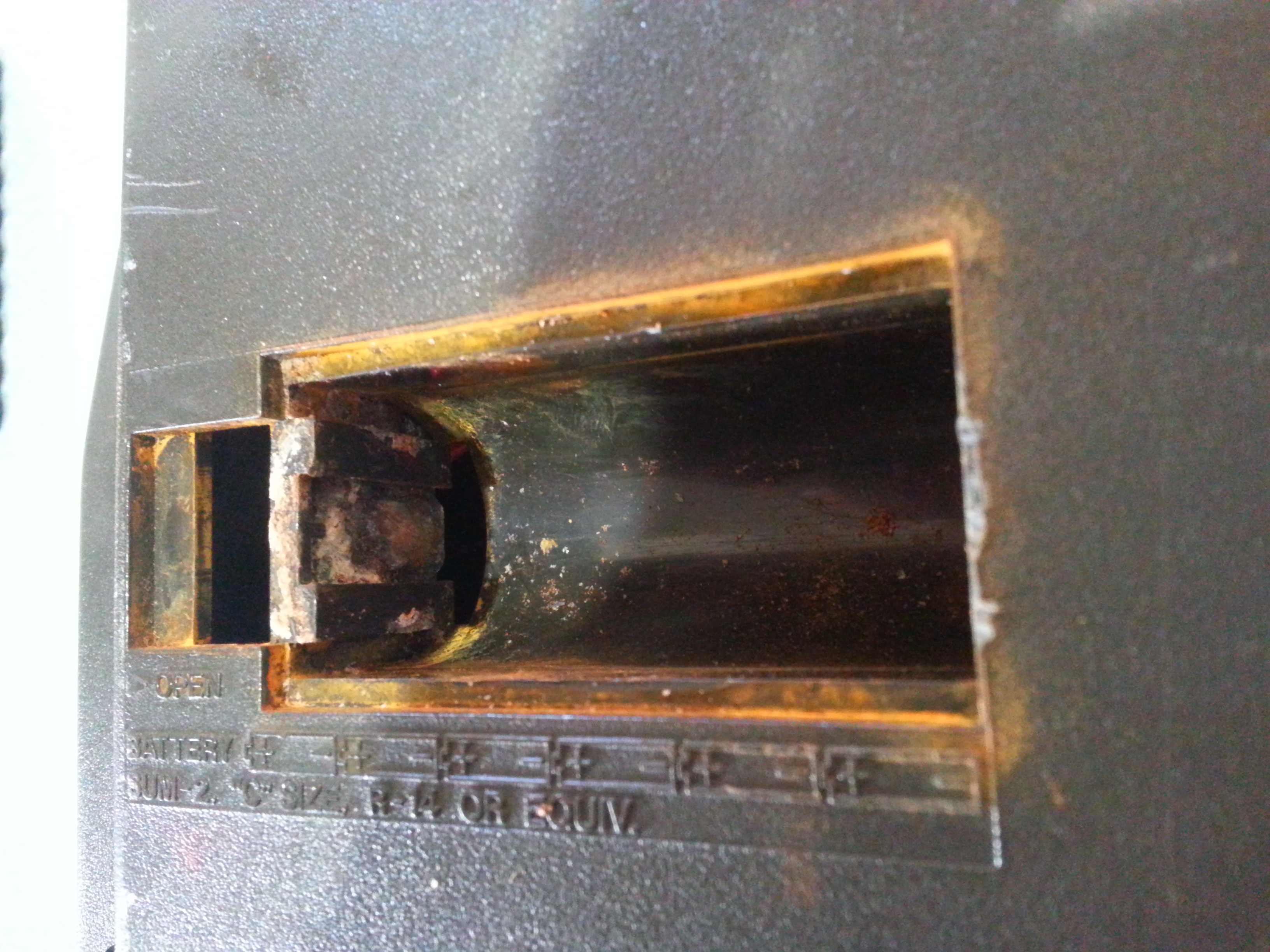

So I opened it up today. It looks like someone left a couple of batteries in there, which leaked. This is the apparent reason for its trip to the dump. I'm hoping that's all it is, because this can be easily fixed.
I just need to unscrew whichever board the RAM battery is hidden under so I can replace that - maybe a la the video Alan linked above.
Not a good sign.

I removed the corroded spring coil for the C cell batteries on one end. Now I'm trying to remove the plate on the other end. Using the flash on my camera shows just how bad it is. It appears to be inserted into a plastic slot. It's possible glue was involved, but I'm hoping it's just rust that's making it stick.

Gave up on trying to repair the battery terminals and ordered a PSU. Should arrive within a week, and then I'll know if I have a working instrument.

(vinegar can be useful for cleaning up battery corrosion btw)

It occurs to me from looking at the zoomed-in photo that I could clip the wing off the current terminal plate and find one that I can bend over the old one, then solder the wire onto the new one.
