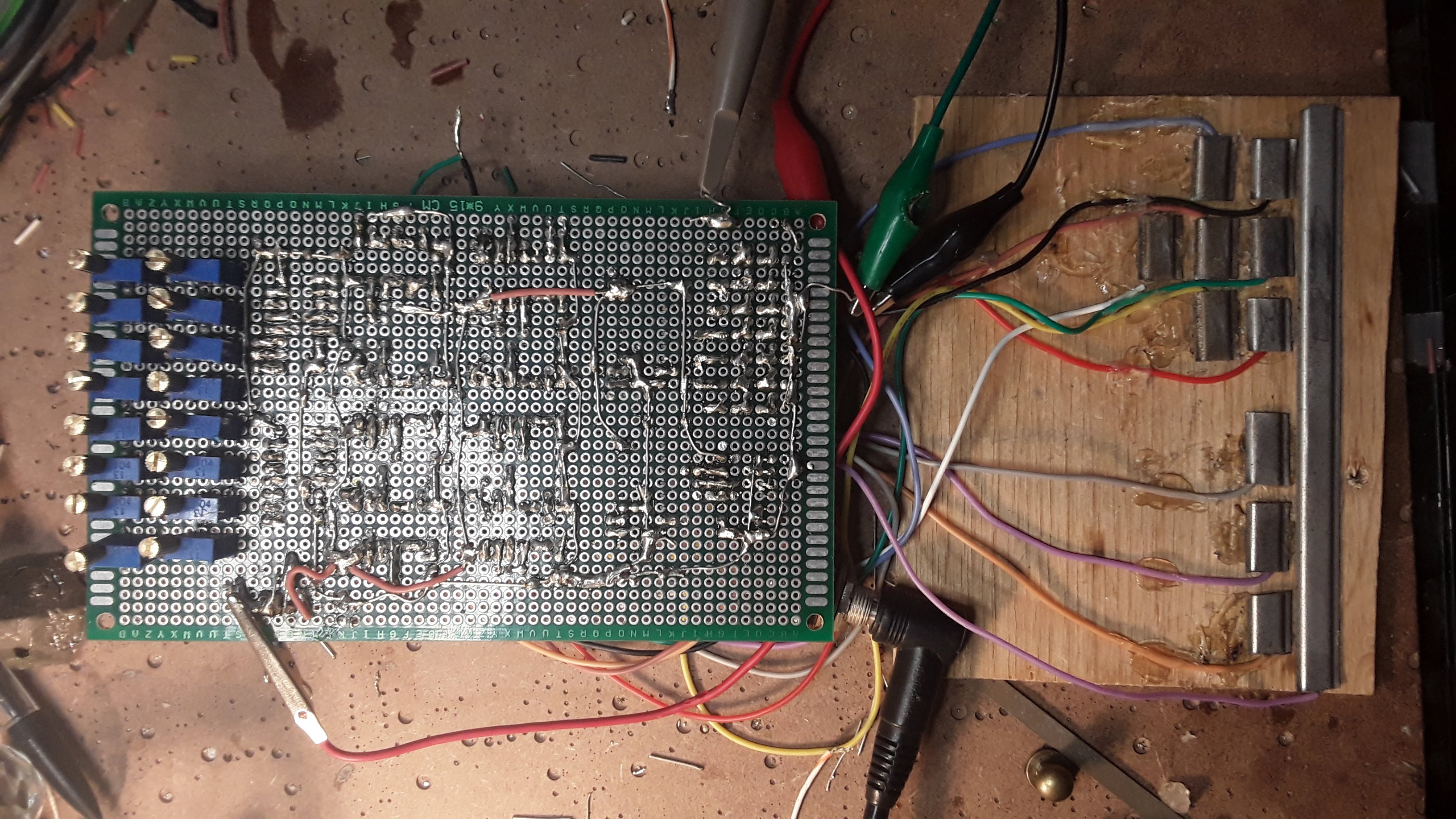

This is two 40106 oscillators, with frequencies switched to harmonically tuned notes (roots and thirds) via 4051 1 of 8 switches. 4040 provides divisions for lower octaves. Not shown in the video, but I also added a 4070 faux ring modulator, cross modulating the two tuned 40106 oscillators, for extra fun.
I came up with a basic 40106 touch sensor circuit using 3 inverter gates, which I am still refining a little bit for reliability (I found it works better when my feet are on the concrete floor of my workshop, even with shoes on! so it is probably a grounding contact issue). Can post a schem if anyone is interested in that part.
The signals are gated with a two diode "VCA" for each octave with a square gate from each touch switch. One thing I am getting that I am not crazy about is a big pop when switching those VCAs on, and another when switched off (positive spike at the start, negative spike at release). I'm going to try resistors between the touch gates and the VCA CV inputs, as right now it's just straight from the 40106 outs.
The touch plates are just a temporary test thing, and you can see below that I've cleaned them up a little bit. Once I get all the kinks worked out, this will eventually go into some sort of pretty looking box for use as a performance device.

I actually like the sound of the clicky attack as it comes across in that video, but it got a bit much with lots of fast key action. It also sounds worse direct than through a mic like in the video.
I refined the touch sensor a little by adding ground contact, and eliminated the click for the most part by putting a 10k resistor between the gate output and the "VCA" CV input. Oddly, that also brought up the level of the audio from the oscillators and dividers. I have a bit to understand about how those two diode VCAs are actually working I guess.

Yes, left hand basically selects a chord position, 1 through 8 (combo of two tuned notes) using 3 bit selection, and the right hand gates what octave(s) of those two notes will sound.
If you think of it like a guitar (sort of), left hand selects chord position and right plucks the appropriate strings.

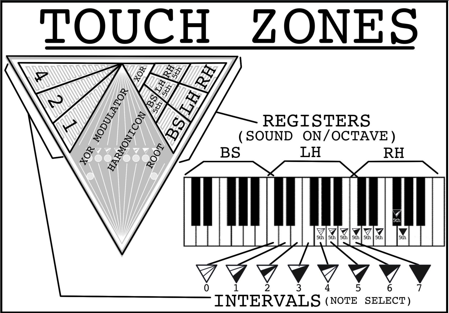

Anyway, this one, I made some alterations to the version earlier in the thread to simplify for the production version. The production version only has one set of tuners, and the "harmony" section is limited to generating 5ths, whereas the prototype version had completely independent harmony tuning. I've also simplified the touch sensor circuit down to only a single 40106 gate per touch plate.
In the finished version I also used 4016 analog switches to activate the octaves, instead of the diode VCAs shown here.
I also added a pair of bandpass filters using 4069UB gates, and using LDRs for modulation (demonstrated in the video below). The filter is not shown in the schematic. It's a twin T bandpass.
I've attached a draft schematic. It is possible there are errors in it. I don't actually have a finished schematic of the product, but this gives a ruff idea of how it works. There is an oscillator (with 8 note selections via trimpot tuners selected by a 3 touch plates switching the 4051 3 bit input) which goes into a 4040 octave divider, and a 4017 divider to generate 5ths. The 5th division also goes through an octave division. So you can select three octaves of each the root note and 5th harmony.
Also included is a page from the manual to show how the touch plates are laid out and how the touch plates apply to the tuners.
If there are other questions, I'm happy to answer, otherwise I'll save myself some typing and leave it at that.
