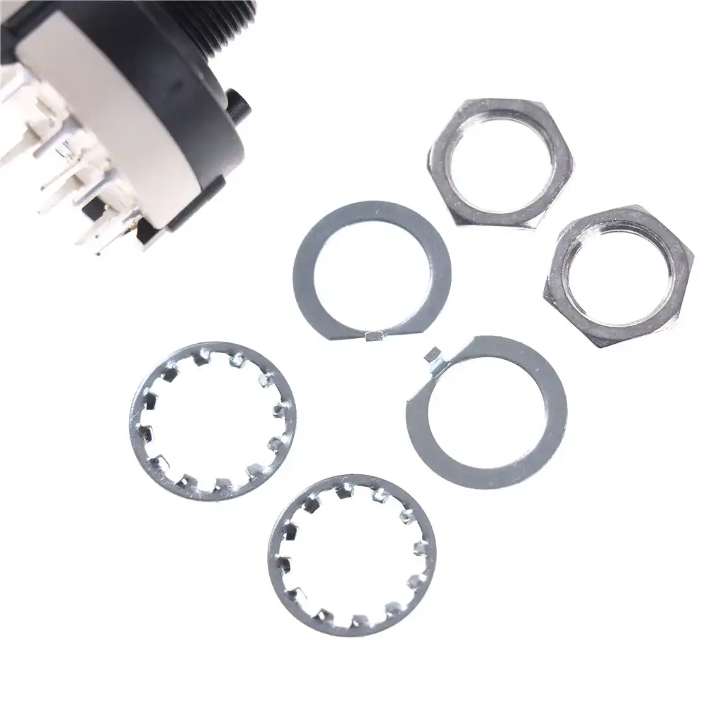

I am trying to make an old school, analog VCO.
One thing I want is to have a switch that selects octave, so, each step of the switch provides +1V more than the last. SH-5 roland VCO for instance.
I am trying to figure out the best rotary switch for that. Alphas are everywhere:
https://www.mammothelectronics.com/collections/rotary-switches/products/alpha-2-12-position-rotary-switch-with-pc-mount
https://www.mouser.com/ProductDetail/Alpha-Taiwan/SR2612F-0112-21R0B-D8-N?qs=yA6kp8fx8Y7S2TB5GvzfgQ%3D%3D
The alphas look interesting, and they say "Adjustable for 2-12 Positions"
Does anyone know how you "adjust" that? I assume (!!) that means I we don't have to use all 12 positions. So there is a stopper or something to keep the thing from turning past say stop #6.
Or do they mean, just don't wire up all 12 positions, and hope your user doesn't select something that doesn't do anything?

They have a metal ring with a little tab (which is the end stop) that you can place in different positions. let me see if I can find a photo,..
this will have to do for now:
I'll see if I have one laying around and take some photos.

as pointed out before… there is this ring to adjust the steps… but with this Kind of switches i usually have some Problems as the stopper often refuses to work correctly at mine… you have to ensure that the switch is connected tight and proper to the Panel or otherwise make sure that the stopper canÄT slip out of it's Position, otherwise it will rotate into positions that aren'T used…

For that type of rotary, I usually have some masking tape holding the stopper ring in place Smile (not the low tack stuff!)

Thanks All, I got the rotary switches from Banggood and beeping them out, they seem fine.
So far the little stopper thingys seem to do the trick so I can constrain it to 5 clicks or whatever.

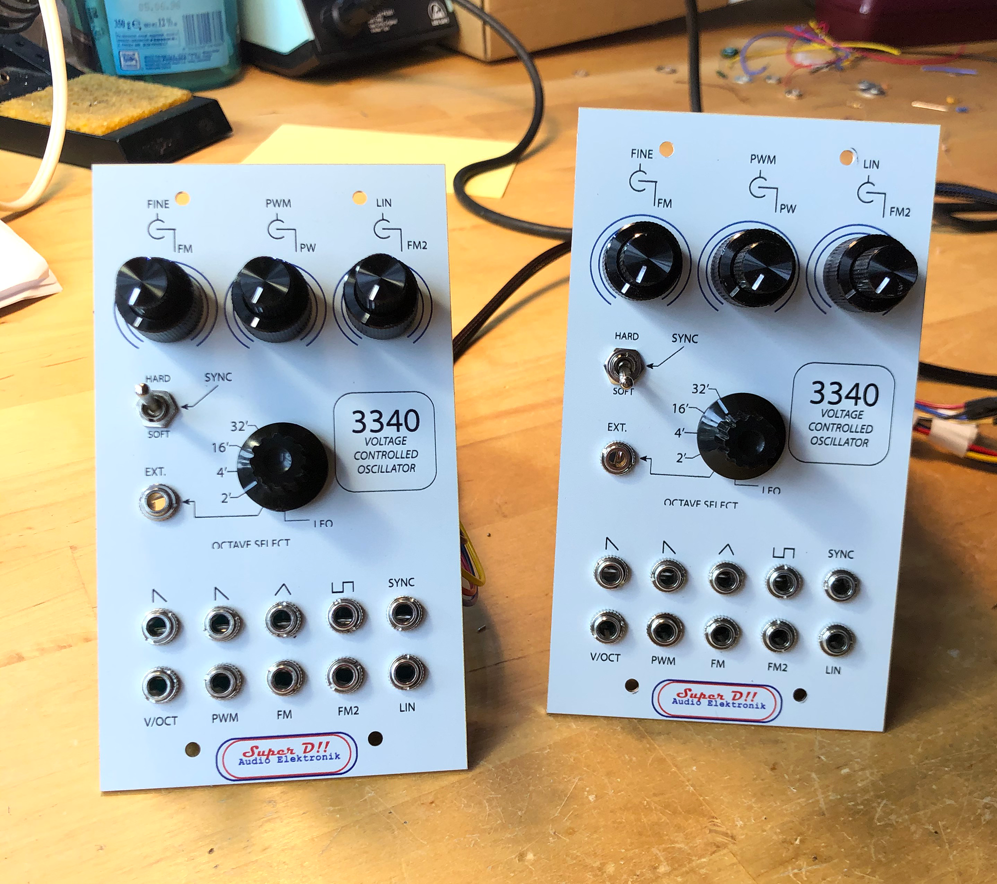

PostPosted: Thu Jan 23, 2020 11:19 am    Post subject: VCOs and switches are done (finally)
Subject description: Thanks all for the help and advice. The V/oct switcher seems to work well so far.
https://audiodiwhy.blogspot.com/2020/01/3340-vco-finished.html
Ended up using 4x SMD .1% resistors in array and 1 extra high performance SMD, but the 1 extra wasn't needed at the end of the day. Also used a pretty expensive NKK rotary switch as the Banggood switch kept melting (should have used a lower solder temp??)
Also, if I were to redesign, I'd try to figure out how to trim the REF02 IC 5V chip, but it's time to move on.
Thanks again all. As usual, great advice, ideas, and support.
