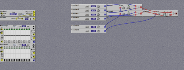

Thank you for the quick reply!
So on the right I recreated the multiplexer as it is described and displayed in the modular book.
On the left I put the clock (instead of a trigger right now) and the clock divider and two sequencers.
What would I need to replace the constants with? The sequencer outs?
Also: Whats a demultiplexer and how do I build one?
I got into all the synth stuff really quickly but those logic modules are giving me a headache Shocked
