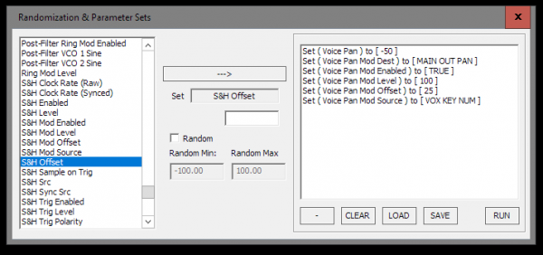

Thanks for sharing! Nice tip Smile
p.s!
For anyone with my Andromeda Editor, I actually got around to implementing my idea above, "Parameter Sets" !
And also added the ability to constrain the Randomization with "Min"/"Max" values -- check out the screenshot attachment Smile
