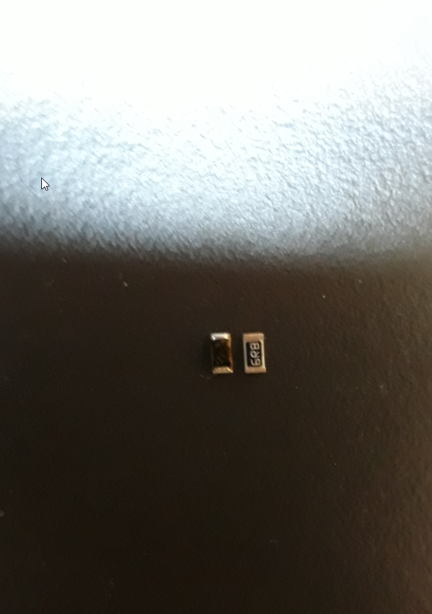

Here is the old scorched resistor and the new one, side by side.
I used SMD 6R8 1206. I´m not totally sure is this the right one, but at least it fixed the problem and hopefully last that way.

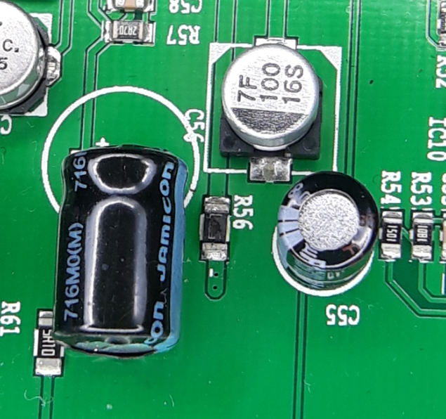

One close up picture of the resistor, how difficult the place is. You have to use fairly small soldering iron, that you don´t hit the capacitors which are very close to that working area.
Desoldering and soldering SMD parts can be tricky, but luckily there is good videos about it in Youtube.
