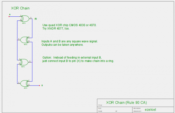

I could have sworn I already posted the XOR Chain circuit on the forum before but I can't find it, so I'll put it here. I found it years ago from the long-defunct The Sound of Logic forum (I think) on a different site. It was by ezekiel and implemented the cellular automata Wolfram rule 90.
There are loads of "fake ring modulator" using XOR circuits out there.

Rule 90 is a nice one Smile

yeah, I've seen that XOR chain before and hardly ever visited the Sound of Logic forum, but might have seen it there.
Another thing XORs are useful for is as a controllable inverter. Send a (digital) signal into one input and if you make the other input
high it will act as an inverter, otherwise the signal will pass straight through. If you add XORs to the outputs of a binary counter you
can use this to change the count direction (up/down).
