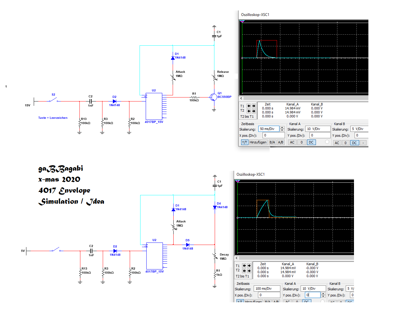

Hi Guys,
find attached an idea/simulation for an envelope using a 4017.
probably there has to be added something to the clock-inh pin?
