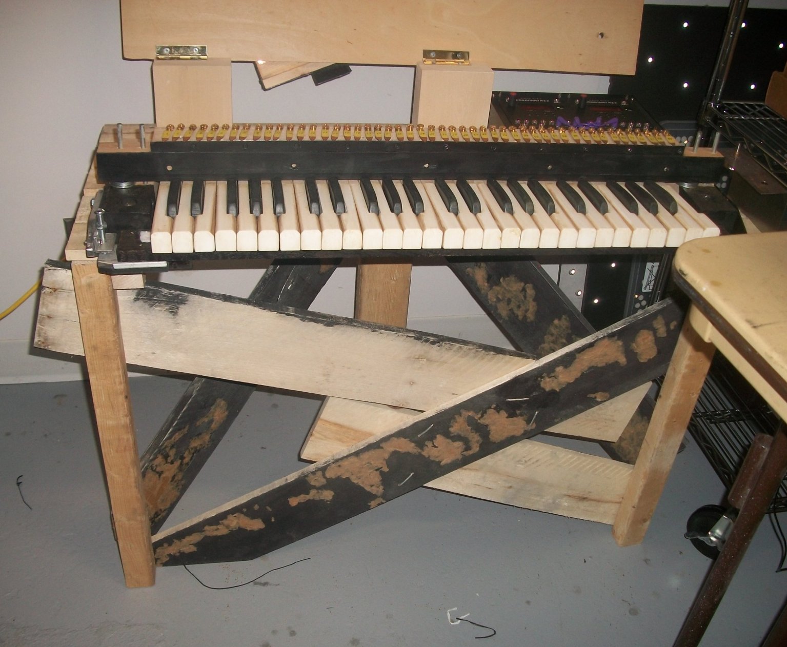

So far, I have been working on the keyboard, which has proven to be a mechanical challenge.
Here's the original 49-key keyboard. The 100P resistors that form the ladder are connected underneath to the heads of the bolts sticking up. The hex nut provides continuity between the bolt and the numbered copper strip, as well as securing the copper strip. There's a hole just under the tapered end of the copper strip. A piece of wooden dowel pushes the end of the copper strip up and away from the edge of the steel plate that forms the ground bus. When you press a key, it lowers the dowel, allowing the copper strip to contact the ground bus. It seems an unnecessarily complicated system, but hey it was the very first, so we can cut the guy some slack.
https://i.imgur.com/9OUEsUN.jpg
Here is the keyboard structure I'm working with.
https://i.imgur.com/4RMIf2A.jpg
https://i.imgur.com/zKSNRPY.jpg
As you can see, pretty accurate. However, I'm having difficulty getting decent continuity between the resistor ladder, copper strips and ground bus, so we are experimenting with different fixes at the moment. I can let you know what they are as we perfect them

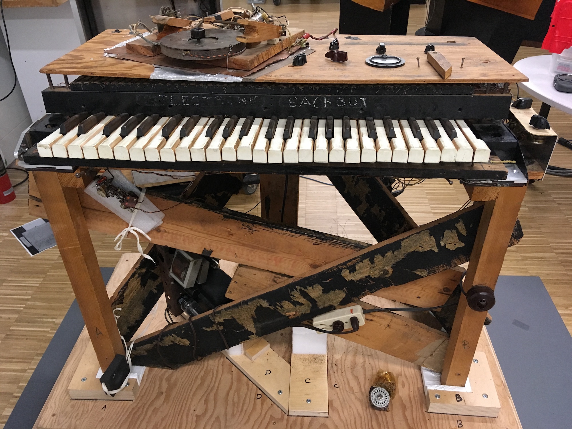

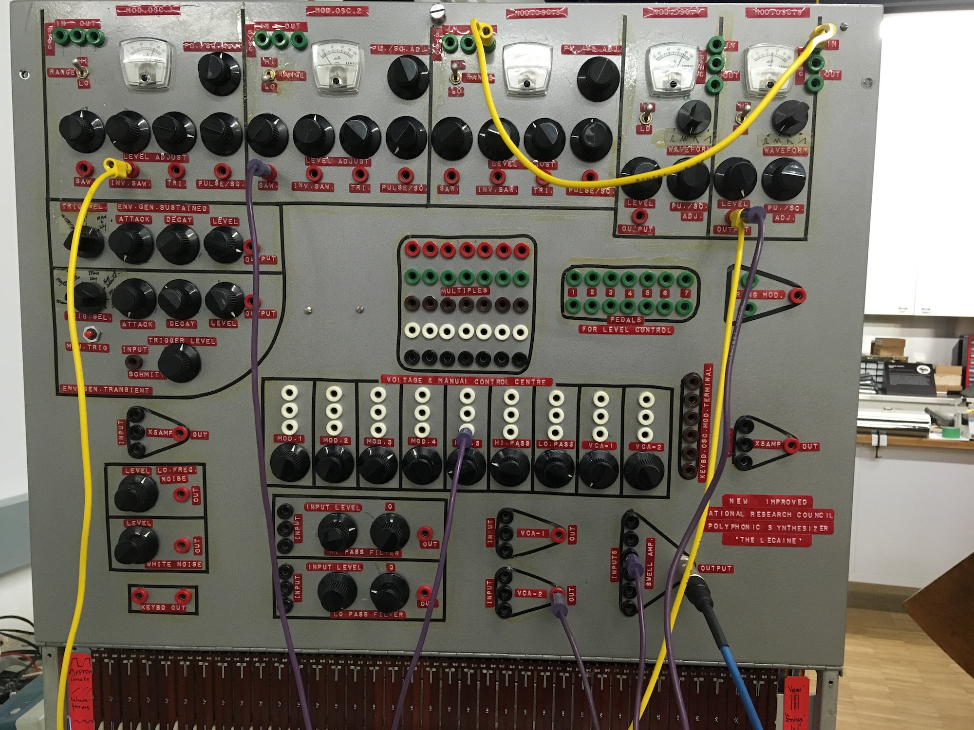

Here is the replica I'm working on, a front view of the second-generation synth from LeCaine, (which was polyphonic), and finally the inside and full view of the original (which the "sackbut blues" was played on). Note that the keys on the original and replica are bevelled at the sides to permit sliding one's finger up and down, as well as being able to apply lateral pressure on the keyboard. There was a striking amount of expression control in this thing. It may have been crudely implemented, but I'm impressed that LeCaine was thinking about it so far back.
I spent most of today setting up the keyboard. The copper strips had to be individually bent to within a tiny gap with the ground bus, such that pressing the key allowed them to make contact with the bus. The use of springs as movable contacts in later-generation keyboards worked much better, but I guess 1945 was gonna 1945!

Your replica is eh .. very much the same Smile
Thanks for explaining the key beveling ... I had been wondering already!

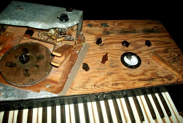

Sadly, while there are photos of him at the sackbut, and audio recordings of him playing it, there is no film of him playing it, nor is there a complete schematic of it. So some of the controls and what they are intended to do are not well understood. But it was very much an instrument oriented towards expression control, such as could be imagined in the late 1940s. t had portamento/glide, and the user would play the keys with the right hand and operate the expression controls with the left: one with the ring finger, another with the index, and the third with the thumb. The disc you see here was divided into quadrants which the user would/could rotate with their finger to alter the waveform.
While the aftertouch on the keyboard utilized a mechanical contact which had to be adjusted to leave a sort of hairline gap that added downward pressure could close, we'll be using force-sensing resistors. I have to emphasize I'm just a "hired hand" and not the brains or instigator behind the project. I'm just a huge fan and pleased to be associated with it.
