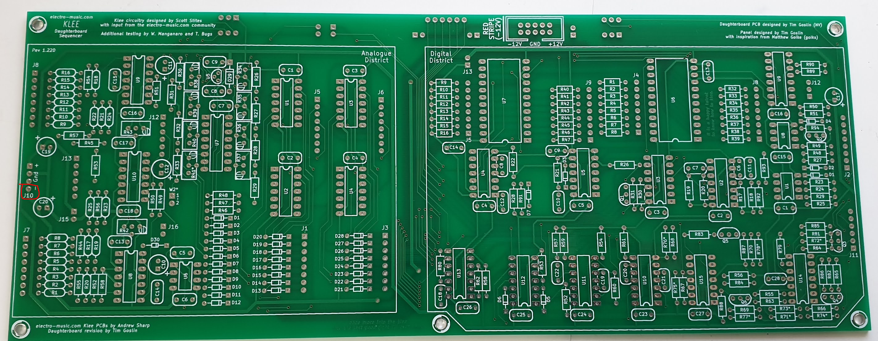

i've attached a photo of the klee analog board to show which pin i'm attaching the ground terminal of my multimeter to at j10 (i've circled this in red). if this is incorrect then which would be the correct pin?
sorry for the confusion and thanks again for your help.

I'm sorry .. where i said J11 in one of my last posts that was meant to say J10 ... and then I felt a sudden urge to make a copious amount of chocolate mouse Rolling Eyes
Anyway, you are using a wrong ground reference, you are using pin4 on J10, or the -12V as a reference where you should use ground as a reference. This was what I was affraid of, and what I was trying to explain.
Ok, again :
The ground to use is on pin 2 of J10. So move that current connection for the black meter terminal two positions up (in that image you posted).
It is (as one of the two connections there labeled as gnd) AGnd, and it is pin 2 on J10. AGnd stands for analog ground.
Then try your calibration again - and when you still can not set the voltage to zero on pin 1 of U8, there is something else wrong too.
In fact, where you were measuring 12V that was with respect to the negative supply voltage, and so in fact, in respect to ground, it was 0 Volts. It is customary to measure voltages with respect to ground, and ground is not the most negative supply voltage in a dual (or multiple) supplied contraption - but it is the reference - and in cas of the analog ground the reference for analog signals.
The other ground is the reference for digital signals. Nominaly they are the same, but the digital one is dirtier usually and could add unwanted signals to the analog bits of the circuit.

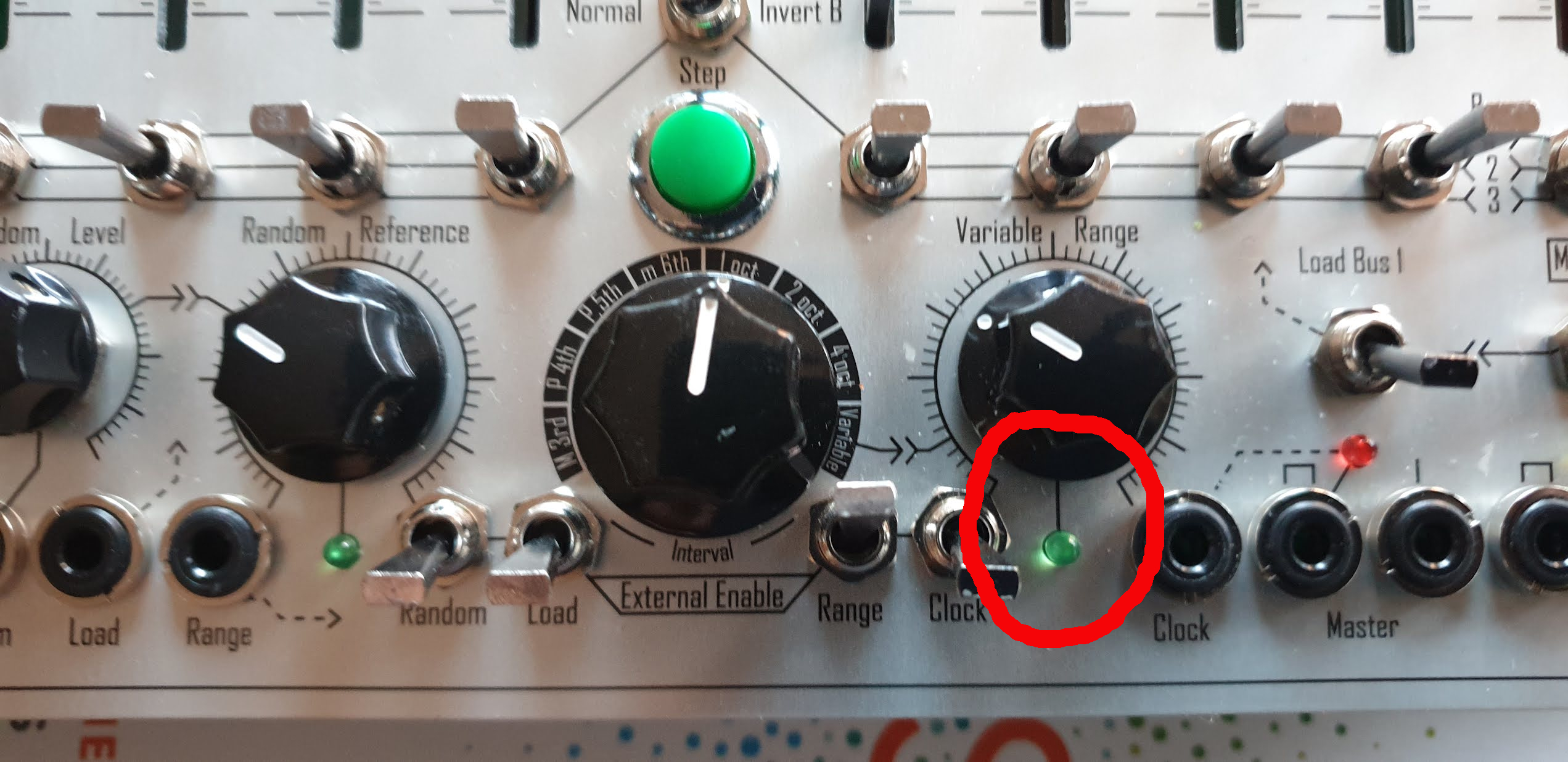

i'm attaching a photo of the front panel with the led i'm referring to circled in red.
thanks
 Filesize:  1003.85 KB
 Viewed:  108 Time(s)
Posts: 24513
PostPosted: Tue Jan 28, 2025 2:43 pm    Post subject: Reply with quote  Mark this post and the followings unread
So .. it has no refdes (like D25 or whatever it is ...) and it is not in the schematics?
Where it is on the panel - without any text - tels me nothing, It does not exist Laughing

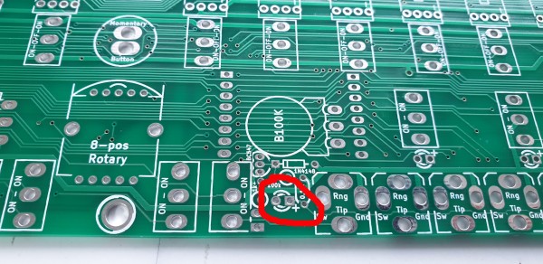

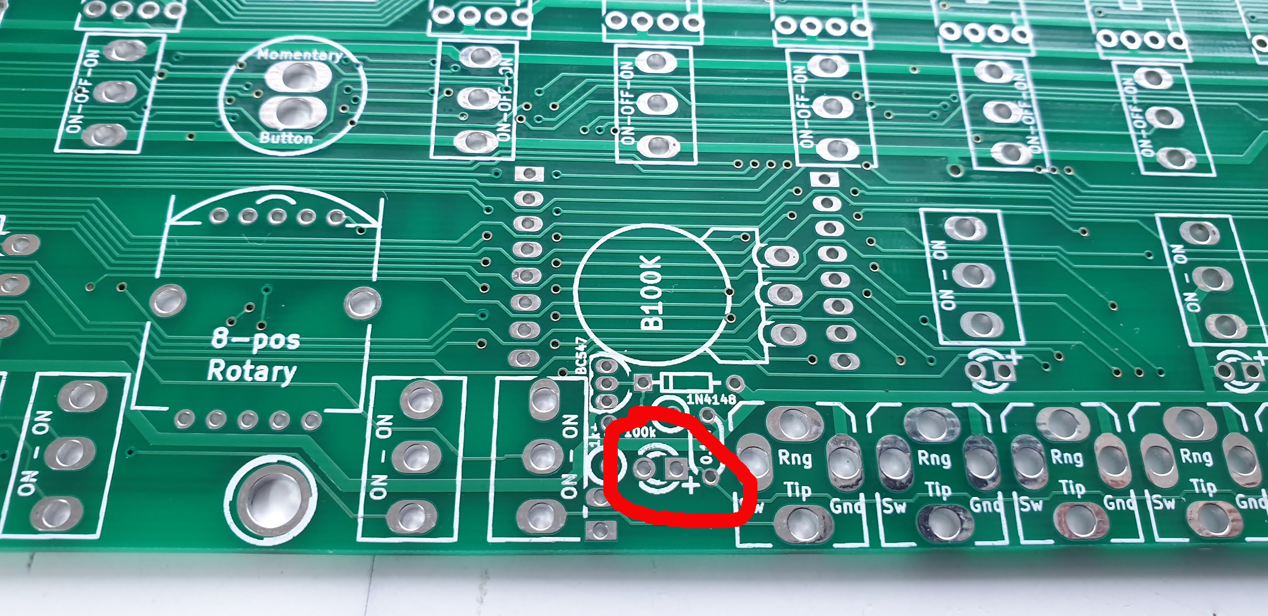

yes, i see what you mean. even in the bom for the front panel, there is no reference designator for these led's.
for what it's worth, i'm attaching another photo with the position of this particular led on the pcb.
thanks
 Filesize:  1.9 MB
 Viewed:  135 Time(s)
Posts: 24513
PostPosted: Tue Jan 28, 2025 3:23 pm    Post subject: Reply with quote  Mark this post and the followings unread
Ah, so it is not the electro-music klee but an undocumented unofficial modification by synthcube .. there is some bla bla in their build manual but it does not say what it is and how it works ... or even why it is there Evil or Very Mad
They bloody should provide schematics.. but i can not find it.
Anyway, 1k seems a bit low .. is all i can say . amounting to over 10mA worst case .. depending on how it actually is connected ..
Old fashioned leds could handle that, not sure about the modern high efficiency thingies .. the led's data sheet will have to tell .. but eh .. probably undocumented what it is eh .. so impossible to look it up then Laughing
