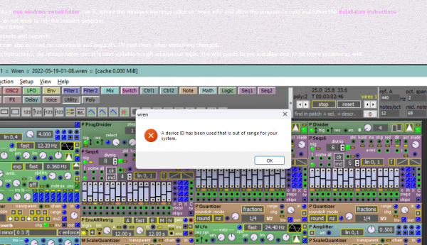

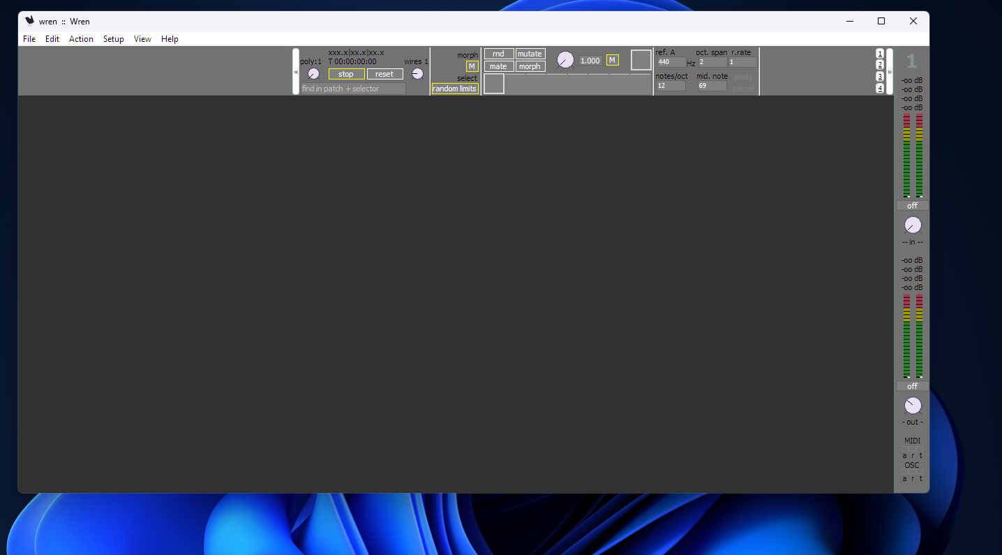

At first run i have error: A device ID has been used that is out of range for your system.
 Filesize:  751.4 KB
 Viewed:  60 Time(s)
 Filesize:  197.61 KB
 Viewed:  48 Time(s)
wren.log
 Filename:  wren.log
 Filesize:  11.82 KB
 Downloaded:  37 Time(s)

PostPosted: Thu Jul 03, 2025 4:53 pm    Post subject: Reply with quote  Mark this post and the followings unread
Could there be an issue with a selected audio device?
It is not really clear to me from the log file.
The screens you posted suggest that an error is generated when an audio device is being opened.
And that you then click away tat message, on which wren produces a boring look without a patch and without modules.
Am I interpreting this corrctly?

PostPosted: Thu Jul 03, 2025 5:23 pm    Post subject: Reply with quote  Mark this post and the followings unread
This error pop up on start but when i click ok wren starting.
I can set audio settings to asio and general settings without problem.
I can run audio engine but there arent any modules. Palette of modules is empty.

Looks like setting midi crashes then ... that is one of the first things tried on setting up [and does not generate proper error messages].
As your wren.ini is being saved .. you can try to set up midi from the menu, settings ..
then exit wren and restart it ..
if that does not work .. i'd like to see your wren.ini file ..
and maybe you could have a look at the section [FormMidiSelect] to see what the MidiInDeviceName and the MidiOutDeviceName are ... and if your sustemhas those devices.
boaone
Joined: Nov 06, 2019
Posts: 53
Location: Warsaw
PostPosted: Fri Jul 04, 2025 11:59 am    Post subject:   Reply with quote  Mark this post and the followings unread
Thanks a lot for help. Now its working.
Yes...that was some problem with midi like you point out. I didnt have any midi devices or midi ports on laptop.
so i installed loopMIDI virtual midi port and everything working again modules are present and config settings saved properly. Cool Smile
So for future if anybody had same situation on windows 11 X64 laptop
without proper audio interface:
I used free KoordASIO for ASIO
and loopMidi virtual midi port for midi.
