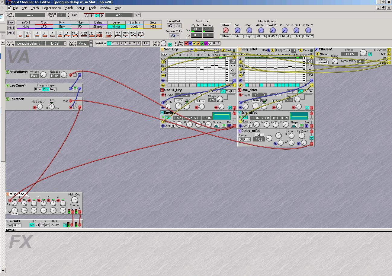

How can I create a ducking delay (or reverb) with my G2 ? I supose that I have to use the Env Folower. I know that I can use an "audio in" signal or a osc as a trigger... Thank you for your help.

If you run your env follower into a LevConv, set to Pos input and PosInv output, that should give you an inverse control signal (your ducking bit). Run your delay output signal through a LevMod and route your ducking signal into the Mod input. Setting the amount dial between 0 and AM should allow you to control the amount of ducking required, obviously you'll need to get your settings right on your Env Follower as well.
If your using a stereo delay, make two LevMods, one delay fed to each, set the amount of modulation to 0, wire a unipolar constant module to both of the mod depth inputs and raise the mod depth dial halfway. Now the constant dial controls the depth of the ducking. Obviously you'll also need to wire your inverted env follower signal to both mod inputs as before.

Ok tell me if I'm right please. Look my patch. The 2 signals are from 2 OSC. I added a cold penguin melody in the exemple for you Tim!...

The ducking bit looks right to me, only looking at the picture tho as at work again. Smile You could of course take the signal from the osc that is going through the delay, before it goes through the delay of course, if you wanted as opposed to having two completely seperate signal paths.
As said above a compressor side chain input would also work, though may be more costly processor wise. Or as Dasz says just use an inverse positive envelope triggered by the same gate that triggers the note on of the synth sound, to duck the delay, rather than using an env follower. There are probably many more ways of doing this too. Very Happy

Can I have to use a ducking filter (HP or LP) to bypass completely the sound? Because even playing on the parameters, I still hear the sound very low. Another solution is to use a "SignalToMIDI" and dropdown the volume from the sound with a MIDI #cc?
Is it normal that when my audio signal is too strong, the ducking effect is not working? The sound is not attenuated.
