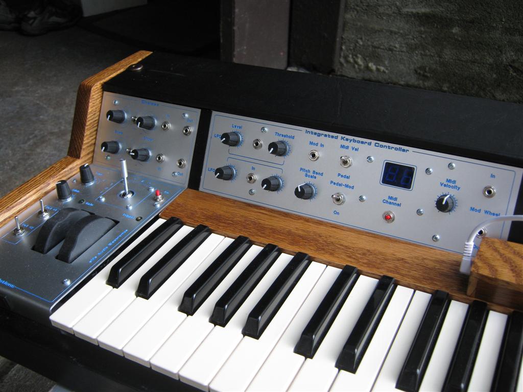

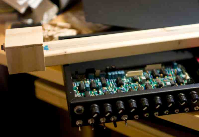

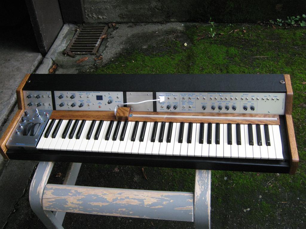

Here's some pics of my over the top controller, finally finished. Based on an IKC keyboard controller, it also has a Choices joystick controller from Flight of Harmony, and the Appendage Ribbon Controller. The ribbon is detachable from the keyboard. The IKC controls are spread over 3 panels, with the outputs and the Choices manual gate/trigger jacks on a rear panel. All three sections are fully operational, and the wheels also are working. The smallcenter panel is blank for the time being. The only thing that bugs me at the moment is the clunky ribbon connector housing, but that can wait 'cause I'm having fun with the Appendage.
Flight of Harmony
http://www.flightofharmony.com/
Pittch Bend circuit
http://www.electro-music.com/forum/viewtopic.php?highlight=pitch+bend+circuit&t=34895
IKC Keyboard Controller
http://www.electro-music.com/forum/viewtopic.php?highlight=ikc&t=29746
George

PostPosted: Sat Sep 18, 2010 5:21 pm    Post subject: Reply with quote  Mark this post and the followings unread
thats exactly the keyboard i had in my head for mine. with softpot slightly to the right. beautiful job man. Very Happy Very Happy

PostPosted: Sat Sep 18, 2010 7:34 pm    Post subject: Reply with quote  Mark this post and the followings unread
Hey Slo!
AWESOME job on this! I have my IKC board about 80% loaded, and have been seriously vexed about how to package my keyboard up. you have given me some real inspiration! Your inclusion of the Appendage is a great idea! I have a 500mm and a 1000mm softpot, I will have to figure out which one to use. Nice to see that you put yours together with a 5 octave keybed. I have a korg poly61 that I got for 10 bucks because I wanted the 6 SSM2056 EG chips, now I know what to do with the keyboard too!
Thanks for posting these pics!

PostPosted: Sat Sep 18, 2010 9:00 pm    Post subject: Reply with quote  Mark this post and the followings unread
Thanks for the kudo's. A nice side benefit with having the 500mm ribbon above the keys is that with a little Appendage knob twiddling you can get close to a chromatic scale using the keys as guides.

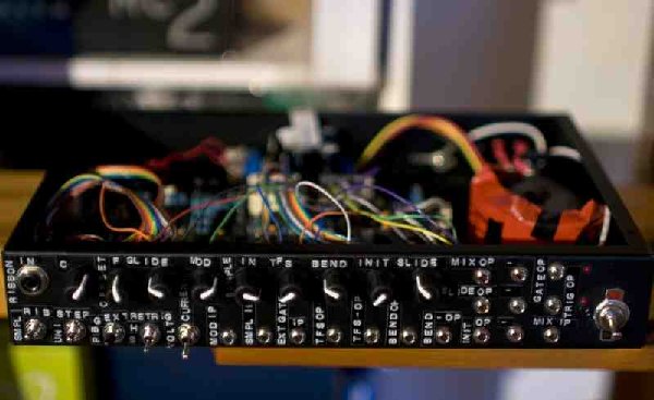

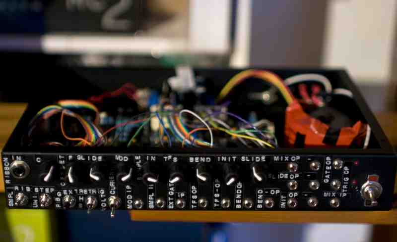

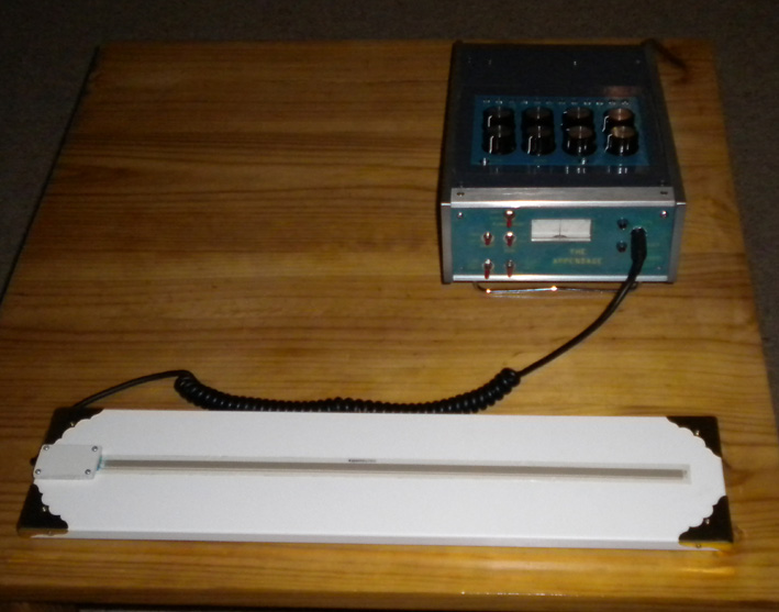

PostPosted: Tue Sep 28, 2010 2:18 am    Post subject: Reply with quote  Mark this post and the followings unread
Took longer than expected but so far seems to be quite the 'tool' Smile
awesome manual guys, Well Done!!
The case is some recycled lab gear, voltmeter works but currently not hooked up to anything, guess it will be used for the 'mixed' output, tho offset may be more useful.

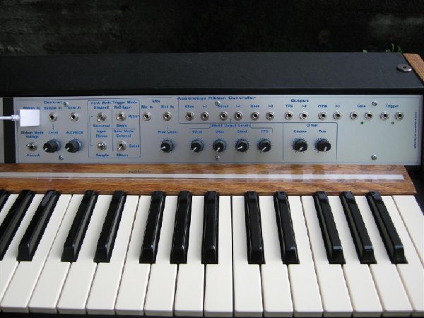

PostPosted: Wed Oct 13, 2010 2:59 pm    Post subject: Reply with quote  Mark this post and the followings unread

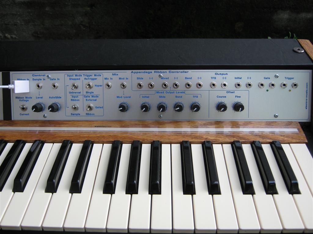

I have, at long last, finally finished my Appendage build - though I haven't calibrated it yet.
It was a pretty massive project, and one of the most complex I have attempted thus far. The build was easy. Scott and Bill did a terrific job putting this project together and Scott's manual was clear and easy to follow.
As you can see, I built mine in the Synthesizers.com format, and crammed the lot behind a four-space panel, which I screen-printed myself. It only barely fits and it took some juggling to get all of the panel hardware to fit. I almost opted for smaller knobs. I didn't have any of the Moog style knobs I usually use for my modules on hand, so I used some Rat Shack knobs we had lying around. I'll probably replace those. Though you can't see it in this pic, I mounted the PCB parallel to the front panel on some kludged standoffs. It is almost exactly the same length as the Dotcom panel is wide, so it was a close fit.
The ribbon itself is housed in a Walking Stick enclosure (those things are beautiful). I routed out the space for the jack and wiring with a dremel and then filled the two knob holes with wooden plugs, stained to match the rest. There is a textured covering over the Softpot itself, like the stuff used on a Micromoog ribbon. I got that from ribboncontrollers.com, too. I owe my thanks to them and to both Scott and Bill for making this project happen!
Next up: The Klee (assuming I survive the calibration of the Appendage!) Shocked

PostPosted: Wed Oct 13, 2010 6:57 pm    Post subject: Reply with quote  Mark this post and the followings unread
thats what i'm looking for is a protective covering for the softpot. lovely stick and build man. Very Happy Very Happy

PostPosted: Wed Oct 13, 2010 7:21 pm    Post subject: Reply with quote  Mark this post and the followings unread
Thanks... I take no credit for the stick itself. That came from http://www.psionicsoundworks.com/. I just took a Dremel to it to make it work with the Appendage...
The covering works very well. It seems not to hinder the Softpot's performance at all.
I'm on step 4 of the calibration process at this very moment. I've enlisted my 14-year-old son to help (he's smarter about electronics than I'll ever be).

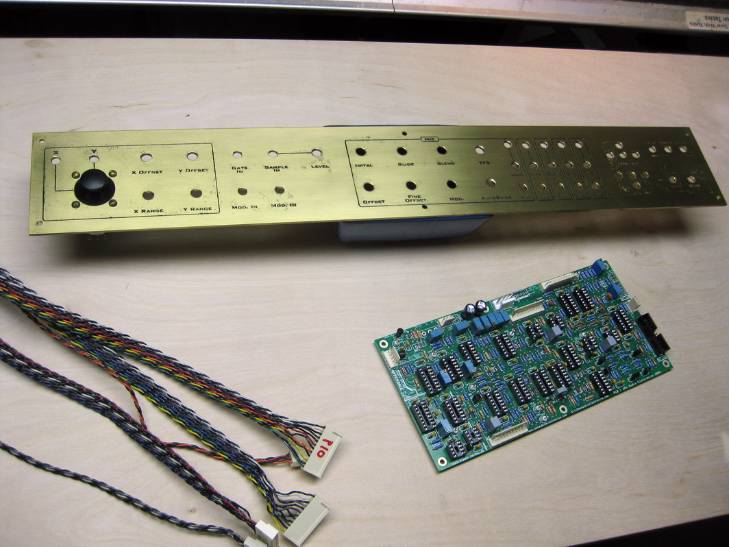

I finally made some headway on my Appendage. The board has been populated for months, but the panel was the hold up. I had to build a custom tank for the panel etching (the panel is 21" x 3.25"). The etch came out a little grungier than usual but overall I'm very pleased. I've also incorporated a joystick, using 2 CGS mixer boards. I'll post more photos soon. This will be the centerpiece of the new controller cabinet that I'm building.

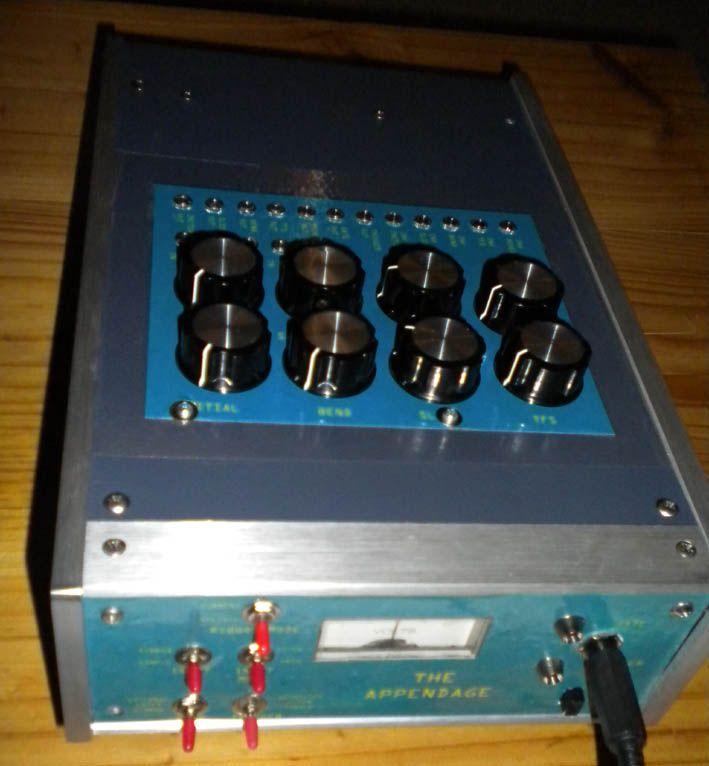

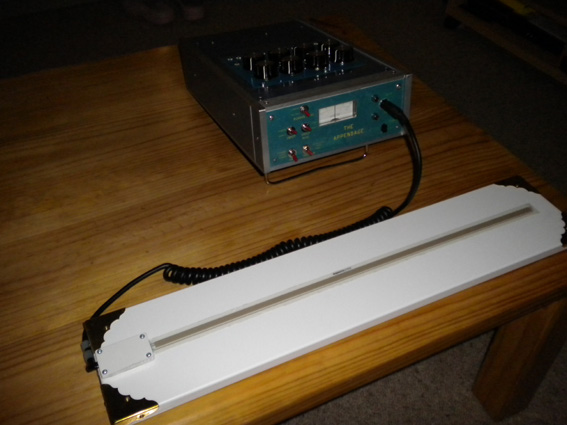

PostPosted: Tue Dec 07, 2010 8:45 am    Post subject:   Reply with quote  Mark this post and the followings unread
I just finished calibrating my Appendage, so I have now put the cover on the Appendage's case. Smile
I even managed to play something with it already, so it's safe to say it beats my doepfer ribbon controller 5-0.
It has got everything I need in a ribbon controller and then some extra. love
I have to thank Scott Stites once again for the absolutely awesome, excellent build instructions and for the whole project of course! salut
Additional thanks go to Bill from Sms electronics for the great pcb layout and the parts set!
All parts were there and having a kit made it almost too easy to put this thing together. thumleft
The ribbon controller will probably be painted as soon as I decide the right color :)
