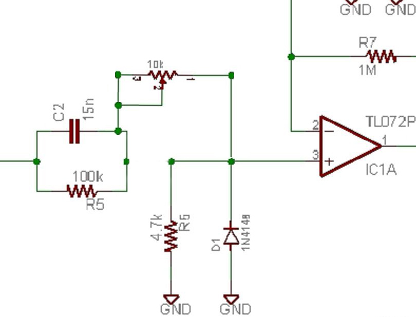

I believe I have found the solution for the click on the bass drum. I have yet to test it, but I wanted to let you know, minus, because you were redoing the stripboard layout...
The click section of the circuit is, if you reference Eric Archer's schematic, the lower section with the parallel cap and resistor, then resistor and diode to ground, going into the positive input of IC1A.
If you put a 1K or 2K trimmer between the two parallel pieces and the 4.7k resistor (instead of a wire) wired as a variable resistor, you can adjust the click response. I have tested by grounding that point, and found that the click pretty much went away. I simulated the circuit and it looks like a 2k there reduces the current spike there enough to be negligible, while leaving a reasonable range of adjustment. I only have a 1k trimmer though, so I'm going to try that later.
I was thinking though that if you could arrange the stripboard so that you could optionally put a trimmer there or a wire, you could let the builder choose between "original" layout and being able to adjust the click. In fact, if I were to wire it to a panel pot I could make it directly adjustable as well... though I'm not sure you can get panel pots down to 1k / 2k, a 5K would probably work as well, just not have as much useful adjustment range.

Posted this over at Muff's today -
I found that the click sound changes considerably depending on the trigger input conditioning circuit. Try using a 33nF or 47nF instead of the 100nF after the rectifying diode. I haven't actually measured the resulting trigger width, but to my ears the click sounds a lot better and less prominent...
PostPosted: Fri Sep 21, 2012 2:58 pm    Post subject: Reply with quote  Mark this post and the followings unread
I'm triggering with the original method (1ms pulse from a CPU in my case an Arduino) so the conditioning doesn't help me any, but that's a good find for people who aren't as insane as I am Smile
BTW I found that 1K/2K really made very little difference in the actual circuit. A 10K pot does a reasonable job, but seems to affect overall tone some too.

Are you trying to get rid of the click altogether? Afaik it's a feature of the 808 bass drum. My concern was that the click didn't sound right with a too wide trigger pulse, as in 1nF = floppy and 33nF = tight.
PostPosted: Fri Sep 21, 2012 3:49 pm    Post subject: Reply with quote  Mark this post and the followings unread
Definitely don't want it gone, there needs to be some impact tone. But my build at least it seems a lot louder than it ought to. Since I've never had an 808 to actually hear what the original sounds like it may just be me Smile

I think the click does appear to be too loud, to me anyway. Without the click it will lose its punch. However, it would be nice to knock it down a little, or have a pot to control the click if you wanted that feature. I used to like a huge decaying boom, but of late I'm preferring a short solid thump. A sign of getting old perhaps?
I think we can agree the click is an issue we are all coming up against. If we can work out a solution, I'll draw up the stripboard diagrams and post here. I should have a go at the other voices soon. I like that retro hand clap!

Try putting a 10K or 15K pot there on yours, minus and see what you think. I'm pretty happy with the 10k overall, though it's a balancing act between that and tone to not lose the 'crisp' attack.
Here's the mod as proposed. (forgiveness for the awkward placement, basically built it out of cut & paste of other parts of the original image)

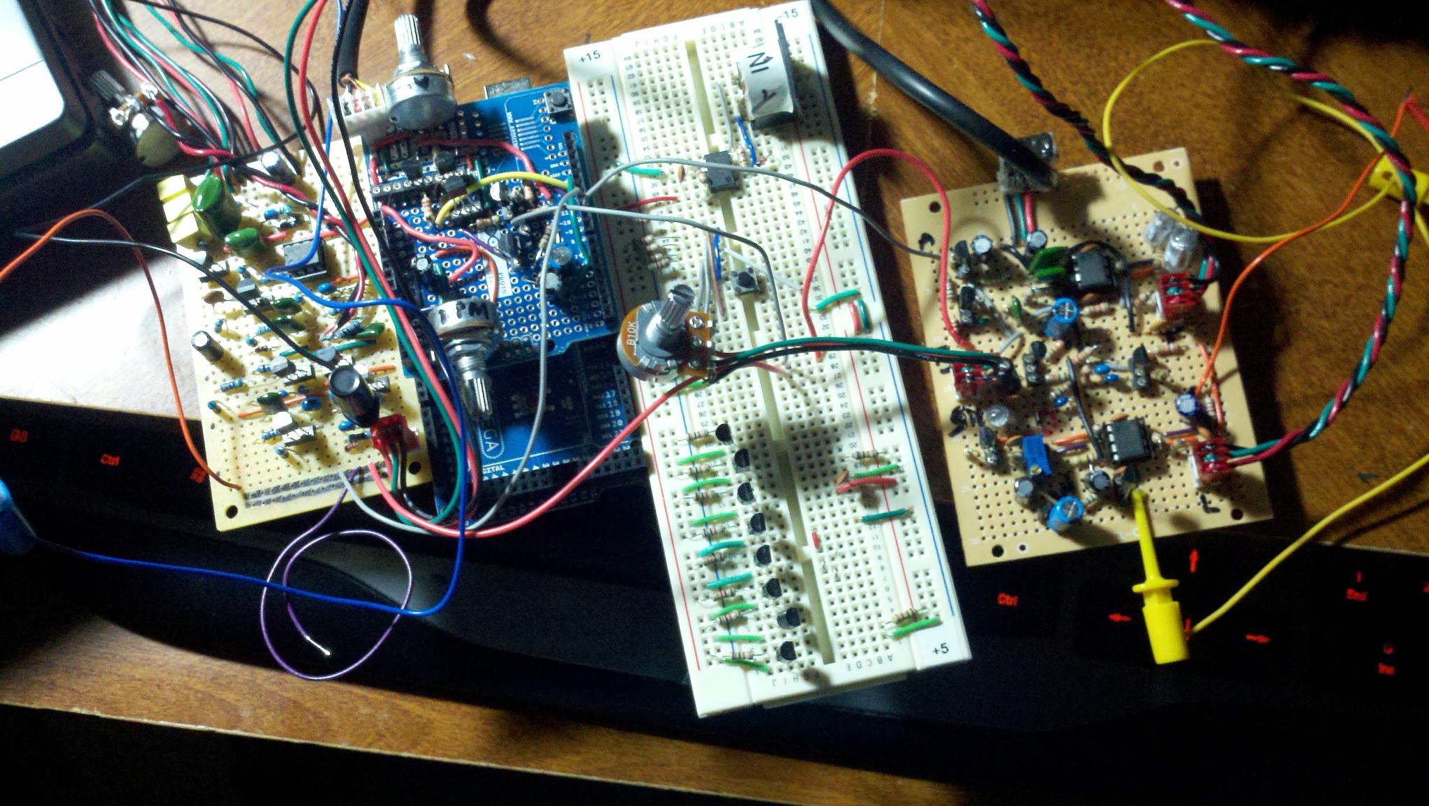

Playing around with a more complex sequence coming out of the Arduino, I found that it sounded interesting if I jumped the input level of the bass drum alternately to over drive it...
Might be an artifact of the battery based 4 input mixer too, but I like it.
