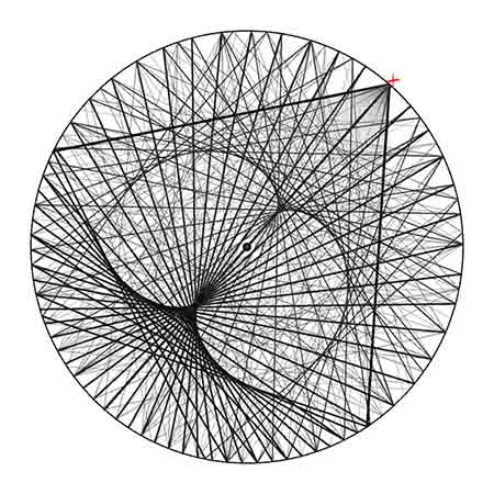

Description: |
Figure 8. One and two reflections from a (75 degree) speaker |
Filesize: |
59.09 KB |
Viewed: |
7057 Time(s) |
Description: |
Figure 9. Six reflections from a speaker |
Filesize: |
73.33 KB |
Viewed: |
7057 Time(s) |

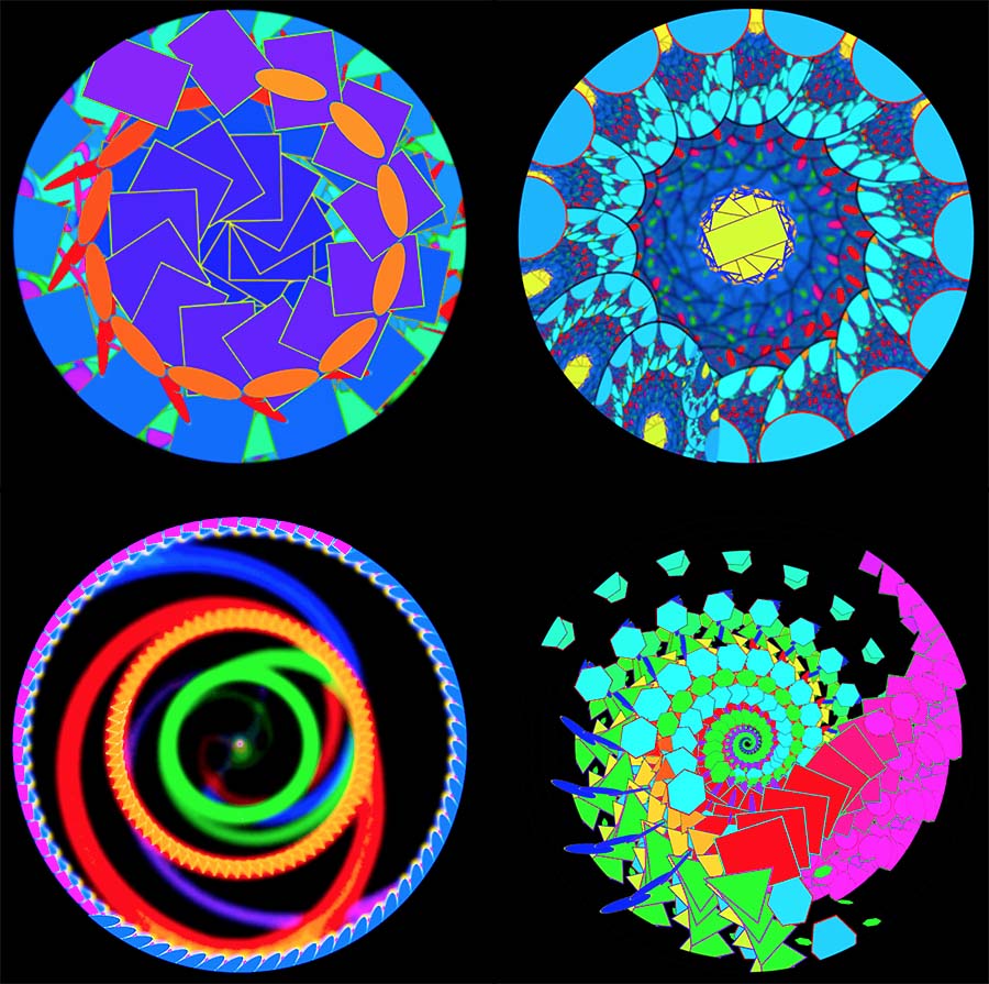

Description: |
Figure 13. Two demo runs of dome painting |
Filesize: |
187.04 KB |
Viewed: |
654 Time(s) |
