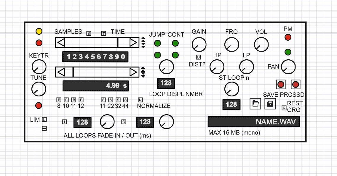

Here is some idea of new module for wren.
Everything should be self explanatory except modulation inputs.
CONT JUMP plays loops in sequence one after another every loop from start to finish to the loop number of modulation value and then looping that loop.
JUMP going to the next loop pointed by modulation Immediately after end of playing loop. LOOP START is the first loop that will play after trigger.
Micro fade in and out of every loop,Normalize,Bit reduction and resampling should be destructive option i suppose but there is a button to recover original WAV.
Max size of file 16 MB and mono so file should be truncated and maybe one more button for left right channel select.
Attached little fast mockup of this what i thinking of.
MAX 128 loop points.
More extra i can think of is modulation input of reversing direction of loop but i dont know is it not complicated to much already ?

I forgot about one pretty important function with this thingie. Setting handy for transwaves wav files. After loading wav file some little window to set initial loop lenghts precise in samples and number of loops. In this way we dont need to set every loop manualy. I must redraw it a little.
