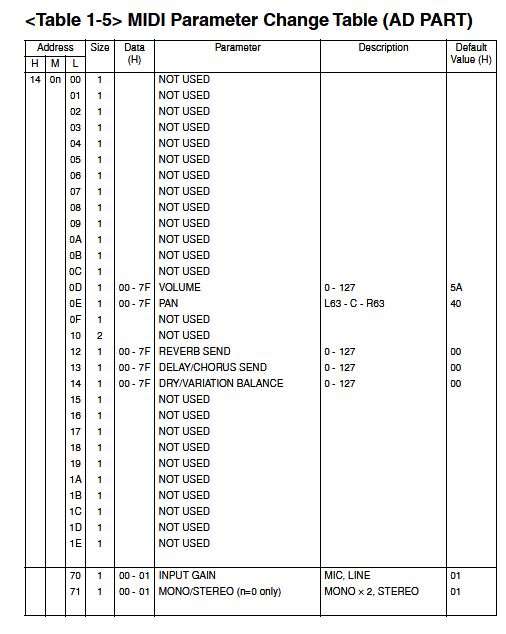

Yamaha RS7000's audioins have sends to internal FX-busses.
I plug NMK into them & need 2 control this sends via MIDI in live situation, because RS7000 wan't provide assigning separate control of that parameters from it's own controlpanel. But that's not just CC# (in such case my tasc would be fairy EZ) In attachment is info on this from RS7000 manual. Is it NRPM? Or SysEX? May be it's possible to path my task in NMK editor & how to do it, please?
Hard to tell from the context you provided ... either way you're out of luck as the NM Classic can send straight on CC messages only. (it would be near imposible to make (N)RPN (which is CC based) work as it will have to be made by turning knobs very very precisely).
