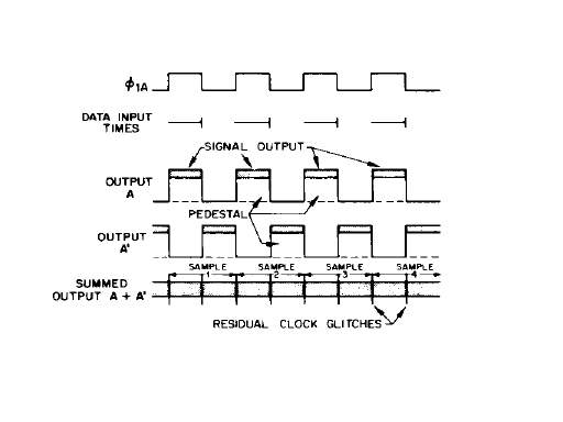

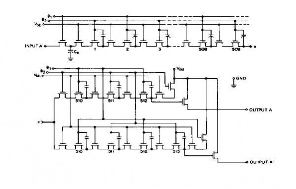

There are two outputs because the buckets alternate between empty and full. If you just took the output of one string of buckets, your signal would be 'empty' half of the time. So, the second output puts out the same level that the first output had once the first output goes low and is getting ready to be filled again with the next sample.
I've attached a couple of illustrations from the SAD1024 data sheet to illustrate. The SAD1024 is a different model of BBD, but they're all functionally the same. Inside_bbd shows that the A' output (the "second" output) has an extra little stage there to feed the signal out when A (the first output) is empty. That way, you get a more-or-less constant output of the BBD.
BBD_output.jpg illustrates what the signal looks like on the respective outputs. The MN30XX datasheets rarely show them (they usually show fixed resistors), but a good idea is to put the outputs to each side of a trimpot and the center tap of the trimpot is the output to feed to the rest of your circuit. This allows one to null the clock signal as best as possible, rather than relying on the linearity of the device and fixed resistors. The MN320X datasheets invariably show this trimmer.
As an aside, the SAD1024 was a dual 512 stage device (like the MN3010) so that made it easy to set it up for parallel multiplex of two different BBD devices (in this case, both devices are in one package). This technique switches the clock signals around from one device to the next, and then it just mixes the same phase output of each device together. This allows the signal to change with each clock pulse, rather than spitting out a copy of the first output on the second output. This doubles the sample rate and allows double the resolution for the same delay time, or doubles the delay for the same sample rate. Using it to double the resolution of the same delay time doubles the Nyquist frequency, and, one assumes, would make one hell of a nice flanger setup.
I recommend the SAD1024 datasheet as a good source of BBD theory. You can get it here:

there are 2 clock feeds because these are in opposite phase because in the BBD every other bucket is empty at any one time, ready to be 'filled' be its neighbor. This is also why the equation for the delay time has a /2 in it
