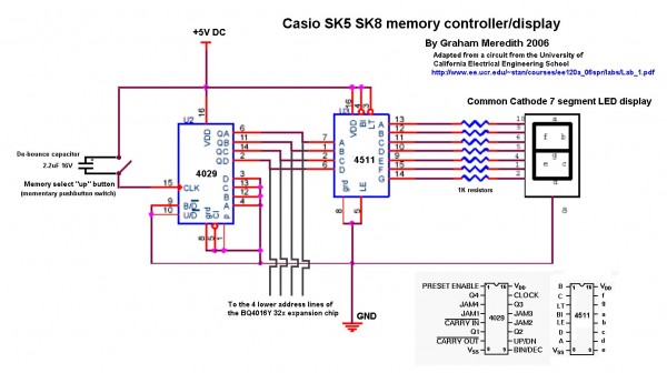

Hi all,
I've just completed a digital readout for my 32x memory expanded Casio SK8. It's only a prototype, and it needs to be prettied up, but it's fully working and behaving properly.
It's a 2 digit LED display, to display the 32 banks of expanded memory I just did. The memory is arranged as 2 banks of 16 memories.
The first digit (the small one) displays the bank (1 or 2), the 2nd larger digit displays the 16 memories in each bank (0-15, as 0-9 then a-b-c-d-e-f for the rest).
The 2 banks are switched between using a simple toggle switch to switch on/off the highest bit address line of the RAM chip. This switch also connects power to the 1st digit's segments to form either a "1", or a "2". Simple!
The 16 memories in each bank are accessed using a push button that scrolls through each memory. This is driven by a 4029 cmos binary counter IC, switching the other 4 address lines of the RAM chip, which also drives a 4511 BCD-to-7 Segment Latch/Decoder/Driver for the readout (at this stage I couldn't get hold of a binary decoder driver quickly, so I used the 4511 I had lying around for the moment, and it only displays memories 0-9, the last 6 memories are not displayed - they will be when I get the binary decoder driver).
The momentary push button switch is used to pulse the 4029 counter through the memories. A 2.2uF 16v electrolytic capacitor wired across the button terminals acts as an effective switch debouncer.

Just thought I'd upload the schematic for my display. As I've mentioned before, this circuit could be used to control anything, not just a RAM chip. It could be used to switch a bank of resistors or capacitors for "presets" in a VCA or VCF circuit, or anything!
Here is where I originally got the basic idea:
http://www.ee.ucr.edu/~stan/courses/ee120a_06spr/labs/Lab_1.pdf
Cheers, Graham
