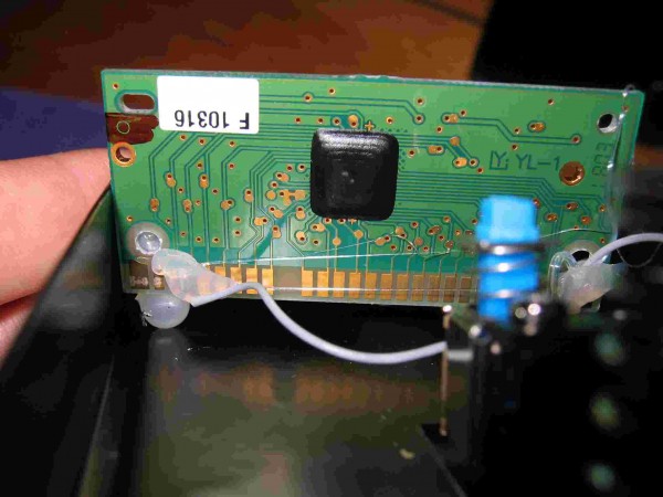

...no datasheets, but in this particular kbd ("cherry", which seems to be a very high quality kbd made in germany), it is easy to take apart (no screws, each key is individually mounted so they don't fall all over the floor), and has wide unmasked header contacts so it's easy to solder to (not true of every kbd).
i was able to remove the encoder board (2 torx screws), and then i used a pair of visegrips to hold the key i needed to emulate down. i was then able to use an ohm meter to find which of the 2 pins on the header were shorted together (it's worth noting here that on my fancy meter there was too much resistance in the kbd to trigger the continuty "beep").
also, using a dpdt switch (the footswitch i'm using has one inside, even though it only uses one pole), you could send key combinations (ctr v or anything else). what is most suprising is that the kbd protocall doesn't seem to be straightforward (at least the things i read made it seem that generating kbd data from a pic or basic stamp isn't as easy as one would think), and that i couldn't find cheap kbd encoders without buying a kbd. the programable encoders available (i think mostly for the casino gaming industry) are nice, but at more than 10 times the price of a kbd from all electronics (7.50), they are prohibative unless one thinks they will want differant keystrokes in the future.
mostly, i like the idea of not having to load any software (other than standard windows usb kbd drivers that load automatically without needing to go out to the net), and the high profit margin Smile
this is as easy a diy project as you will find (especially since i found the kbd with the easy to solder to encoder), and could have all kinds of uses for anyone that does any kind of repetitive computer work.

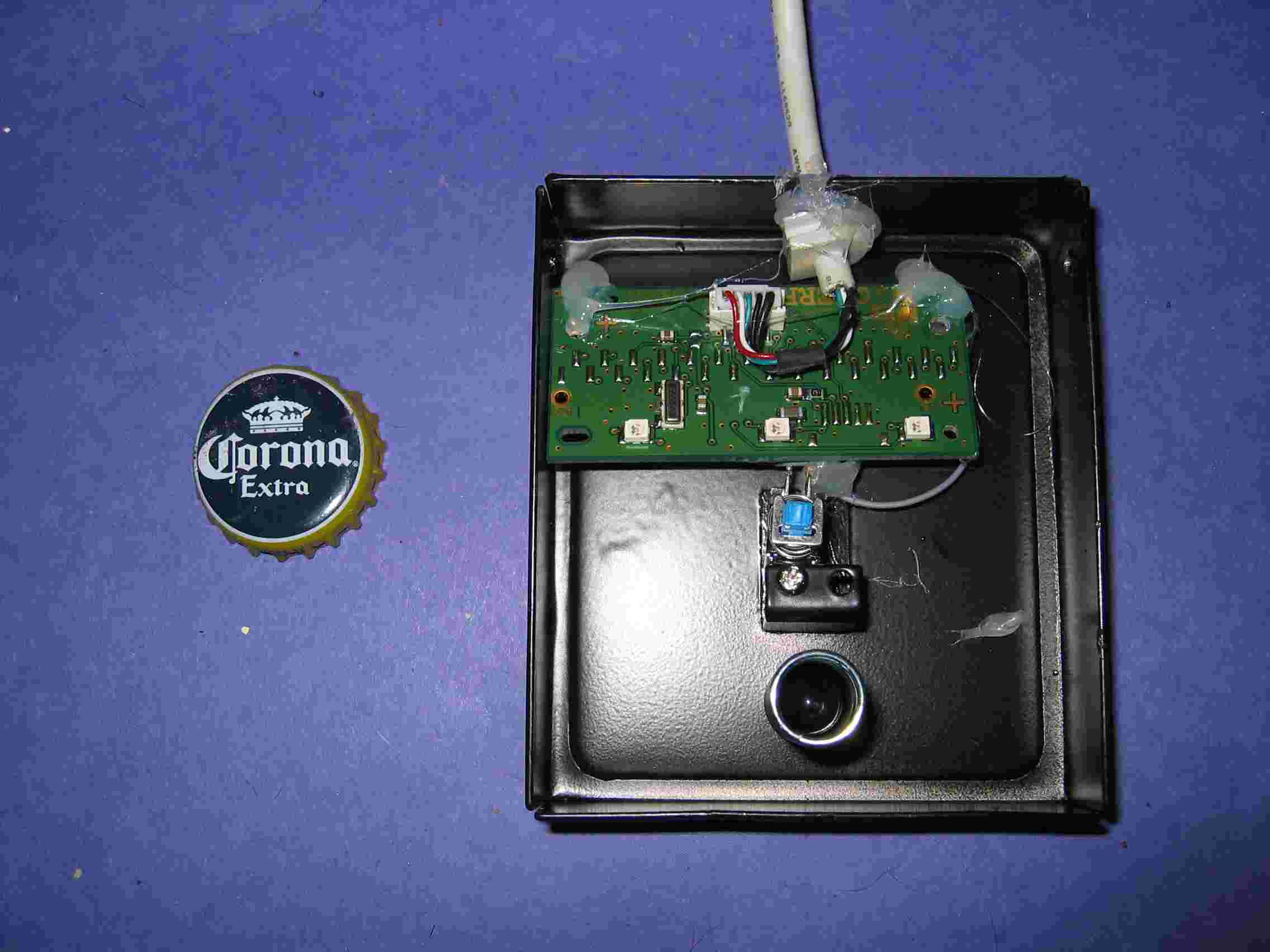

...this particular encoder is very small (2 5/8 x 1 3/8 in inches)....yet has big solder pads.
as far as hospital requirements, i'm not interfacing with mri machines or anything, just with pc's being used for speech recognition/documentation. hospital it departments are picky about stuff, which is why i didn't want to use any of the off the shelf solutions that require custom drivers...i can convince anyone that this is litterally a kbd, and if there are objections, i can always use a kbd supplied by the it dept. it does need to look like a real device (and not made of plywood).

...the encoder board attaches directly to the matrix traces that get connected by pressing keys. i have a feeling that the diodes are built into the encoder (either on the board, or on the chip). here are some pics...i used a bottle cap for size referance, as i figured you would be more familliar with that than a us quarter beer
Apreceated. I nominate this for the "EM international picture reference standard", CD's would also be good. I think there should still be some US quarters around here but I have no idea where those might've gone....
Anyway, I suspect the diode may need to be in the short itself, meaning that all shorted conection have their own diode but I'm realy not sure; that's just the impression I got.
