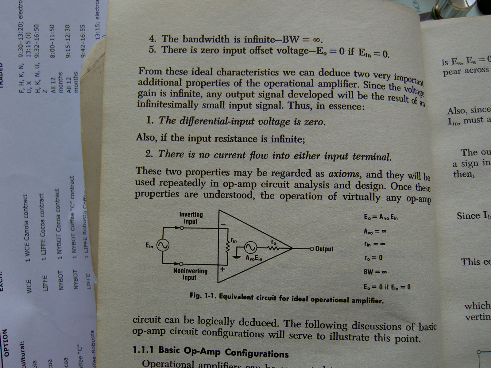

piedwagtail
Joined: Apr 15, 2006
Posts: 297
Location: shoreditch
PostPosted: Thu Aug 31, 2006 3:46 am    Post subject: Reply with quote  Mark this post and the followings unread
A fine book to try and get secondhand is
the IC Opamp Cookbook by Walt Jung.
Full of schematics and with definitive discussions of opamps,OTAs and current differencing amplifiers ie.the venerable LM3900 of arp filters and serge waveshapers.
'Under the hood' is a red herring only chip designers need to know that,opamps are often extremely complex but all try to obtain the ideal blackbox.
Here's the first two pagesupsidedown(1974 er .....copyright)which set out the ideal blackbox assumptions.
(Note on one side we have an original T.Henry publication...3080 book which is the ultra description of OTA mechanics including his discussion of absolute room temperature,this is available from magicsmoke?
And on the other some details of Cocoa futures traded in Lasalle st Chicago..... Smile )
