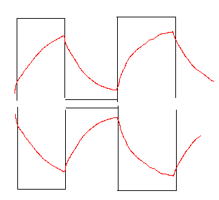

PostPosted: Thu Sep 07, 2006 2:57 pm    Post subject: Reply with quote  Mark this post and the followings unread
hmm that stuff is way overkill! the simplest [and it is simple] way for you to get a 'perfect' triangular wave is with a closed-loop integrator/comparator which can be made a coupla ways...
one is a dual op-amp with just 3 resistors and a cap [well, + biasing components in a single supply] and then, i assume you want that frequency variable, so you'd use a pot too.
a 'non-perfect' triangular wave can be derived from just one op-amp multivibrator, this means that, you could basically have your LFO, inverter, and two VCAs built off of 1 quad op-amp package, if you have a dual supply.. i dont know how well the VCA circuits would work off a singlesupply. i could proto it though.
in fact, this 'nonperfect' triwave might be very good for slow AM, as it is exponential as are our ears. here i have drawn a picture of it, which is exaggerated a bit. you would have to buffer it if taken directly off the cap, then your other control is it's inversion, so its already buffered.
my suggestion is: look at guitar effects schematics! anything with a LFO. a tremolo, vibrato, chorus, phaser, etc.

PostPosted: Thu Sep 07, 2006 3:43 pm    Post subject: Reply with quote  Mark this post and the followings unread
You're right. And here right after I get through saying to keep it simple I go and introduce something incredibly complicated.
Yeah... keep it simple and avoid frustration. Simple circuits are much more fun anyway. It's great to be amazed by a small circuit doing something wonderful.

Posts: 1471
PostPosted: Thu Sep 07, 2006 5:50 pm    Post subject: Reply with quote  Mark this post and the followings unread
Yes Topp, great way to tackle it.... plus, if you vary the duty cycle on the square wave you would also vary the shape of the triangle wave, too.
