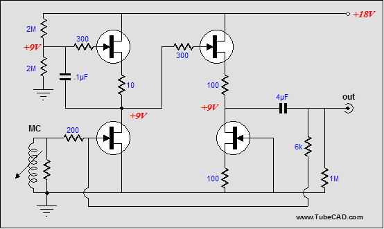

I'm currently finishing a tube/valve preamp of this topology and in the initial test it was frighteningly quiet for a tube microphone amp,my voice came out of the darkness.
In its many topographic versions,the main element is the injection of the power supply noise antiphase into the circuit such that it is cancelled out.(See 2M/2M ladder in schematic)
See John Broskie's TubeCad.com for background information.
Tube electronics is a bit like tree surgery compared with the gardening of +/-15V,but
I built a fet version of this topology and it is also unbelieveably quiet.It provides perfect quiet gain for my ribbon mic.
I used 2N3819,unmatched,with an input transformer with a input attenuating pot.
Play with the 6K feedback resistor for overall gain.Can't see any problem with supply from 9-24V apart from headroom,stick a cap on the front if you don't use a transformer to decouple any dc.
If you need a gain stage give it a try.
Robert

I'm interested in your fet version of the circuit, as I'd like to make a preamp for field recording and this technique sounds promising when using fets/mosfets.. If you have any other info about your experience, schematics, or other, please share! (what gain levels can you get cleanly (0 - 60db?)?) Are you using dynamic mics, or have you modified from this schematic to add phantom or other power for condensers?

I used the schematic above,run from a wallwart dc supply of 12V.Input transformer 600-50k balanced to unbalanced Sowter 9045,run into a100k pot.Rest as shown,i believe i upped the feedback resistor a fair bit,try out various values to suit on gain vs linearity.
My RCA varicoustic ribbon is a devourer of mic gain but this handles it easily.It's normally a balance between adequate gain and infringing noise on a desk with this mic.Gain is mainly from the first bottom jfet,so perhaps a socket in this position,as they can vary .
I don't have any 48V mics,only a tube mic with its own supply.48 V would be added to hot/cold in front of some dc decoupling caps in front of the transformer.The quality of the caps is important as their signature is messing with a small signal.,
I really recommend it,it's an easy build and it is quiet beyond belief.
Robert
