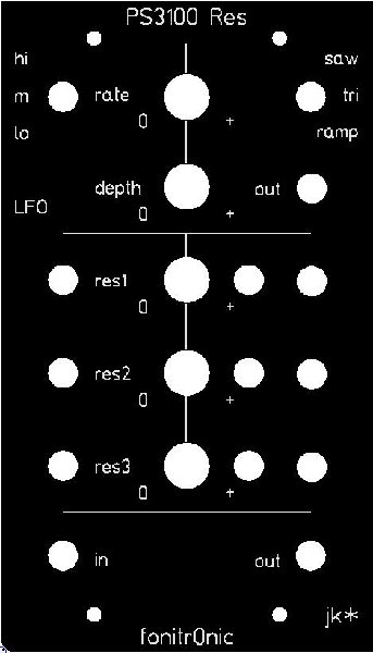

Still getting around to a few modules I never completed/sourced parts for. This is a FRAC panel for the original PS3100 (no double trouble here). .FPD available.
FRAC panel design for ps3100 resonator module.

PostPosted: Sun May 15, 2011 1:19 am    Post subject: Reply with quote  Mark this post and the followings unread
Hi all,
I'm drawing a euro panel like this black one on top.
Is it possible to wire the J8 (R1-3 out / v3 PCB) direct to the jack sockets?
PostPosted: Sun May 15, 2011 2:44 pm    Post subject: Reply with quote  Mark this post and the followings unread
sure. just put min 200R in line to give the opamps some protection.

PostPosted: Tue May 17, 2011 2:58 am    Post subject: Reply with quote  Mark this post and the followings unread
furio wrote:
...Is it possible to wire the J8 (R1-3 out / v3 PCB) direct to the jack sockets?
Or use the spare op-amp on the pcb and a little piece of veroboards with another tl072 to buffer the single-outputs. That`s what I did,works like a charm... Wink
