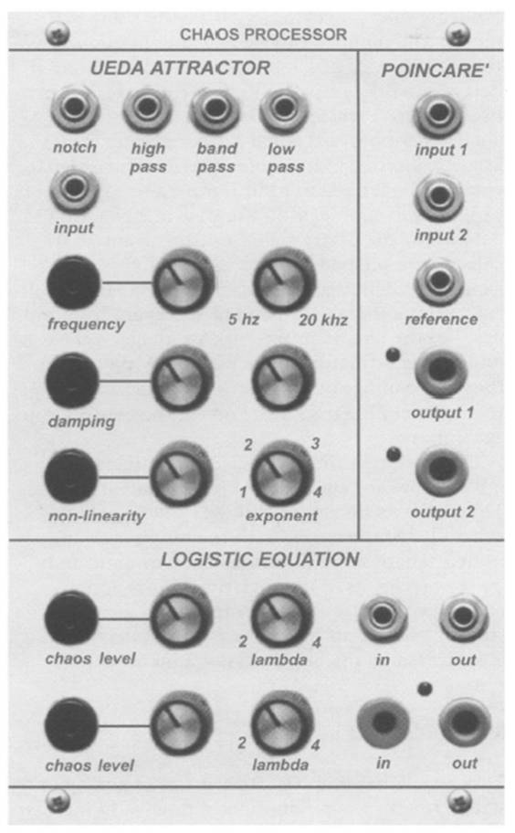

PostPosted: Sun Dec 30, 2007 5:04 am    Post subject: Reply with quote  Mark this post and the followings unread
Ever seen this one before? Wink Razz
 Filesize:  47.71 KB
 Viewed:  497 Time(s)
frijitz
Joined: May 04, 2007
Posts: 1734
Location: NM USA
Audio files: 54
PostPosted: Sun Dec 30, 2007 10:03 am    Post subject: Reply with quote  Mark this post and the followings unread
Sure. Laughing
Is there a board available?
IIRC there's actually a dozen or so Moog modules behind that panel, na?
Ian

That looks sorta like a Buchla style panel. What gives, Andrew?

But, I digress - izzit a Buchla thing I've never heard of before?

Smile it is sadly just an artist`s impression of Buchla 200 series Chaos module, never produced (check the mismatched banana jacks in the BtmRt corner)

Thanks to you there are some boards available.
guess I should be more forthcoming - The panel is from an article by Dan Slater called `Chaotic Sound Synthesis`. Dan discusses chaos patches and circuits set up on Buchla and Moog modulars and an analogue computer.
His description of the Ueda attractor is especially interesting. The proposed module can be used as a state variable filter, a quadrature oscillator and an Ueda attractor - it could be (in theory) voltage-controlled to switch/morph between the 3 states.
It is a bit like which came first, the circuit or the panel? in this case its the panel.
I got my copy of this article off JSTOR, so am unable to post a link to it. It used to be online on Dan Slater`s homepage, but that has gone now.

Thanks to the Internet Archive, here's most of the article (minus one image) Very Happy
http://web.archive.org/web/20020823081114/http://www.nearfield.com/~dan/Music/chaos/Chaosrel.htm

Thanks chriswilliams
strangely that missing image doesn`t appear in my copy of the article either (mine is from Computer Music Journal).
Anyway it is a good read.
