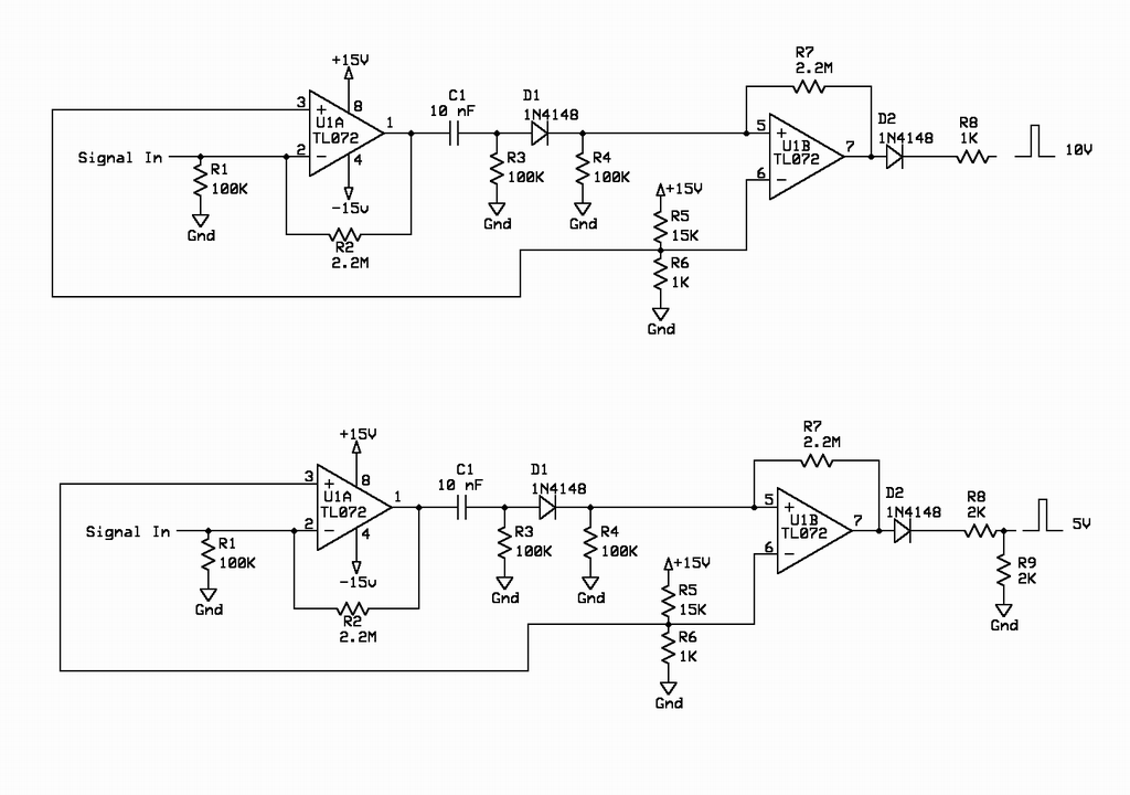

The end of cycle thing was something I worked out with a dual TL072 - the first stage is a comparator and the second stage differentiates the output into a pulse and squares it up - something along those lines IIRC.
The comparator is set to go high when the voltage drops below a certain level (I can't remember off-hand the reference voltage I finally chose - close to the bottom of the EG's output). It would have been really great if I would have had room to put a reference level pot - that would have been really nice, but it works pretty good as it stands. I put three of them in my triple EG module (one for each EG). You can do all kinds of things - you can chain the EGs together with them, or you can use it as a sort of delayed trigger, or (as in the sample) turn an EG into a cool little LFO. I'll see if I can dig up the schematic and post it.

I'll dig up the schematic for the EOC trigger I put into my EGs.

I found my notes concerning the EOC trigger - I used a TL072, sure enough. It's fairly crude, but works like a bat out of hell on my Ray Wilson EGs.
The first section is a comparator with a reference to the positive input and the signal going into the negative input - it uses a 2.2M resistor for some 'snap'. So, while the EG is low, its output is high, but blocked by the 10n mylar cap. I breadboarded it today again just to make sure my notes were correct.
As soon as the EG goes above the reference, the output of the first comparator (U1A) goes low and produces a negative going spike through the cap, which is blocked by the diode. When the EG falls back below the reference, the comparator snaps high, producing a positive pulse through the cap, which the diode passes. The other section of the TL072 (U1B) is configured as a comparator with a 1V reference to the negative input, and a 2.2M resistor for hysterisis. When it sees that positive pulse come through to its positive input, it snaps high then low - it's there to turn the sloppy capacitor pulse into a crisper pulse wave and to prevent any loading on the output of the first comparator.
I've got two configurations illustrated here - they differ in only the output resistors - the top one uses a 1K resistor for output impedance. It delivers right around 10V - the TL072 doesn't top out at the rail, and there's the diode gap there, and it just happens to get to around 10V.
The bottom illustration has a 2K/2K divider, so it cuts the voltage in half - the output is a 5V trigger. The 2K/2K divider gives this version a 1K output impedance as well.
The 15K/1K voltage divider renders a 1V reference - this is fine for my Ray Wilson EGs that provide a pretty stiff (better than 10V) EG signal. The EG hasn't quite fallen all the way before it gets triggered again - that seems to work out pretty the best for this application. If you have 5V envelopes, you might want to consider reducing the 1K resistor to catch more of the EG signal before it's retriggered. In fact, a separate voltage divider using the 15K/reduced-from-1K value for the first comparator reference may be in order. This will keep the same reference voltage for the second comparator, which doesn't care if they're five or ten volt envelopes.
